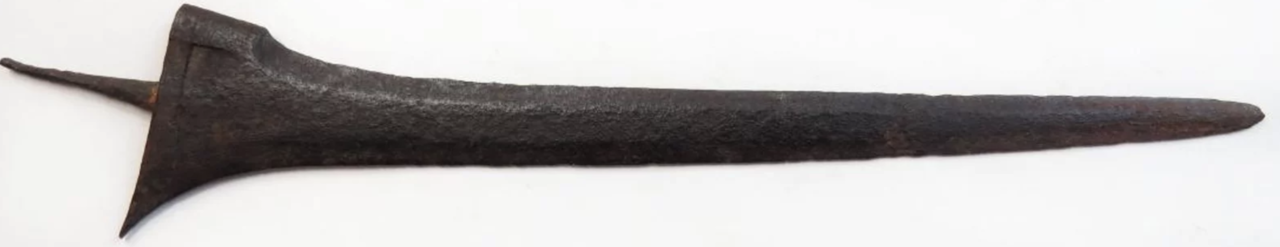

I'm interested in acquiring this keris from an auction with a view to clean and restore it. I'd be curious to see how clean I can get it and what lies beneath. I like to think I learned enough lessons from the last time I cleaned an old blade (the hard way ) to give this proper treatment.
However the extent of corrosion on this blade is more extensive. Has anyone had experience cleaning and dressing a blade with this degree of age and wear, and what was your result?
Secondly, I'm interested in this keris because I like the shape and style. Is it dapur brojol?

Apologies, here is the keris. The file quality diminished when I resized it but hopefully it gives you a good idea.

It's a Bugis sepokal blade!

Yes, I have cleaned a very great number of blades as bad and worse than this, I can show after pics, but I cannot show before pics. I don't record this sort of thing, its just a job, nothing special.
Household vinegar and patience.
The stain process can get a bit difficult, but the clean process is straight forward.

Yes, I've cleaned also several keris blades in a similar bad condition like the blade in question but I've used citrus acid instead of vinegar. Like Alan said, it's just a job which need patience.

I am intrigued by the technique of de-rusting ( de - crusting:-) )the blade with vinegar.
Is it going to work on non-Indonesian blades? Say, Katars?
Can you be more specific about the strength of the vinegar, soaking/ non-soaking etc?
Thanks for any instructions.

Any mild acid can be used to get rid of rust, I used pineapple juice for a long time, like about 50 years, but then the stuff I was using became unavailable, the substitute was rubbish, so I went to ordinary household white vinegar, the cheapest I can buy.
I use a wall paper trough to soak the blades, inspect daily, rinse daily, scrub with various things depending on what needs to got rid of, pick off the hard encrustations with a sadler's awl, sometimes scrape off big encrustations with a small scraper made from a three corner file.
Treatment time can vary from a couple of days to a couple of weeks, I just keep returning the blade to the vinegar until it is clean, sometimes it might be necessary to change the vinegar. I have never known the vinegar to cause any blade damage.
I've used this method on a wide variety of blades, seems to work well on everything I've tried it with, however, a katar might have small gaps where metal meets metal, and it would not be easy to get residual acid out of those gaps. Occasionally I might use a slurry of bi-carb of soda to kill the acid, then thoroughly rinse off the bi-carb.
Industrially produced concentrated vinegar (glacial acetic acid) is usually cheapest (check both the kitchen as well as the cleaning supply!). It comes in concentrations from 10%-99% - beware, the high concentrations are pretty nasty! Dilute down to 1%-5% to start with (yes, pour the concentrated acid into the water rather than vice versa! ).
I prefer to work over the blades at least twice daily; I also make sure to thoroughly degrease the blade prior to the acid treatment. If oil shows on the surface, I remove the blade, dry it and degrease again (fittings and crevices can harbor residual oil) - this makes sure that the acid can work on all remaining rust (and, thus, shortening the exposure time).
This may be true for the keris Jawa culture. OTOH, acetic acid of any notable concentration will eat away iron (and steel even quicker)! If you compare early collected keris from European collections with their "relic" counterparts that have been traditionally "washed" multiple times, I believe it is fair to say that acetic acid (as in coconut "water"/vinegar) does damage keris blades in the long run. The loss of material may be mainly from removing rust which certainly develops quite quickly in a humid tropical climate; however, put some clean steel in vinegar for days and you'll clearly see corrosion. Thus, I suggest to limit the time in any de-rusting fluid as much as possible. (And, of course, the higher the acid concentration, the shorter the exposure time (with checks/cleaning done more often)!
With vinegar, this is actually an unnecessary step: The beauty of acetic acid is that it is quite volatile - you easily smell it.
Just heat the blade thoroughly, and any residual water as well as acetic acid is gone! A hairdryer is a pretty safe tool - if you're kinda paranoid (which is a good trait for any conservator!), make sure to heat just above the boiling point (i. e. 100°C). This may be easier in a temp-controlled oven - however, arsenic is also volatile...
(Anyway, ventilate well and don't do this in your collection room!)
