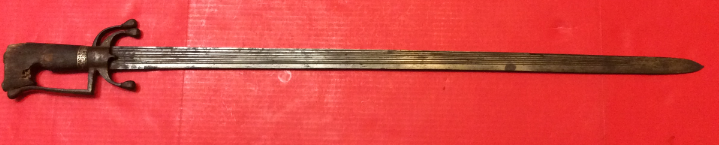

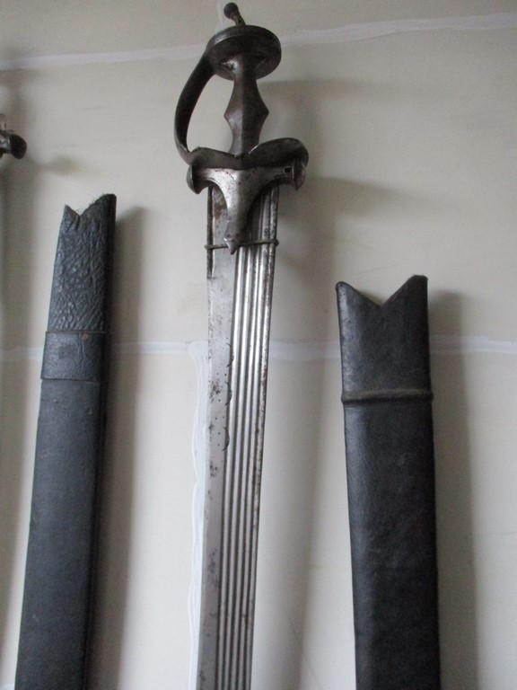

Here is a run-of-the-mill Moroccan Nimcha.
One unusual thing about it is its blade.
As a rule, Nimchas carry curved saber blade, and the majority I have encountered thus far are European trade examples.
This one has straight blade with large false edge. Also, locally-made blades have 3 narrow fullers. This one has 7.
The fullering and the false edge ( and, to a much less degree, straight construction) are very different from the usual local pattern. No markings to claim European origin.
Is this a more sophisticated local production?
Or, trade European blade with no markings?

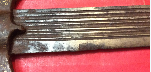

Ariel,
The number of fullers seem to be very big, but what about the ricasso?
As you know I do know very little about these swords.
Jens

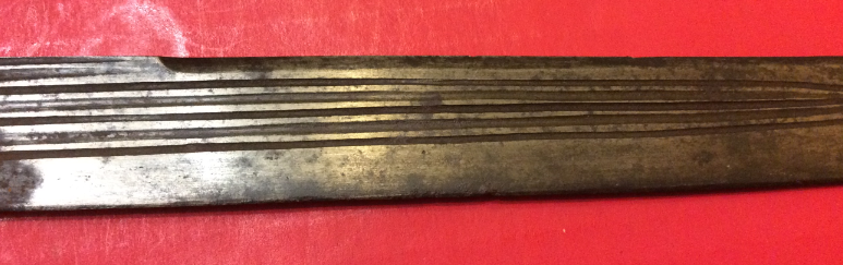

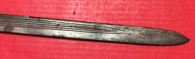

How about a close up of the blade far to the right, where the fullers converge.
Hi Ariel
I've seen many straight blades on nimchas, it's not uncommon,
most of the time old imported blades
But I can't say nothing about this blade.
Kubur

Here is the distal part of the blade with converging fullers.
I checked all my Arabian swords, including 2 Nimchas from Morocco: none of them have a ricasso, including trade European blades.

Ariel, glad you acquired this sword and thank you for sharing it here for discussion. From what I remember from the auction pictures you have also done an excellent job cleaning it. I wonder if the blade could be Indian due to the ricasso and the uneven fullering.
Teodor
Old 8th April 2018, 10:31 AM   #7
Originally Posted by TVV
... I wonder if the blade could be Indian due to the ricasso and the uneven fullering...
That's what i was daring to guess ... on an uneducated basis, though.
Old 8th April 2018, 02:05 PM   #8
Kubur
Kubur's Avatar
Posts: 2,145
Me too, Indian is reasonnable.
Now the question is do you think that the blade was added by a collector recently or in Morocco in the 18th 19th c.?
I'm very suspicious about an Indian blade on a Moroccan nimcha...

Guys,
Ricasso serves as a differentiating sign only between Indian and Persian Shamshir blades. Many European blades had ricasso and I wonder whether Indians not borrowed the idea of a ricasso from Europe.
