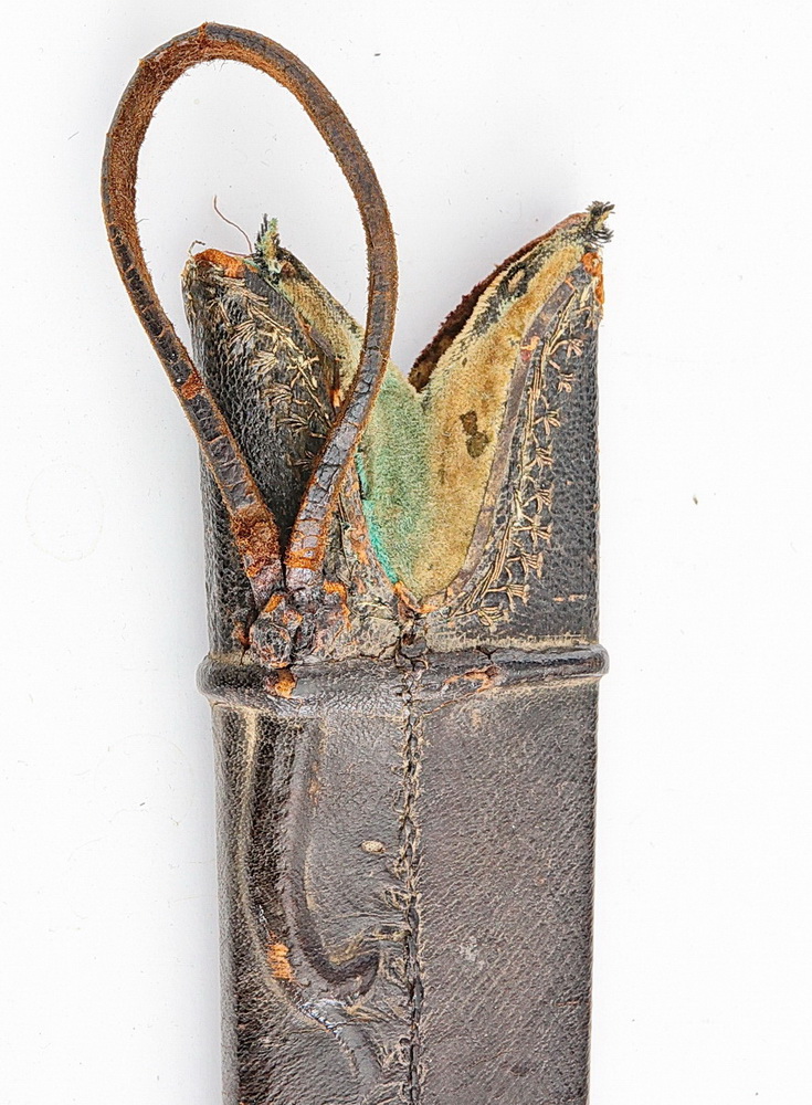

The Indian scabbards were covered with leather, but also with brocade, velvet, and other textiles.
Something which I have only seen on scabbards covered in leather is the 'loop', or rather the rest of it, looking mostly like a 'fish tail'.
I only have one scabbard with the 'loop' intact, and would like to know if other members have scabbards with a 'loop'.
Old 27th March 2018, 04:24 PM   #2
ArmsAndAntiques
Join Date: Dec 2013
Posts: 80
Indeed, I have had several and currently have one with an original loop.
It was used to loop over a handle quillon to prevent the sword from slipping out.
ArmsAndAntiques is offline   Reply With Quote
Old 27th March 2018, 06:19 PM   #3
Jens Nordlunde
Jens Nordlunde's Avatar
Location: Europe
Posts: 2,718
These scabbards with the 'loop' are not very old, but on the old scabbards you can see that these 'loops' was used for a long time, although they have broken off.
It is interesting to notice that the 'loops' were only used on scabbards covered with leather, the other scabbards must have had a string which could be attached to the quillon.

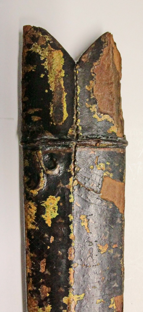

Here is another example.
The originale scabbard is 18th century. The loop is missing, but the 'fish tail' can be seen on the left side of the scabbard.
Old 28th March 2018, 06:00 PM   #5
Really old Indian scabbards must be rarer than hen's teeth: dry heat, wet heat, rains....
Anything from early 19th century in good condition would be a unique example, except for something stored in a royal palace and attended to on a regular basis.
I remember reading somewhere that the Russian War Ministry specified scabbards replacement for cossack hosts ( they were made of wood/leather) every 3 years or something similar. Every time a sword was taken out or put into the scabbard, it cut the wooden inserts and the leather, the leather dried out ( Jens' example) or just rotted.
The reason we see those gorgeous scabbards in Wallace Collection is because they were made largely post 1870 in royal workshops and immediately sold as souvenirs to European museums, dealers and just for the general public to hang them on the wall in their British libraries next to Victorian copies of " medieval" swords..
