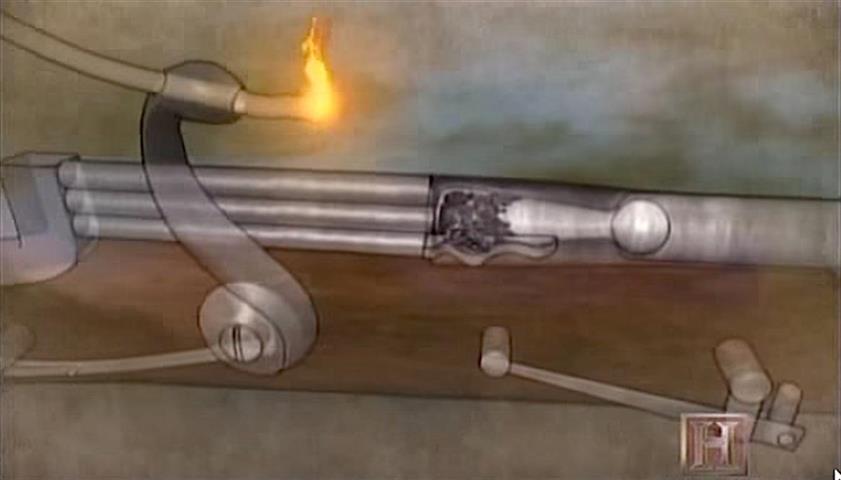

The breech on my barrel seems to be designed just like the photo here from the YouTube vidio.

By the way, do you think the picture posted here, showing the inside of the bore originated from a European matchlock design ?
If you've seen the YouTube video "Mughal Matchlock", they cut the breech of a Torador breech lengthwise. But the only show it for about 3 seconds. But it does show the design similar to the above photo. Which seems to duplicate my barrel.

The picture you post I shard to figure out what it is of, apart from a matchlock, as it doesn't really look like anything I have seen before. :-)

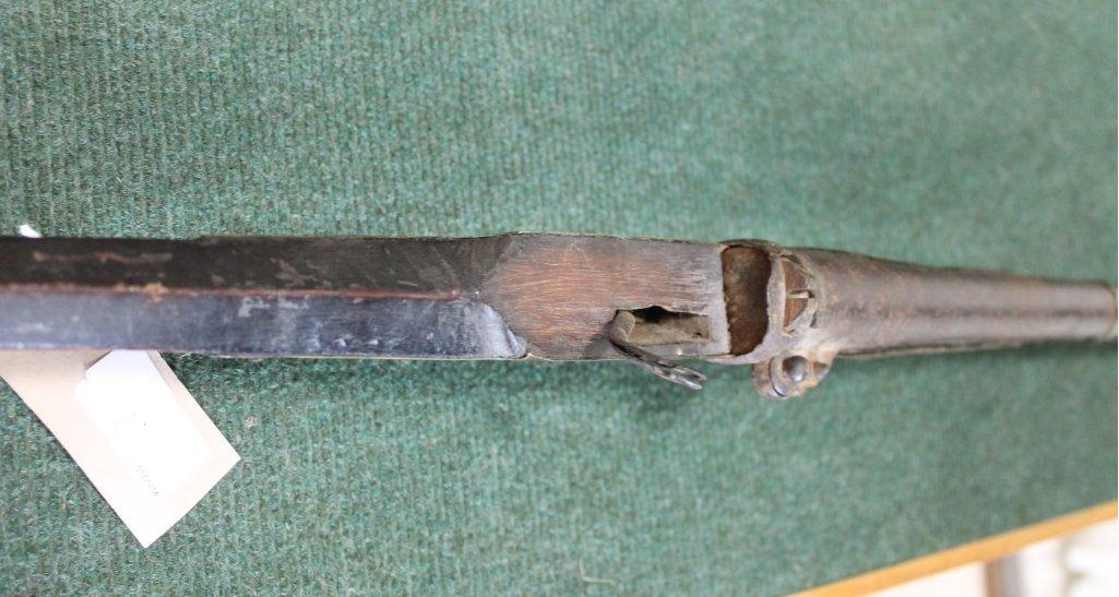

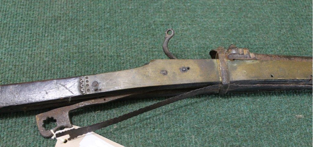

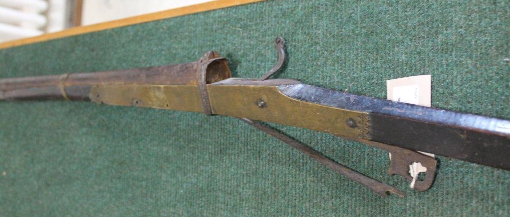

These are the seller's pictures below;
My camera still hiding.
The stock is So slim that it's just about not there at all!!
Richard.

I agree with all your assessments and comments above. As you mention, the restriction in the bore was meant to keep the ball from compressing against the powder. While the breech designs do seem to vary, they all seem designed to handle heavy charges of black powder. The barrel walls at the breech are very thick.
Thanks for posting pics of your Matchlock. Yes, that would be a tough job with the bore not having a removeable breech plug. But the gun definately looks restorable. There appears to be a missing piece of wood behind the breech area of the stock. From the photos, it doesn't look broke. Just missing. Originally, maybe a different colored piece of wood, maybe with a horn cap ? Or maybe one piece of elaphant ivory somebody removed But I don't notice any holes in the bottom section where nails or pins might have been (?). Anyway, be careful with that forearm. Sounds like it might be delicate.

I too wondered about the missing block behind the breech, as there are no holes where pins or nails held it in place, and no signs of glue either!
Looking at the sideplate, I can't see where a match -holder was located, so think it may have had a hole in the rear end of the missing block.
