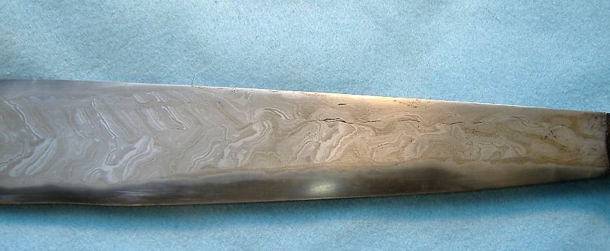

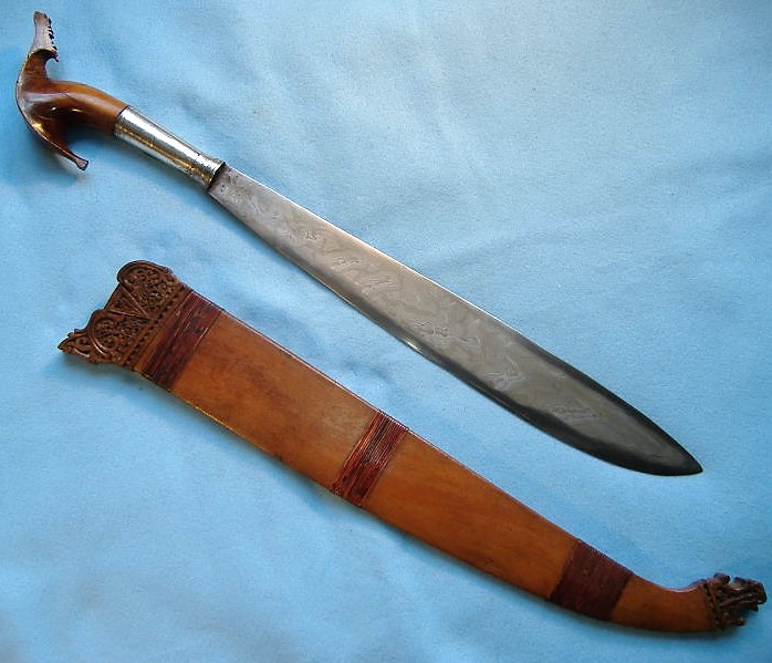

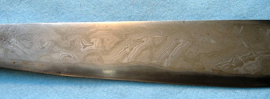

I bought this barung two weeks again because I liked the profile of the blade. At that time it was just a gray blade with absolutely no hint of pattern welding....I just liked the long elegant blade.
Imagine my surprise when I began to clean it up and etch it!!! I was amazed. It is only the 3rd twistcore barung I have seen. I have intentionally "over" etched it to highlight the complex twisting. Note one side is more complete and obvious than the other. I even wondered if it was a "failed" twistcore, but I don't think so. Note also that false edge has been tempered as well as the bottom edge. You can see that the blade has seen some sort of action(looks more like work than war!) if you look at the worn spot in the center of the edge.
Generally, I have associated these long, lighter, and elegant blades with later post-1930 barungs. This one, however, has forced me to rethink that. I believe this is a 19th-century blade or very early 20th century at the latest.
Comments and opinions welcomed.

Old 15th January 2018, 07:27 PM   #2
Posts: 4,736
Hi Charles:
I'm not surprised. A long silver punto and an elegant kakatua often suggest an accompanying blade of quality. The scabbard looks complete too and of the older flat style. Great find.
I agree with you that longer slim blades have been around for some time and are not necessarily post-1930. I've seen several of these that are likely 19th C.
Ian.

But I would wipe off some of the etching and leave just some hint of the pattern... if the blade were mine... but it isn't...
Marius,
I couldn't agree more. I don't think this is the original or "natural" state of the barung. I did this dark etch ONLY for the sake of photography and showing the complex twisting on this site. I will eventually tone it down to a more natural look just as you suggested.

Originally Posted by Roland_M
Nice blade indeed. But I believe, this is not a twistcore, it is thin layer of twisted metal on each side. This would explain the unusual wild look of the twisted layer. The twisted bar was forged into two thin layers.Roland
Roland, I have wondered this exact same thing myself, but keep getting consistent feedback that it is Moro twistcore.....
Roland
I agree. The pattern on each side does reveal a twisted structure, but to be twist-CORE, this structure would have to go the entire thickness of the blade, with the edges being "stack"-welded to the cutting and dorsal sides. In this case, the core is what protrudes as the cutting- and back-edges and is laminated in sandwich fashion between the twist-pattern layers on each face.

Old 17th January 2018, 01:10 PM   #19
Hello Roland,
Thanks for chiming in! I was also trying to figure out how this pattern got forged.
I was considering a complex stacked construction instead of twistcore - kinda like the blotchy pattern sometimes seen with barung blades but crafted with the intend to obtain a regular "fishbone" pattern.
However, the margins of the pattern do seem to support your notion that this twistcore got flattened a lot and sandwiched onto the central steel layer; this certainly explains the distortions but still is a real feat to forge with only a traditional workplace!
Old 17th January 2018, 01:27 PM   #20
Question
Hello Phil,
There are Moro keris blades that show all the signs of being a twist-core construction, the format bearing considerable similarity, in principle, to sword-blades of Anglo-Saxon and Nordic Europe during the early Middle Ages.
The origin of the word twistcore may be based on a solid piece of "twist" - however, I don't think the definition needs to be that strict! Otherwise, there would be no twistcore barrels!
The most important features seem to be:
1. forged from twisted bars
2. exposure of the core of the "twist" by removal of the surface.
If anything, symmetrically applying the forged twisted bars to a sandwich construction needs even more skill IMVHO...
Old 17th January 2018, 01:54 PM   #21
Gustav
Join Date: Jun 2009
Posts: 1,346
There are two twisted bars on each side. The blade as end product is much to wide and long for the size of these bars - so while forging out in the length and width the control over the appearance of twisted pattern was lost. We see it the best towards the tip of the blade - always the trickiest place to control the pattern.
Normally there would be more bars on such a blade, like on ex-Gavin's Barong (or yataghans)
http://www.vikingsword.com/vb/showth...istcore+barong
and/or the bars would have been kept narrow
The smith simply wasn't experienced well enough to work with twisted bars and didn't know the relation between the size of the bars before the forging process (let alone some tricks like increasing the amplitude of the twists) and the blade at the end of process.
That could be a hint to a slightly later date of production or/and a more "provincial" place of production.
