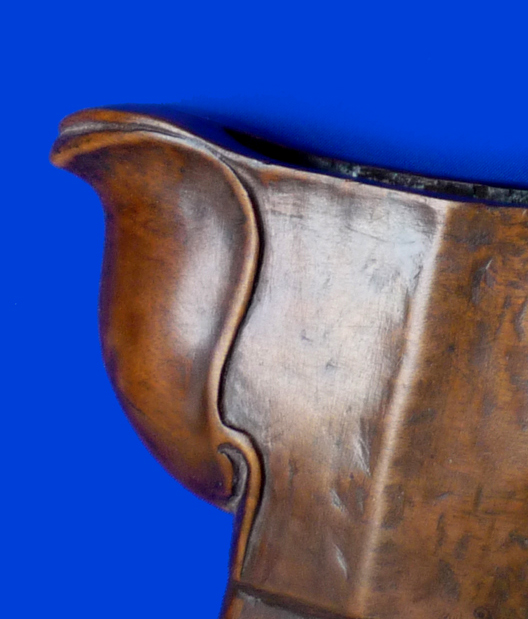

Hello!
Hope everybody had a wonderful X-mas and we running fast towards the end of this year! So herewith all the best to you and your beloved.
My question is simple and straight. What do I have here: an East-Java sheath or rather West-Java because of the double lip which is seen in Pesisiran area krisses.
The blade is not the proper one and doesn't fit well at all so refrain from showing it. It probably distracts.
Anyone having a clue?

Hello Paul,
No definite answer from me either; however, I'd lean towards a more western attribution: Banten, Cirebon, maybe even Tegal, too...
Please post a view from directly above - the third dimension of this scabbard may help to narrow things down!

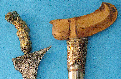

@ Alan: is this the Solo Gayaman from Jensen? I checked the disk and only came across this fig. 68 and it might have a double hanging down lip but the pic is to vague to be sure.

Thanks Paul, yes, that's the Jensen one I had in mind.
The blade is Segaluh, but in my mind I had this complete keris as Madura East Jawa, but with the Segaluh blade? Maybe not. Been a long while since I've seen the pic. Tell me, is that the full pic? No pendok? I thought I remembered a Madura pendok. Maybe this thing is a montage. One thing is certain, not Solo.

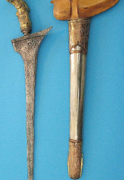

I cannot recall ever having seen this "double lip" as in Paul's scabbard.
I'm attaching a pic of Kai Wee's keris exhibiting an IMHO related feature: The contour running up at the left side of the scabbard (i. e. the shorter end when the outside is on display) fully continues as an engraved line towards the left tip resulting in two "lips" rather than just a single upper rim as in most keris scabbards.
This feature is also seen in Wien #91.919 and probably Skokloster #6959/7042; some of the Kunstkammer scabbards exhibit an essentially identical line running towards the tip (some have chipped tips a few may not reach the tip though):
Sendai
Dresden #2897
Dresden #2896
And a stone sculpture referred to the 15th/16th century also shows the "double lip" feature (Museum Nasional Jakarta 310d) very clearly! (Cp. Weihrauch 2001, Fig. 18.)

The pic from the disk added as a printscreen. The pendok (pimped?) has a strong Madurese vibe.
Again a poor pic.
BTW> My disk got stuck also, I bought a new one and saved the content as PDF files and I can search trhu it much quicker and it won't fail anymore!

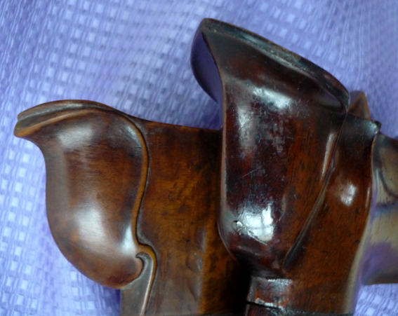

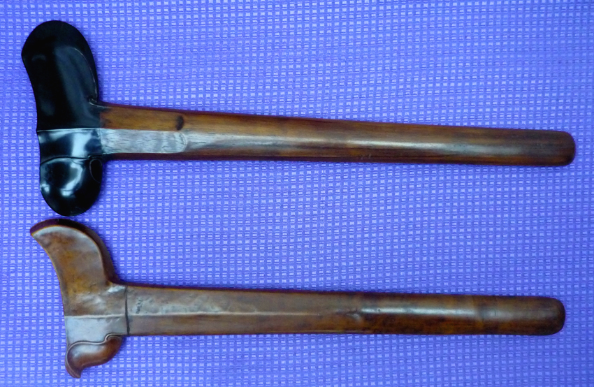

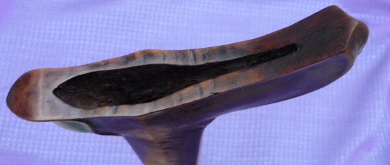

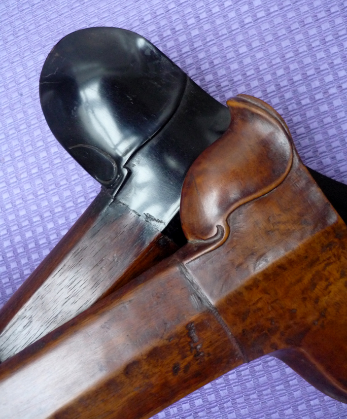

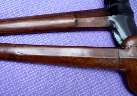

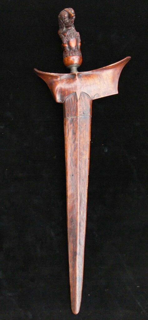

Here are some more pics.
Remarks:
Why rule out Bali? The size of another typical Bali kris fits within the paramters?
Besides the elevation seen on the gandar (not perfectly straight) is a feature that speaks for it so is the somewhat similar mata ideng.
A blade with a max of 38 cm would fit in.
The slot opening shows a wide opening. Sizes: 8,5 x 1,3 cm.
It still puzzles me...
Last pic shows a Banten kris with double lip too. Not sure if that is the right path we should search.
