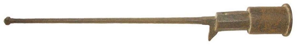

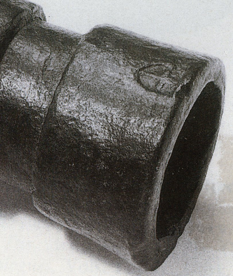

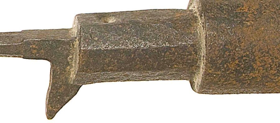

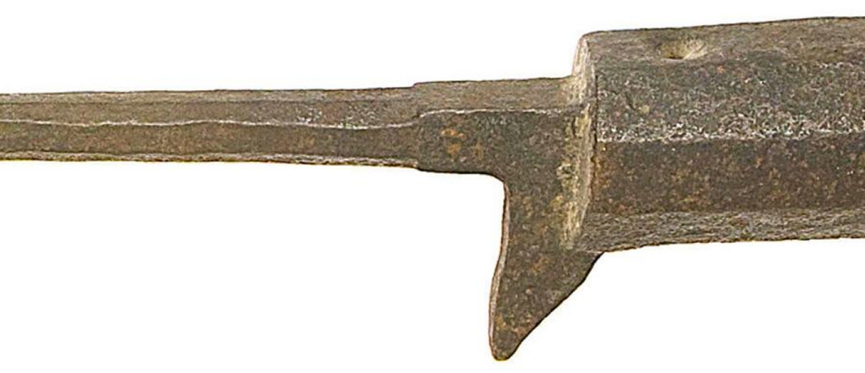

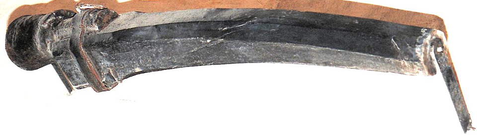

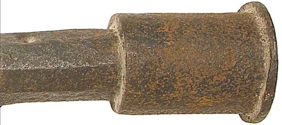

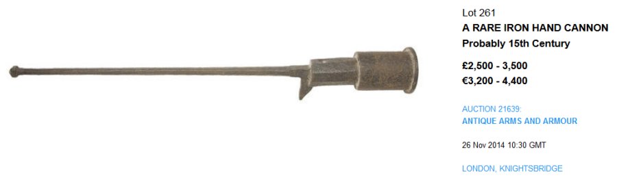

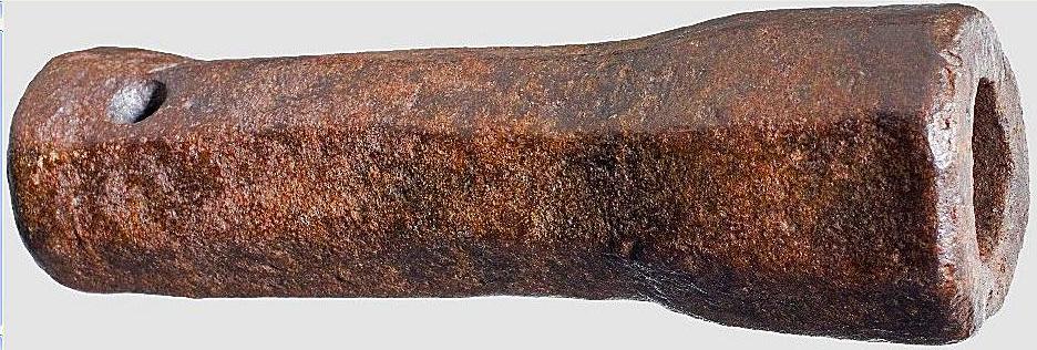

This gun formally counts among stone trowing guns - German: Steinbüchse - equipped with a narrow breech only holding the gun powder - German: Pulversack - , and a wider but short forward section that would receive a stone ball - German: Flug. In many cases, that forward section is only the size of the stone ball, which literally was set at the muzzle.
Apart from a tiny number of huge bronze pieces of artillery, all Steinbüchsen were made of iron, with 95 per cent of them being wrought, and only the rest cast.
The rear part of the gun in discussion, including the octagonal breech and the hook, may be old and original; it is mostly the round barrel that definitely raises the author's doubts. Its surface lacks the irregular traces of the hammer clearly seen on the rest of the gun, and its patina does not match that of the whole of the rear portion either; it looks much smoother than the rest, covered by a lichen like patina not found on the rear section.

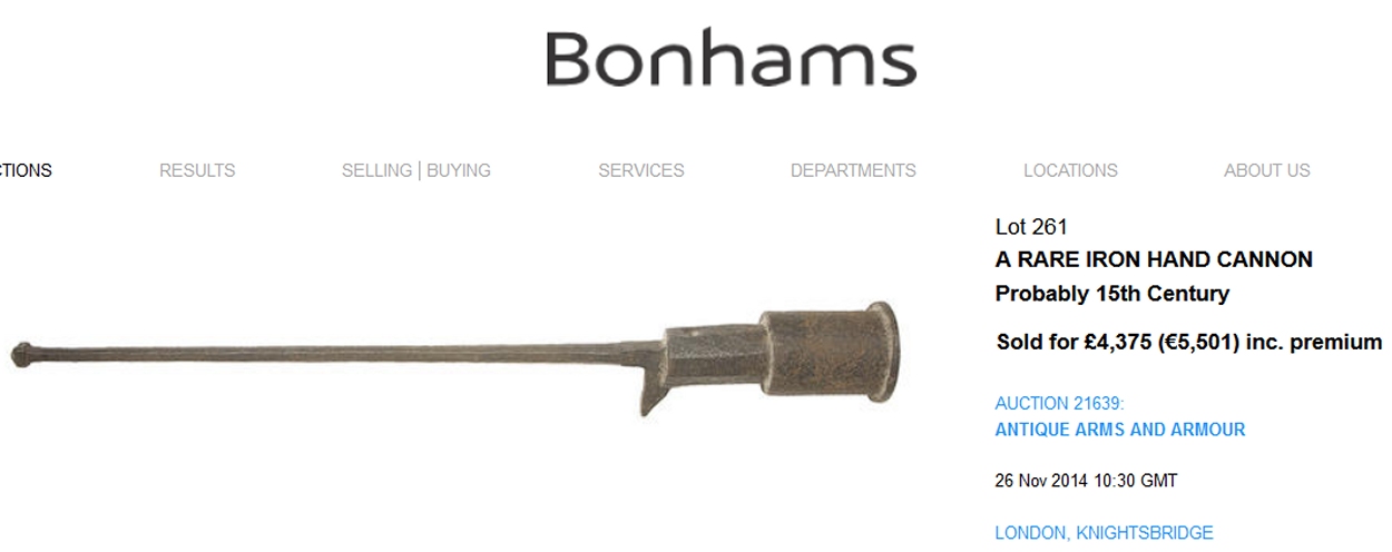

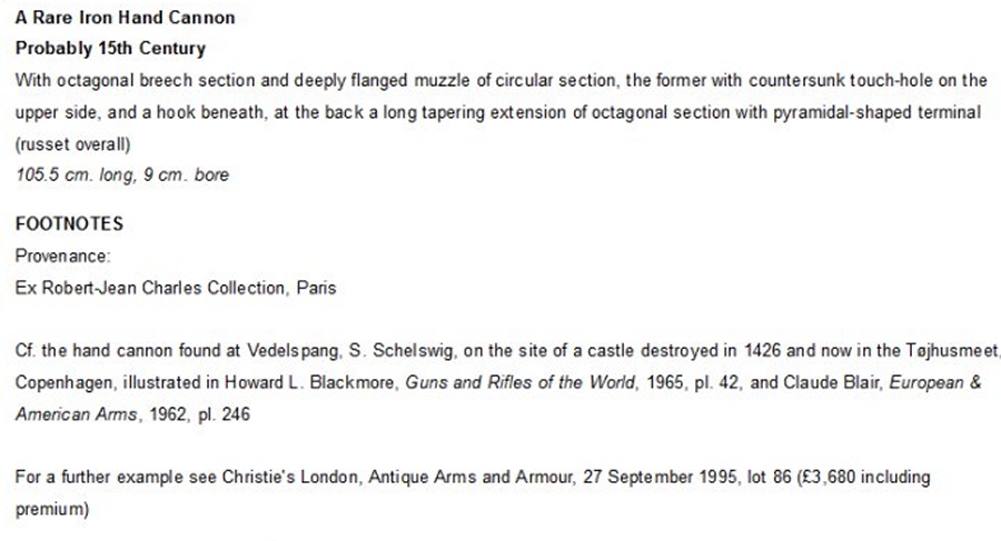

The catalog description, too, was quite careful reading "probably 15th century"; the author begs to differ in being quite sure that it is not, at least not throughout.
The provenance from the Jeanne & Robert-Jean Charles collection is not a certificate of authenticity by itself; all it stands for is that the piece, in its present form, already existed in the 1930's when the Charles' started forming their collection. Like all collections comprising many hundreds, or literally thousands of various items, instead of concentrating all the collector's expertise on one special period, field and type of weapons, the Charles collection contained some fine items as well as a large nuumber of heavily altered, doubtful or definite Historismus pieces made in the Victorian period - by the earliest.

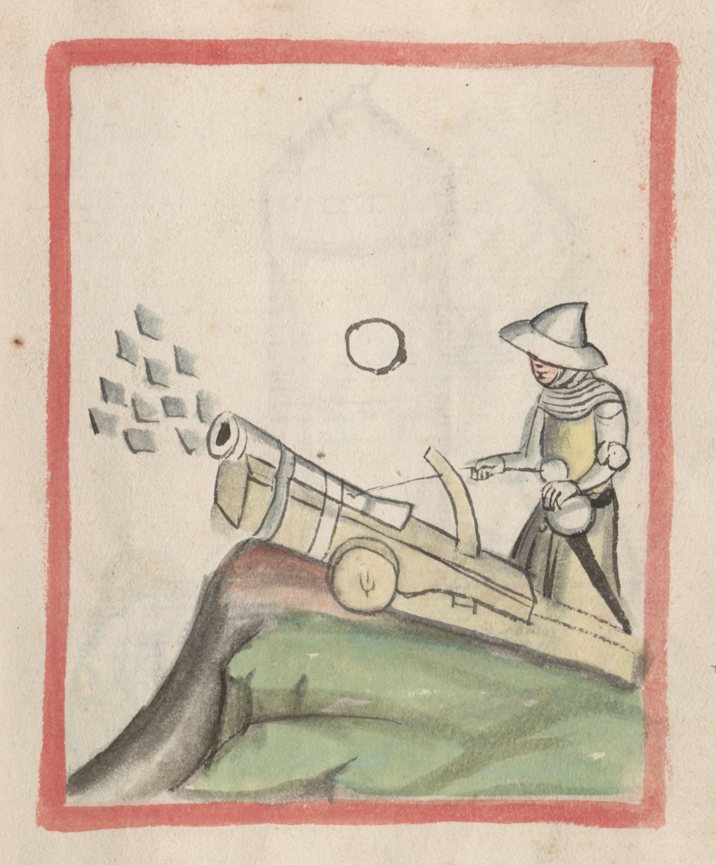

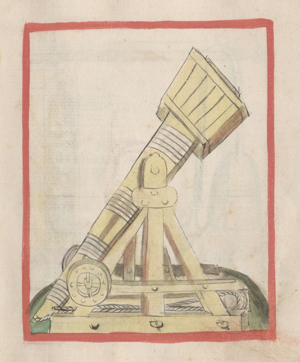

Some typical Steinbüchsen - not yet showing a hook! - from an illuminated manuscript dated 1411, cod. 3069 in the Österreichische Nationalbibliothek Wien:
- fol. 9v
- fol. 15r
- fol. 16r
- fol. 25v
- fol 45r
Michael

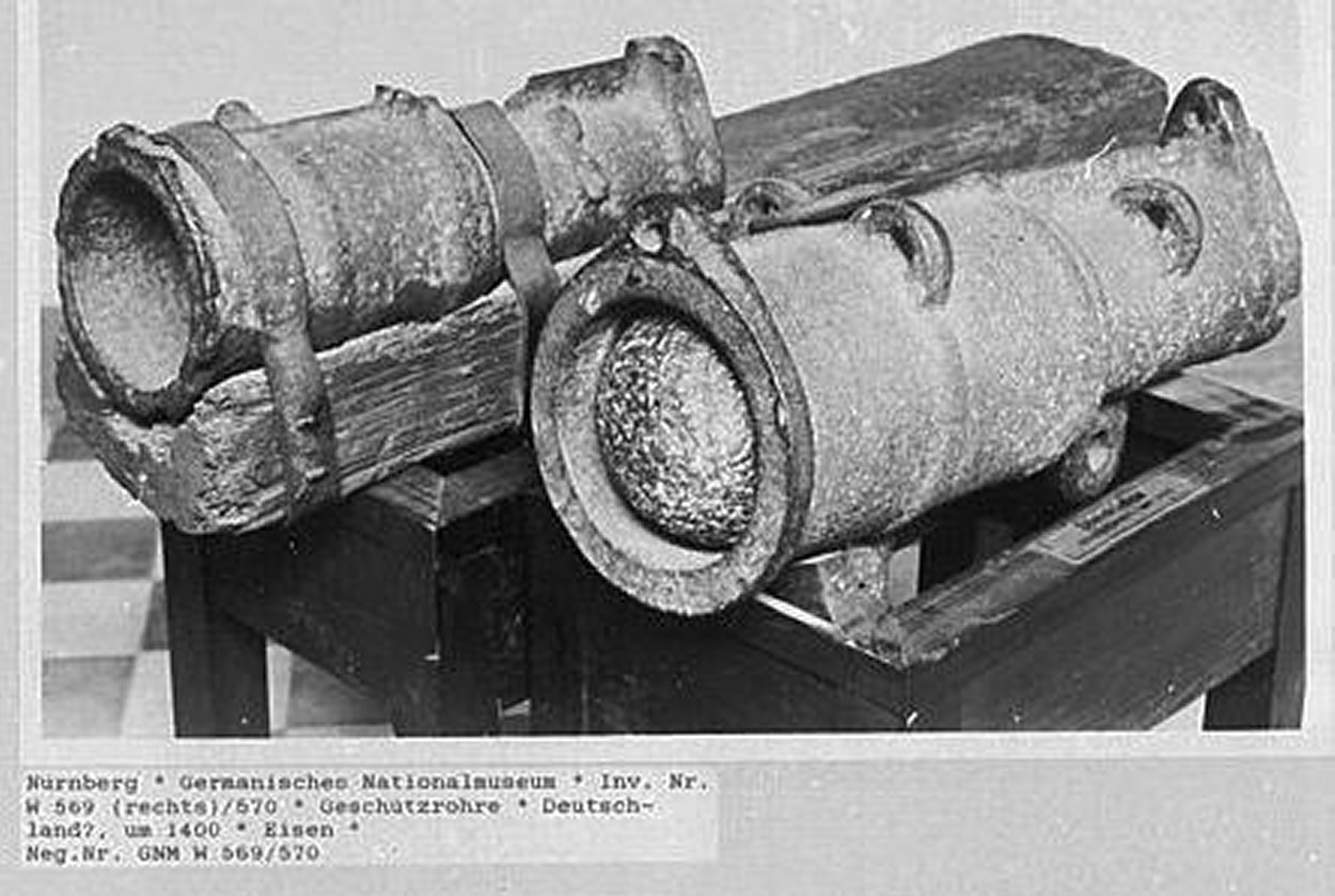

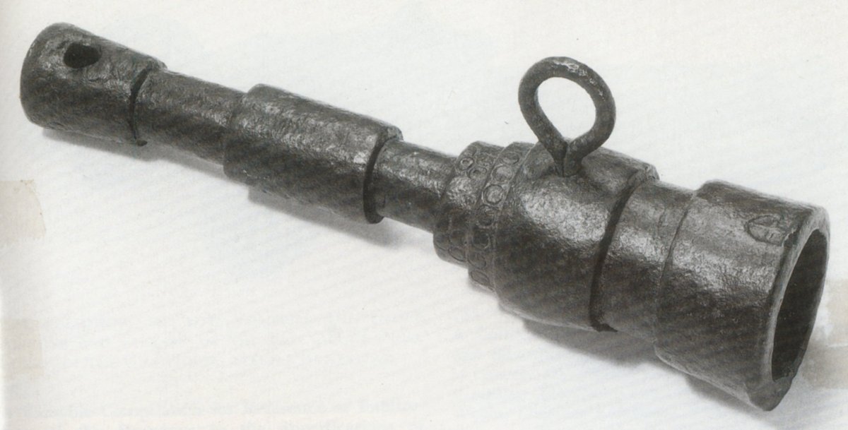

Steinbüchsen NOT yet equipped with a hook, from 15th c. illuminated manuscripts.
From top:
- Cod. 3069, dat. 1411; Österreichische Nationalbibliothek Wien, fol. 10r
- dito, fol. 40r
and some surviving samples from the museums in Paris, Weißenburg/Bavaria, Hohensalzburg, Nuremberg and Passau, plus two specimens sold at auction withe Hermann Historica, Munich, and Sotheby's N.Y.
Apart from a few huge pieces of artillery, all existing Steinbüchsen are of wrought iron.

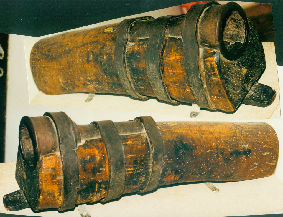

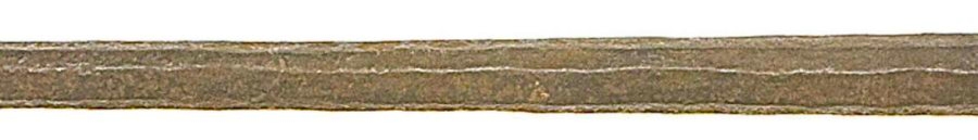

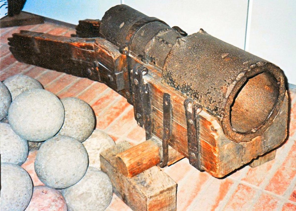

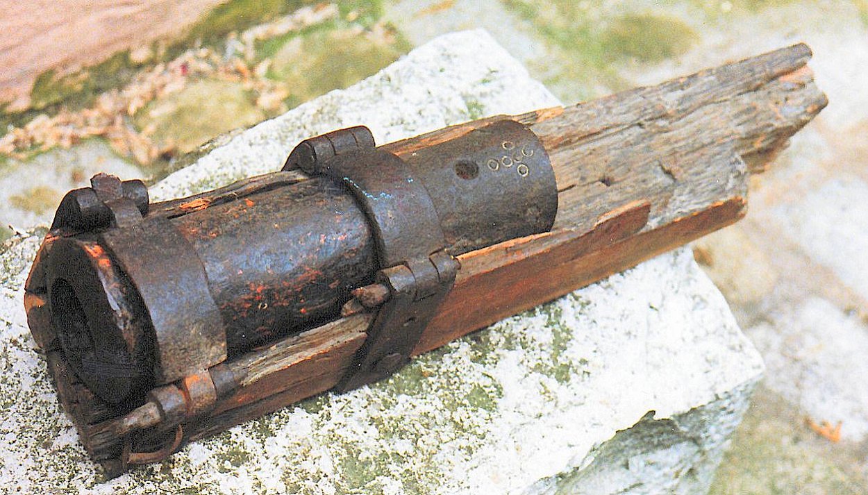

Just adding some pictures to this thread which i seem to have aquired

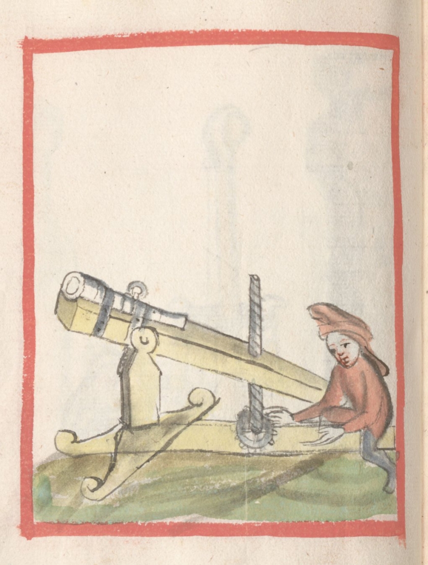

Also re-attaching a manuscript illustrations of what might be a Stein Büchse. Not sure though, the breech section is too small, especially when comparing it to the supposed forward section wich held a stone ball.
Old 1st December 2014, 08:18 PM   #5

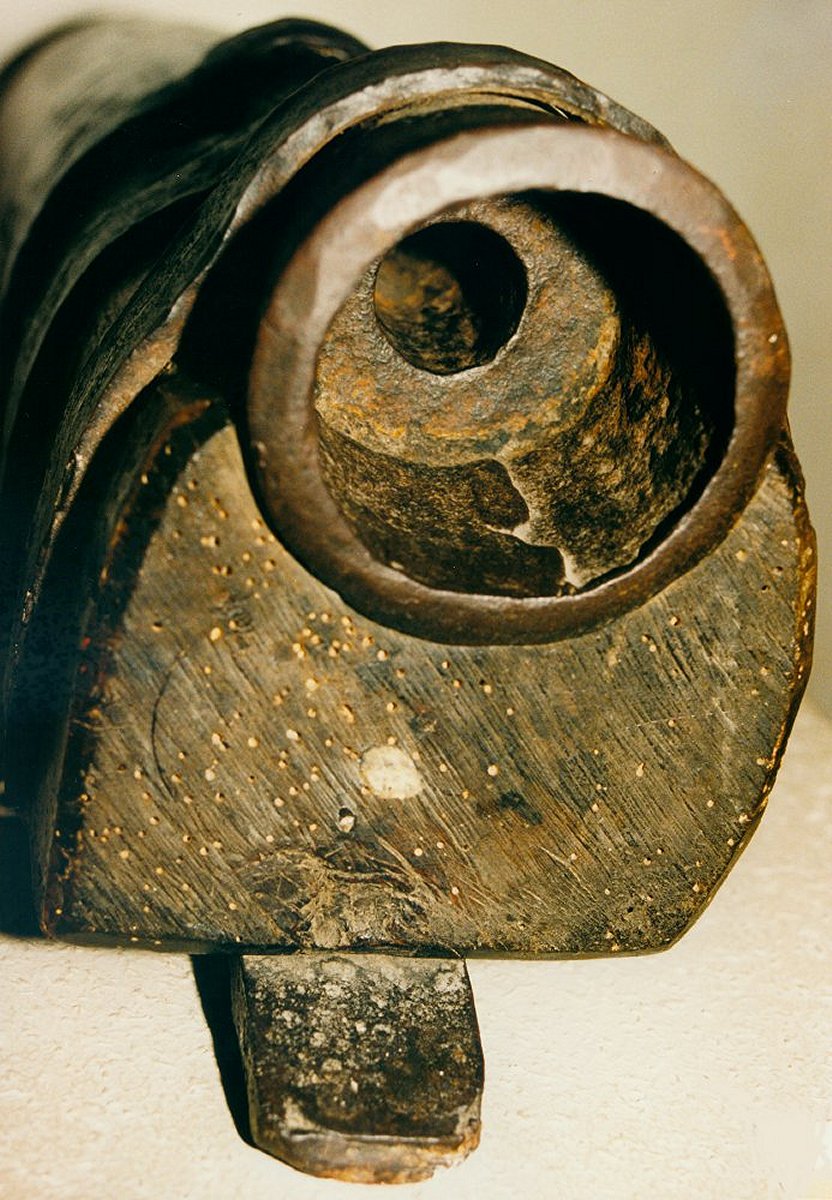

some more

Posts: 543

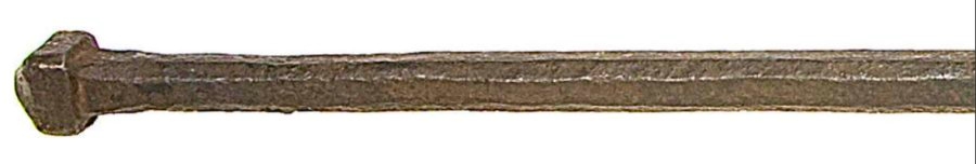

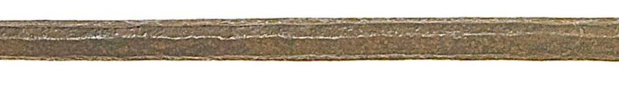

Voila, le rest.
Also the interior of the barrel (s) seem altered... the octagonal part which might have been joined later on with the round part looks to be shiny in places.

Posts: 4,310
Hi Marcus,
Thanks for posting these additional custom made photos.
And a VERY special 'thanks' for posting that source of illustration
- would you please let me know where you found it, and what manuscript it belongs to?
On those images, the surface of the forward section of the gun looks more consistent with the rest, and my doubts have diminished a bit.
Still I feel that the thickness of the barrrel wall at the muzzle is unusually low for a 15th c. piece, and the muzzle is not hevily swamped as would be expected but only shows a small brim. An actual swamping the white-red iron with the hammer would have added to a higher endurance indeed while that brim just folded outward does not ...
Anyway, in my opinion the overall appearance of that gun breaks one too many rules to render it acceptable.
m

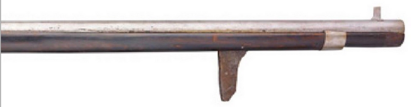

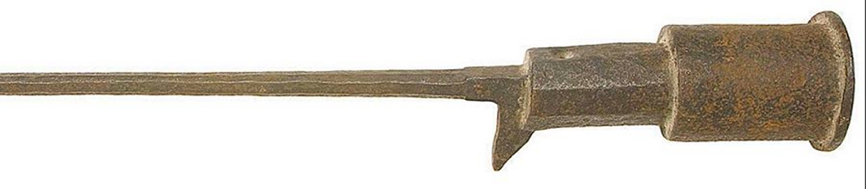

Michael! Thank You for this interesting photo! I have never seen this way of fastening hook. Usually hook is on barrel or on stock but not between barrel and tiller
Spiridonov is offline   Reply With Quote
Old 2nd December 2014, 07:34 PM   #9
Matchlock
Matchlock's Avatar
Join Date: Sep 2008
Posts: 4,310

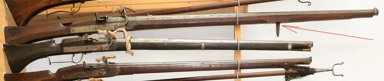

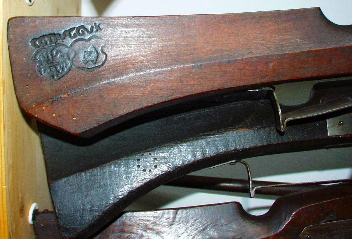

Exactly, Alexander,
Neither did I.
Anyway, viewed from the stylistic aspect, this seems to be one of the earliest hooks, of ca. 1430, as it is quite small in proportions.

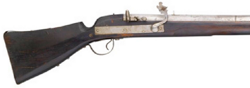

Hooks on stocks, though, do not appear before the 1630's.

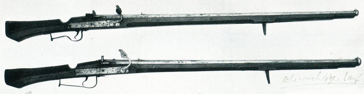

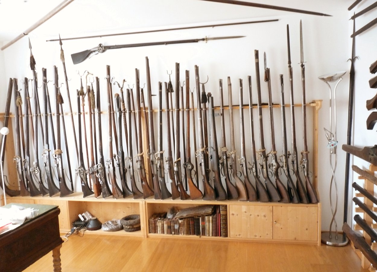

There is a small series of seven long matchlock muskets (overall length 1.72 m) known, the barrels and lock bearing Suhl marks; they were sold from the famous armory of the Counts of Giech, Sotheby's, 1974. The stocks are all branded with the alliance coat-of-arms of the Giech and Kaunitz (they married in 1633), and the hooks are fixed at a blued iron basic plate that is nail4ed to the underside of the forestock.
The finest of the seven pieces is in
The Michael Trömner Collection (top atts.).

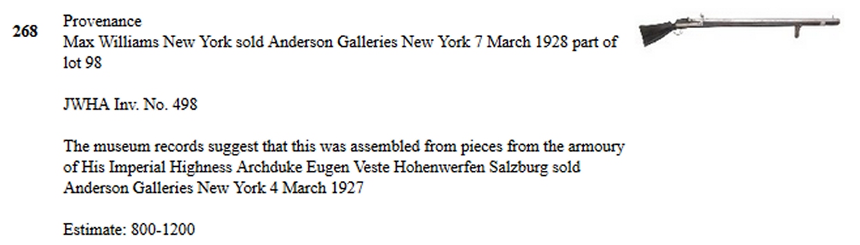

Shortly after the end of the Thirty Years War, Austria developped another long matchlock model M 1657; quite anachronistically, a small series of those musktets (overall length 1.72 m) was equipped with a hook added to the underside of the forestock by an iron cuff and four wood screws.
A specimen was sold from the Higgins Armory, Massachusetts, with Thomas Del Mar, 7 May 2014, lot 268 (next 2 images attached).
A finely preserved sample of that long gun military model, from the ordinary series without that additional hook, is in The Michael Trömner Collection (bottom atts.).
Michael

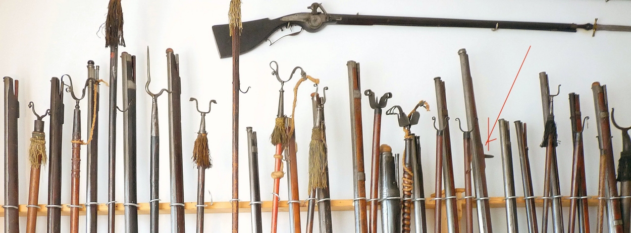

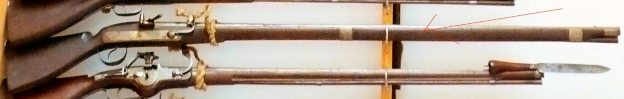

If my eyes do not decieve me there is a similar steinbüchse in the right corner of this picture. It does not appear to have a hook but otherwise looks the same. The picture is of too low a resolution to see any details. It is supposed to be in Orleans in France.
