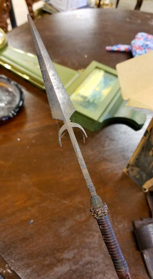

Hi folks. A friend of mine sent be photos of this spear hoping i might be able to ID it, but it is out of my range of knowledge. Anyone know anything about this?

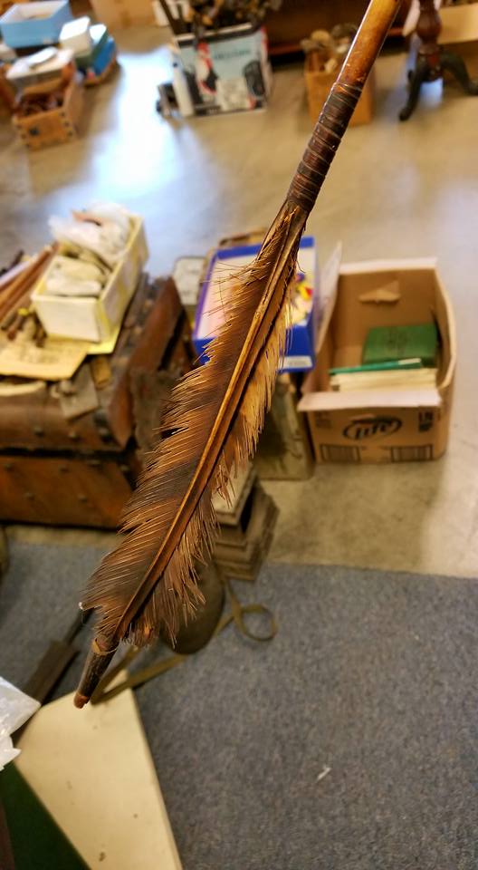

It does seem meant for throwing as it seems to be fletched for flight stability.
I am sorry, i don't know the exact dimensions here, but hopefully the form is obvious to somebody here. Thanks!

Looks more like an Arrow to me.
Unfortunately no idea where it could be from.

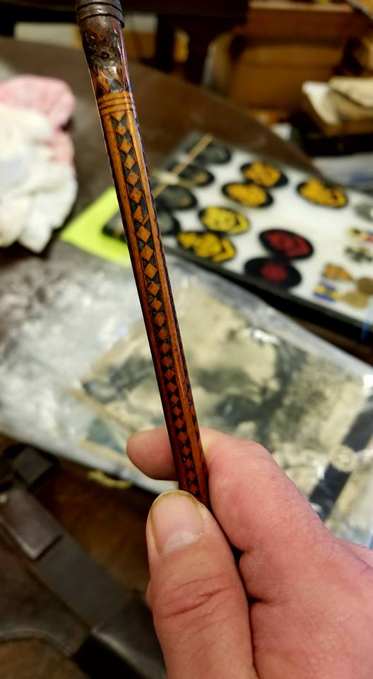

The overall shape of the tip of the arrowhead, the file work on the shank and the decoration on the shaft looks very similar to that found on some Philippine arrows that I have seen.

Yes, arrow is probably more appropriate, but i did not see this in person and my friend gave me no image of the entire object with size reference.
But i do believe we have narrowed it down and what we found seems to confirm my original belief that it is SEA. This seems to be from Aeta Negrito in the mountainous parts of Luzon. Can anyone confirm that to know any more about these arrows? First time i am seeing such a beast.

The fletching looks either Negrito or Igorot. Both are from Central/Northern Luzon. There are similarly shaped arrow heads shown in Krieger's plates elsewhere on this site—those hunting arrowheads are detachable and ascribed to the Negritos.
There is some information also in Fox's article on The Pinatubo Negritos, part of which is found here.
