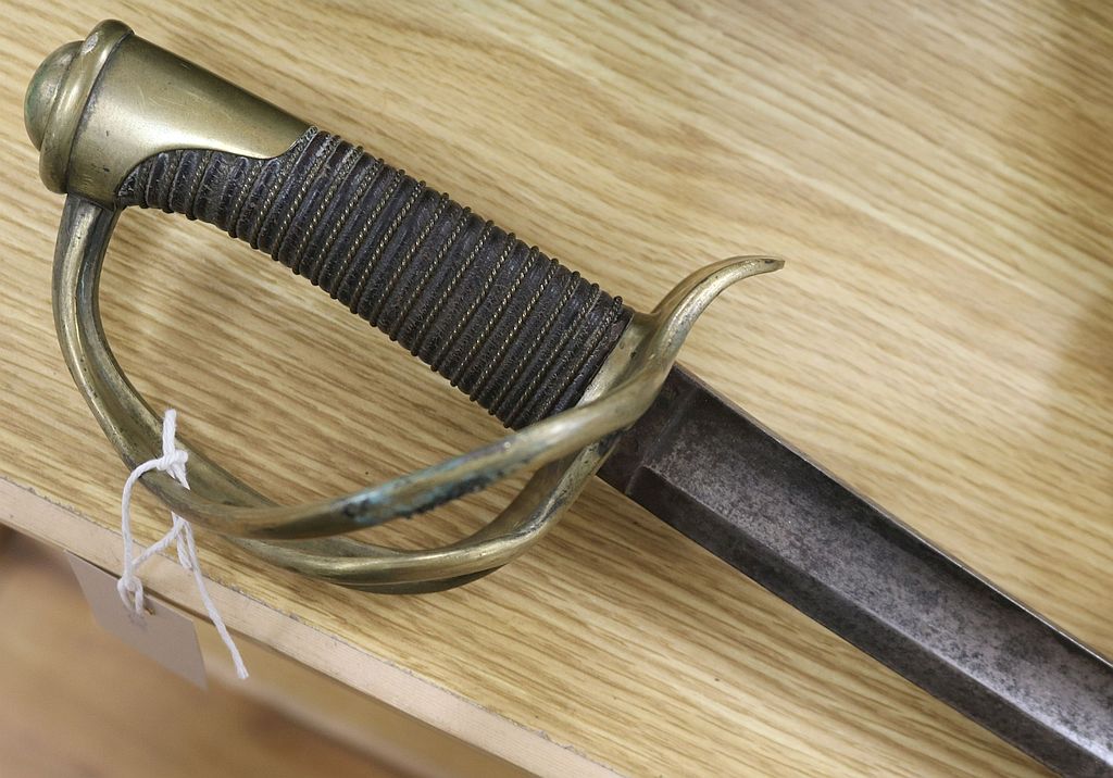

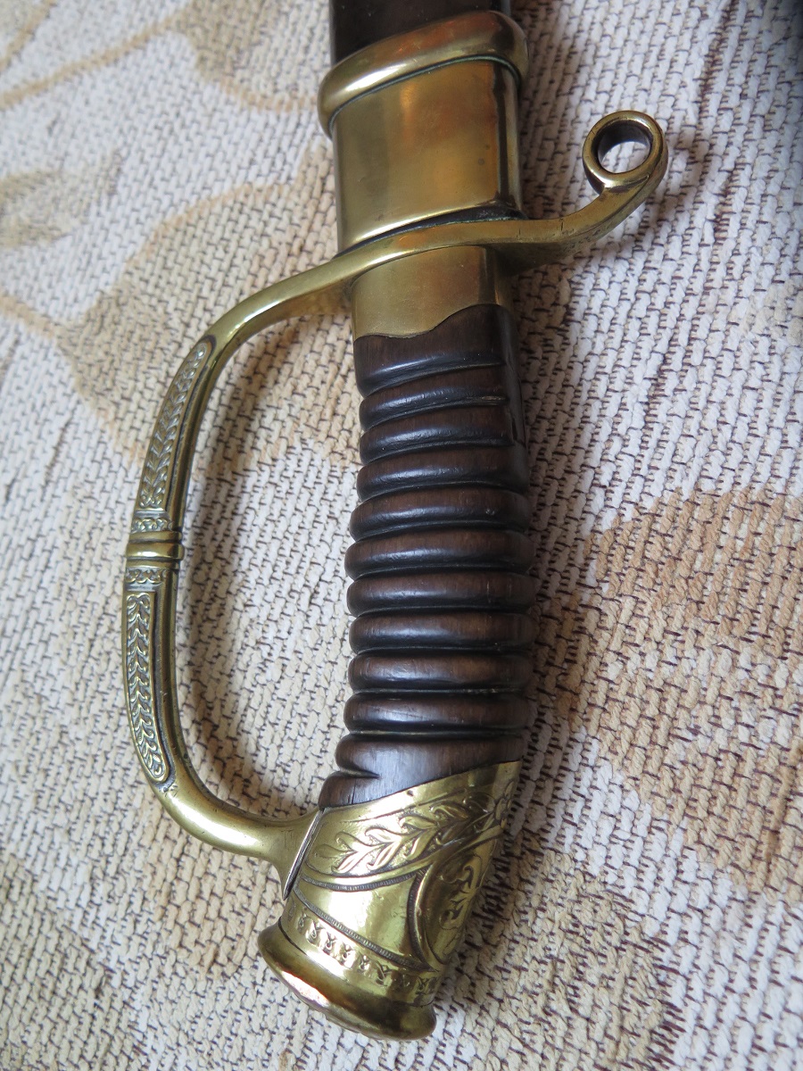

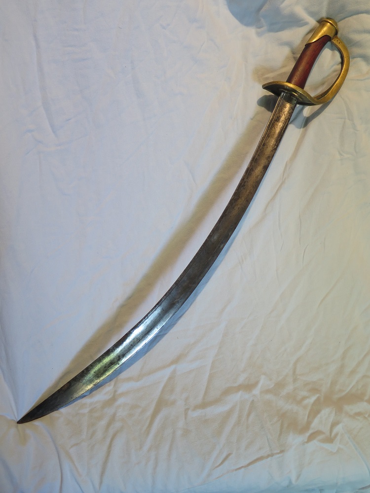

Hello All,
Hope you are having a good day.
This sabre is a mystery to me...
Overall length: 83cm (32")
Blade: 67 cm (26.5")
Stongly curved blade....
French-style brass hilt stamped '44'
'x' s on blade....
My guesses are usually wrong, but I though maybe boarding cutlass and or a 19th C. depot refurb in some some lonely colonial outpost.

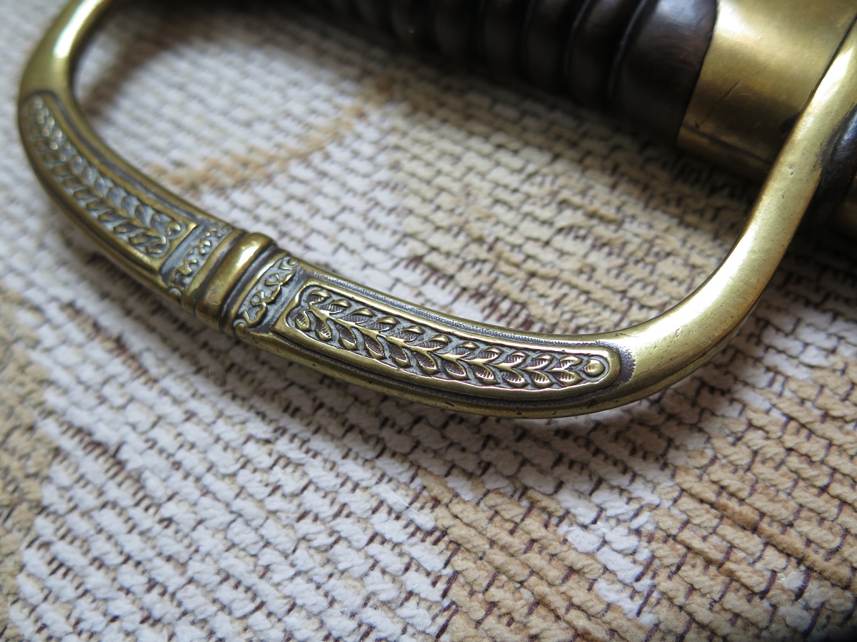

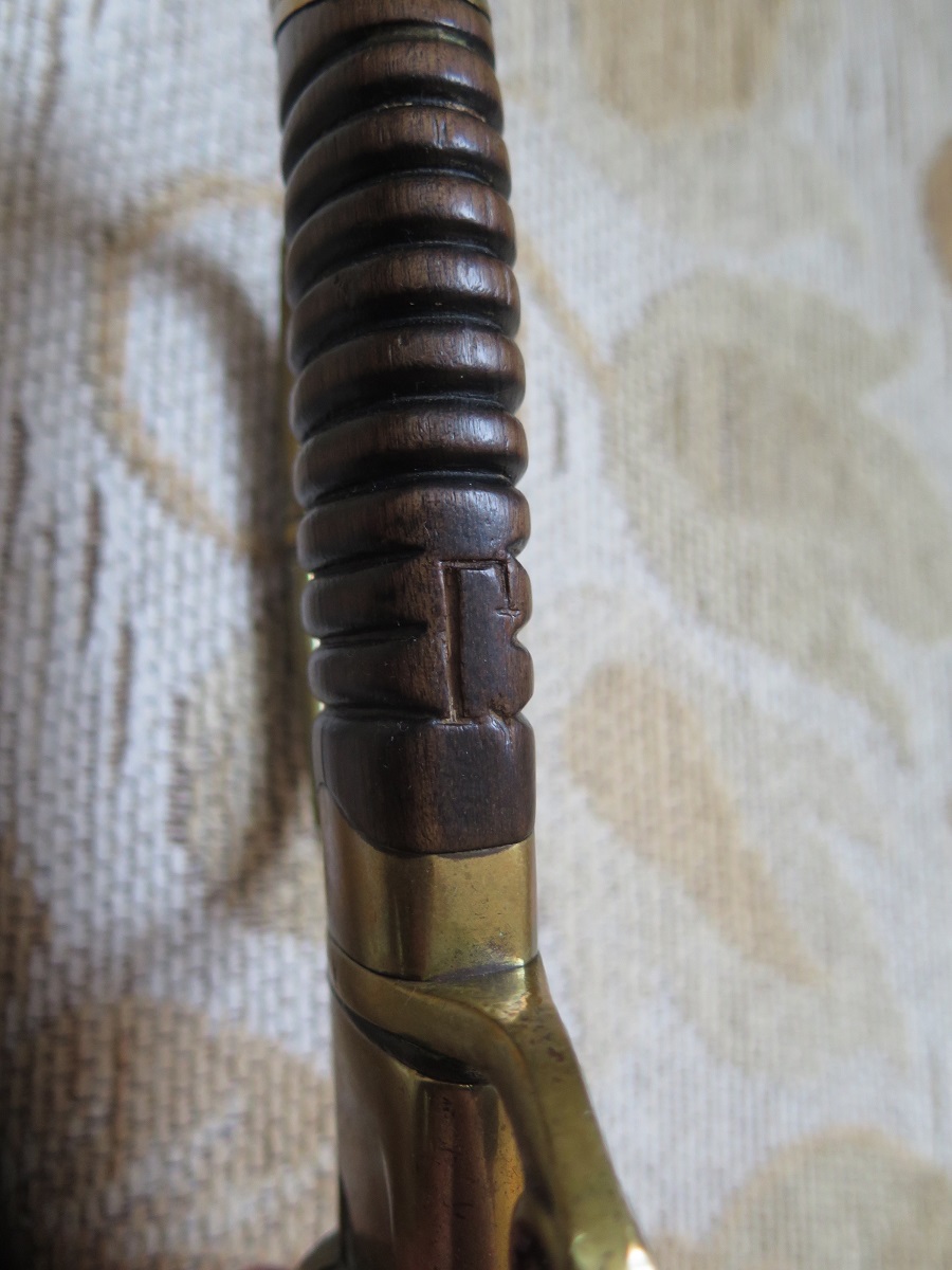

I would add that the grips make me uneasy, have never seen that type before on any military weapon..

Old 28th October 2017, 01:58 PM   #4
Posts: 10,867
I agree Jon, but they are very well made hardwood and seem well intended. That hilt is as you say probably French and of course 19th c. of the forms 1820s+ (I do not have references at hand at moment) and does not go with the blade.

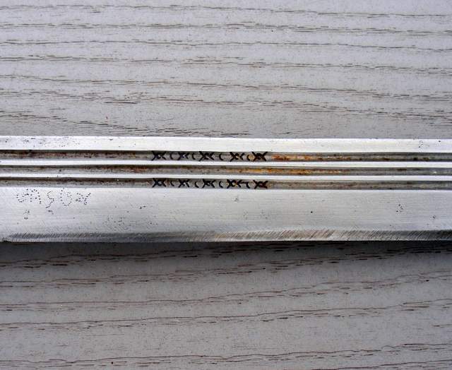

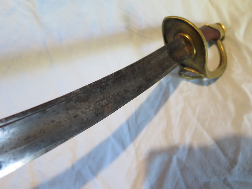

The markings on the blade resemble the 'twig and similar markings from Italian blades, and it seems more a hanger or short saber blade of mid to latter 18th c. These were heavily copied in Germany of course, but in this grouping and multiple configuration it does not seem this is Solingen.
I think you are right, probably a colonial rework in French regions, but more research to find more. Guesses are just a benchmark to continue research, and the cutlass idea is a good one. These kinds of combinations are not unusual to maritime situations, and officers on all manner of private vessels often had weapons put together or commissioned, sometimes in ports of call where artisans used available components to answer their requests.

Excellent, thank you for the input, Jim. It seems little used, post refurb.

Actually in my opinion, these reworked combinations which do seem to have seen some use post refurbishing, are most interesting. Many do not seem to realize that edged weapons often had long working lives even generations after the original components had been produced. This is especially true in remote or colonial locations where virtually everything was recycled. I have seen these kinds of combinations a lot in Mexican context where old elements of various previous types of swords were combined.
One had a briquette grip, a three bar guard and an old Spanish dragoon blade cut down with the 'Spanish motto' still legible.

the grip looks like it should be wrapped in something, twisted/braided wire, leather, rayskin, anything.

Interesting blade, the grip once had leather but long gone. One bar is missing and where it once joined the guard it has been filed smooth as not to be noticeable. I think the blade may be older than the hilt.

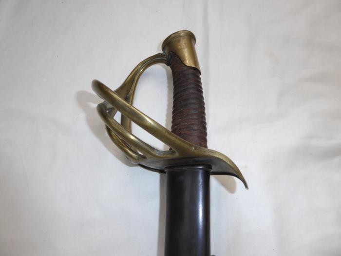

i missed this one at auction today, listed as french cavalry sabre.
very similar to the above, but hilt is more complete with grip wires. as noted the phrygian cap sabres of the french were copied by the USA, and a number were actually imported from france.

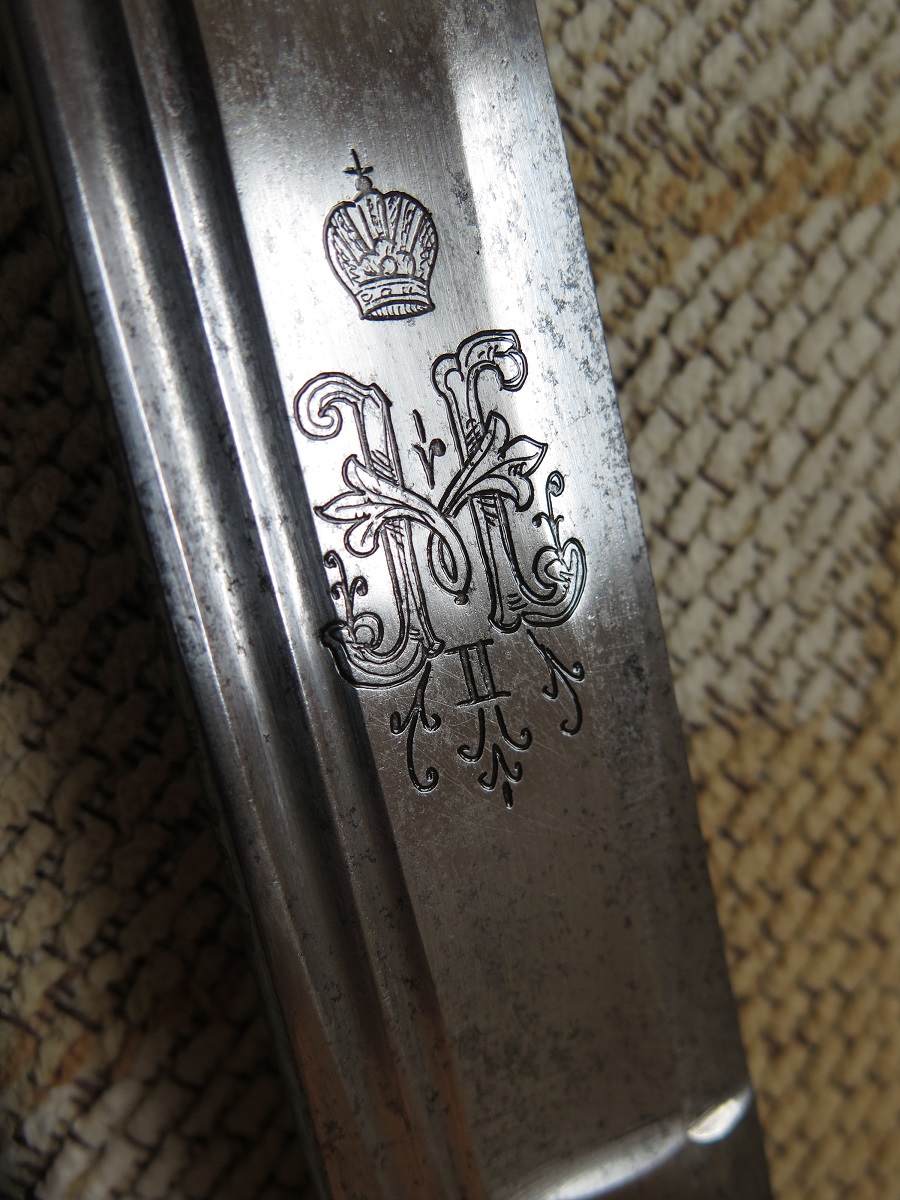

Thanks for your input guys! All very handy comments & further pointers for research.
Any further comments on the blade markings though?
The piece came from Bristol, in the UK. Not sure that much can be inferred from that though...

Why has no one considered the idea that this blade may be of Indian origin?
There are very similar marks and fullering on an Indian straight tulwar in my collection. Granted they're a bit different from the marks shown; but possibly other Indian smiths executed them a little better.
The intent at least seems to be there.

Well noted Rick, and actually looking at those distinctive 'twig' or marca mosca type markings, used in these multiple configurations reminded me of European blades, particularly Italian, which have been seen on a number of 'firangi'.
As we dont really know for sure what colonial setting this composite was assembled in, it is hard to say what the source may have been for the blade. What seems somewhat clear is that it is of likely latter 18th century. Meanwhile the hilt is of the type of primarily French style of around 1820s in thier cavalry swords, the distictive pommel is known as the 'phrygian helmet' style in many of the references and was copied by the US in thier M1840 and M1860 patterns of cavalry sabres,
On the example you have posted Rick, those stippled letters are indeed Indian script and denote arsenal markings well known from the Bikaner armoury in Rajasthan. They are indeed mindful of these curious multiple markings in grouping which actually originate from such blade markings uaed early in North Italy, and diffused widely through the Genoan trade into Black Sea regions.
