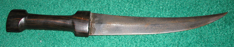

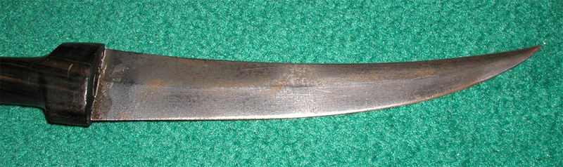

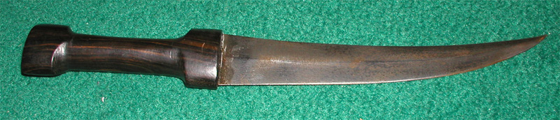

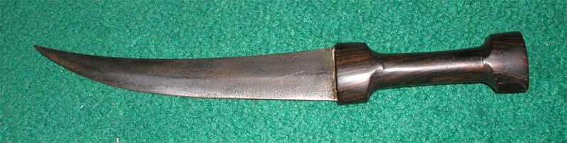

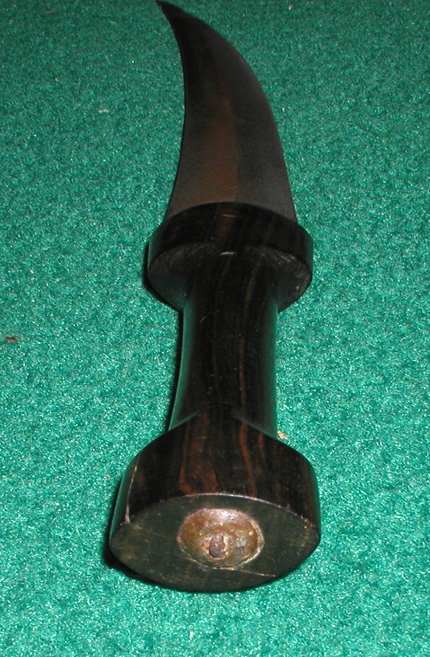

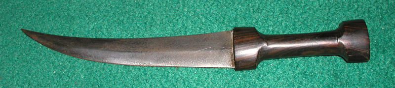

Hello All!
I just got this lovely jambiya that I think is late 19th or early 20th century. But I chould use some help on identifying the origen of this knife, I think it is either Albanian or Kurdish but I don't know for sure. Any comments are welcome!
Mark...

Iraqi, Kurdish.
Albanian (Arnaouti) are distinguished by deep diagonal counterpointing incisions in the inner corners of the handle.
Interestingly, Miller shows an identical one (Hermitage collection) from Georgia.
