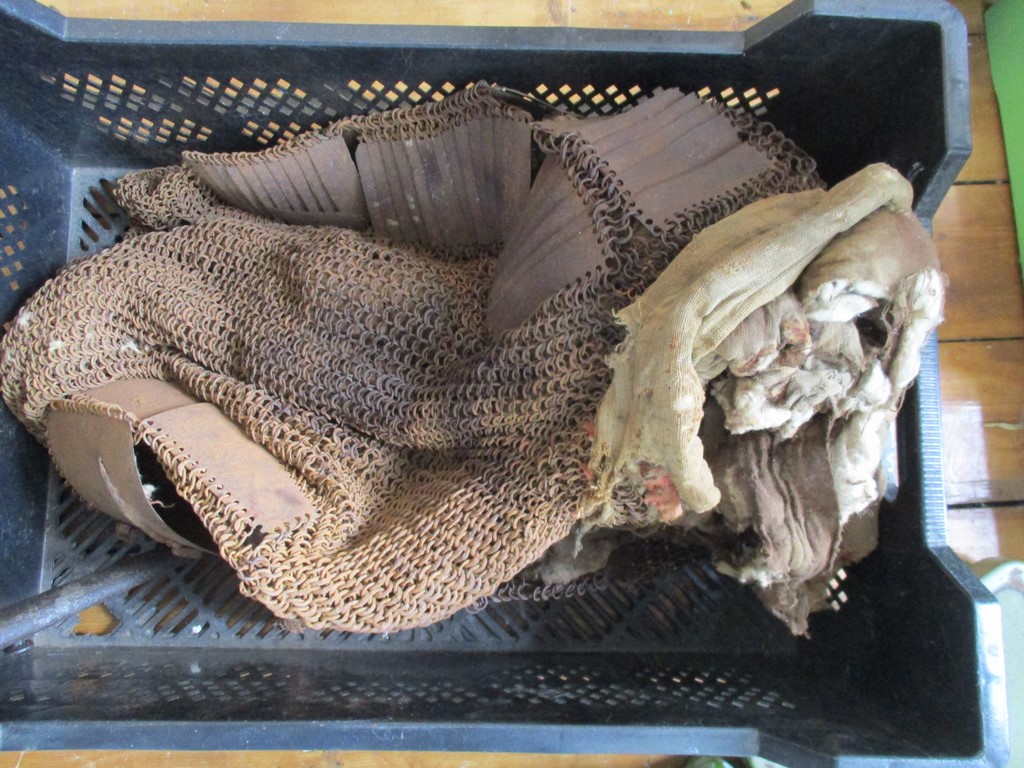

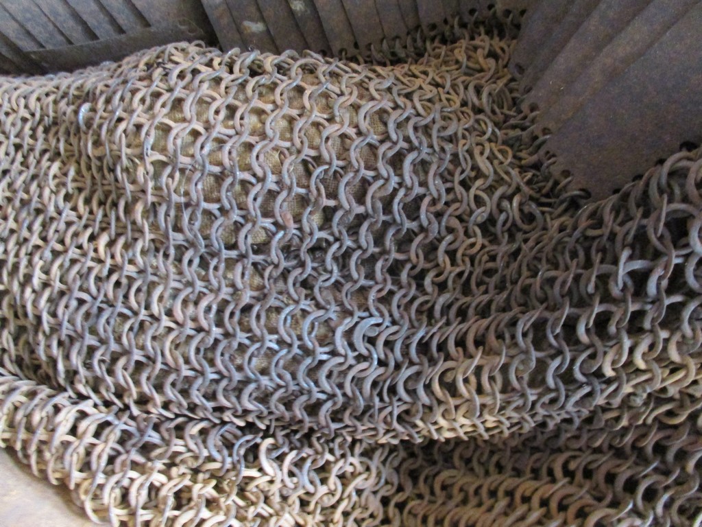

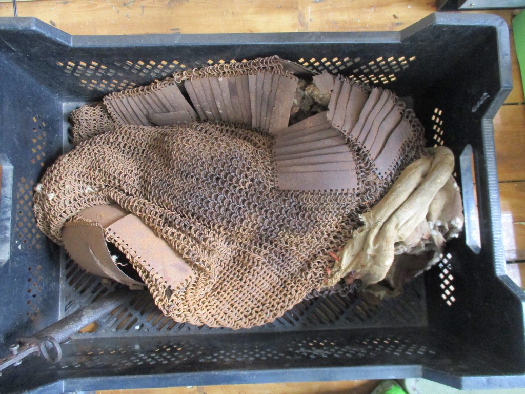

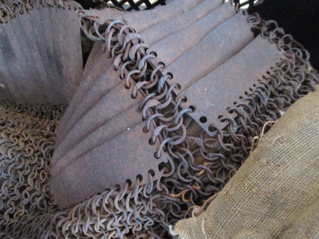

I have a potentially nice full coat of Indian riveted chain mail with most of its kapok padded liner intact . It is rusty but perfectly sound . I would like to both conserve it and enhance its appearance for display. Do any members have any tips ?

Hi
Lovely item well done on acquiring this item
Can you separate metal from the cloth liner
if so dry ice blasting is perfect for removal of rust without destroying platina
see below
https://en.wikipedia.org/wiki/Dry-ice_blasting

no it would not be practicable to remove the liner , sadly
You have a zirah baktar / zirah bagtar (mail and plate shirt. The lining is rare but most probably in bad condition. I know of only two reliable methods, chemical and electric rust removal. I have used the electro-rust removal method on a badly rusted riveted mail shirt with great results.
http://www.vikingsword.com/vb/showth...hlight=electro

It is not badly rusted just overall light surface rust ... my aim is to stop further rust rather than to bring it back to shiny newness ...... any less drastic suggestions anyone ?
If it has red rust it has to be treated, red rust is active. The methods I mention will not bring it back to "shiny newness", that would take sandblasting or tumbling, acid etc...something a bit more aggressive.

it is not red rust it has old brown rust .
If it is a patina then that is different than rust.

basically it is dirty with an ingrained layer of old brown rust powder and dirt .When that is rubbed off the appearance is so much better ... but how to do this on such a scale and should I be using wax or oil , soft cloth or abrasives or what ?
