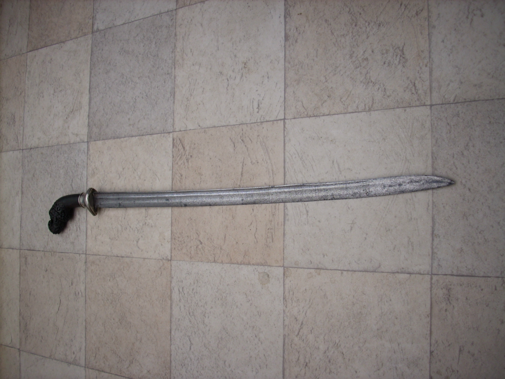

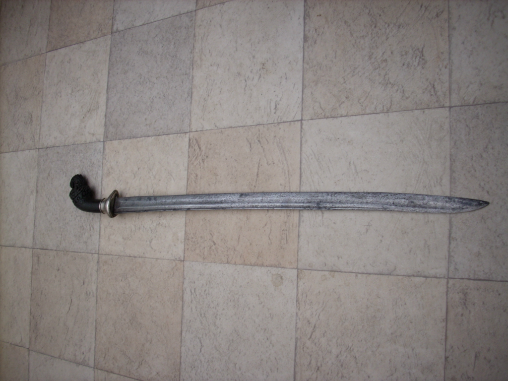

Hello Everyone, I need help in identifying the correct name, origin and age if possible of this sword. Unfortunately I don't have its scabbard and would appreciate an image of a simple one as I would like to attempt to make one.
The O/L is 36 ins with a 29 ins lg x 1.5 ins wide, twin fullered blade. I am not sure whether the hilt is horn or wood, I think the former, it is nicely carved at the pommel end and has a silver collar and guard. Thanking you in advance.
Miguel
Old 12th June 2017, 04:51 PM   #2
Post
Hello Miguel,
You have an interesting pedang (type 3 according to Albert vZ) and I believe there is some nice pamor peeking out. The blade looks a bit unusual but these hilts do come with a bewildering variety of blades!
Based on the hilt, I believe this example originates from Sumatra (other hotspots are Lombok and Banjarmasin).
I apologize: Good examples from Sumatra usually do come with quite a bit of silver on the scabbard, too...
The minimum would be nicely selected wood for the main body of the scabbard with horn mouth piece (and, preferably, horn tip).
Horn would be typical for these intricately carved Makara pommels; I can not verify from these pics though - any sharp close-ups?
Old 12th June 2017, 08:26 PM   #3
Hello Miguel,
agree with the most Kai has written but I personally think that it is a Lombok pedang, see for comparison here: http://www.vikingsword.com/vb/showth...ghlight=pedang You can see there also how a scabbard look, it's simple constructed, two wooden halfs with silver bands. Your pedang is missing the thin silver sleeve around the middle part of the handle. I think that the handle is carved from horn, such a fine carving points to horn. Agree also with Kai that a polish and traditional warangan will show the nice lamination from the blade. Nice piece!

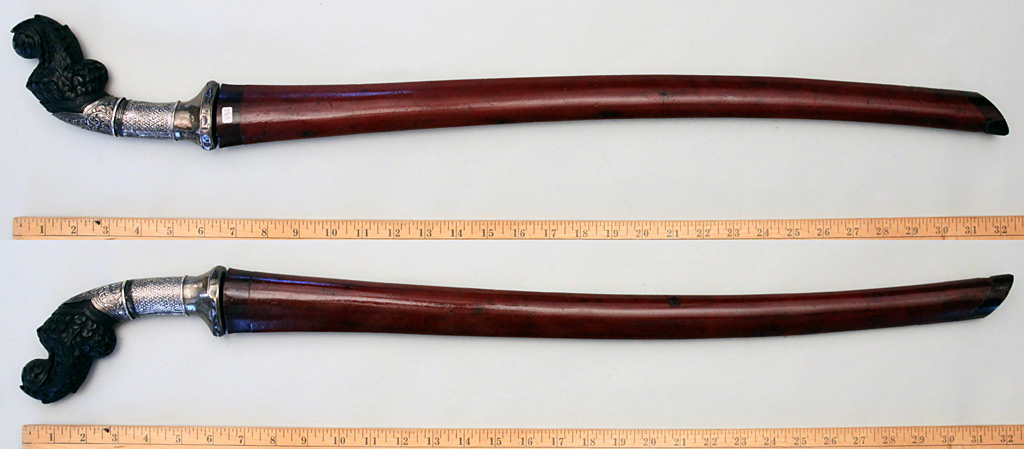

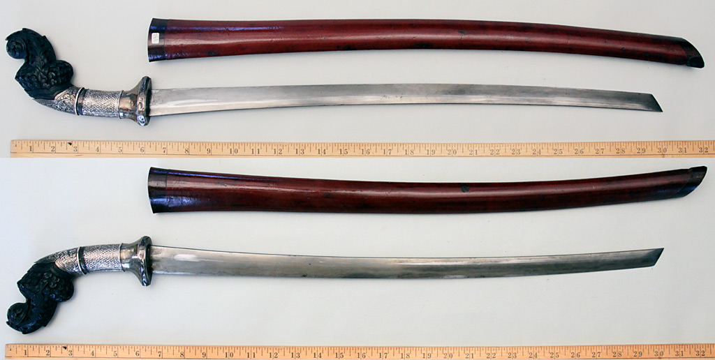

Here is one with a simple scabbard from Lew's collection:
Old 12th June 2017, 09:20 PM   #5
Hello Lee,
very nice example! Most examples I've seen coming with rather simple scabbards. In this thread are some other nice examples: http://www.vikingsword.com/vb/showth...ghlight=pedang

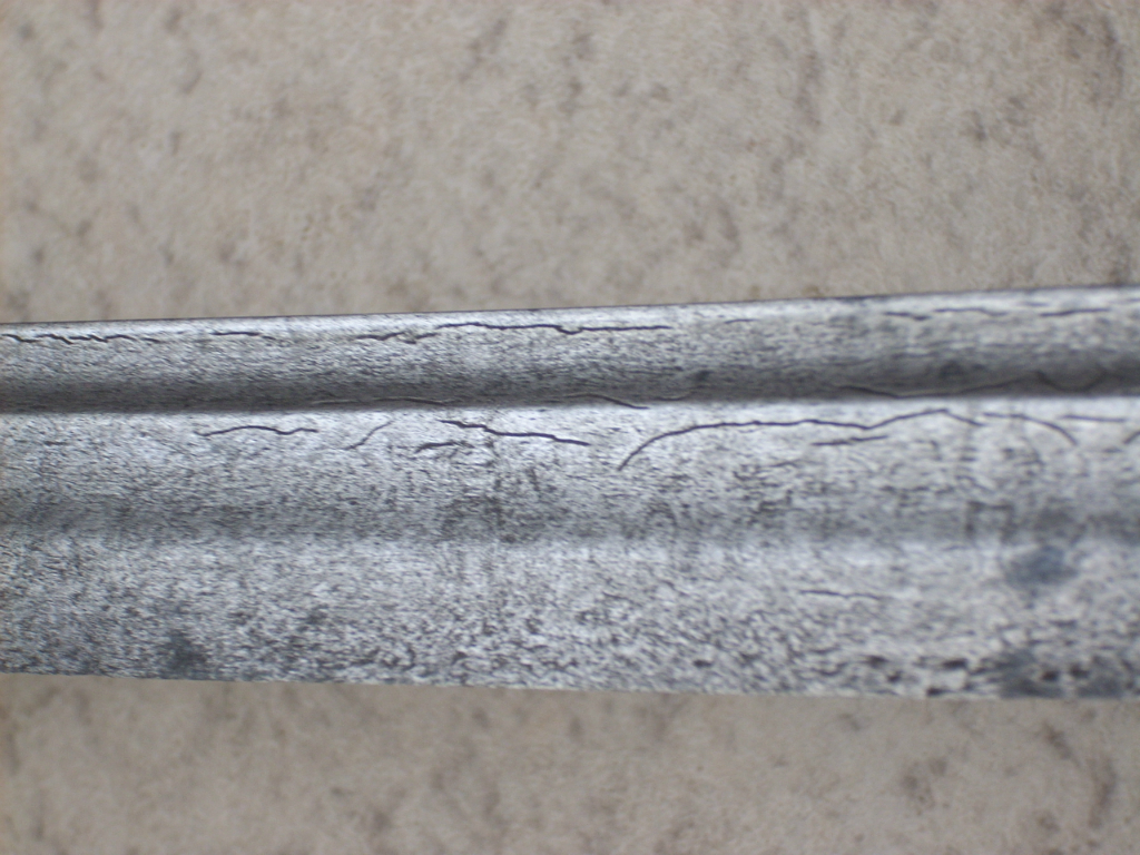

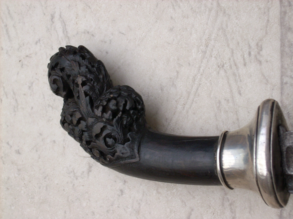

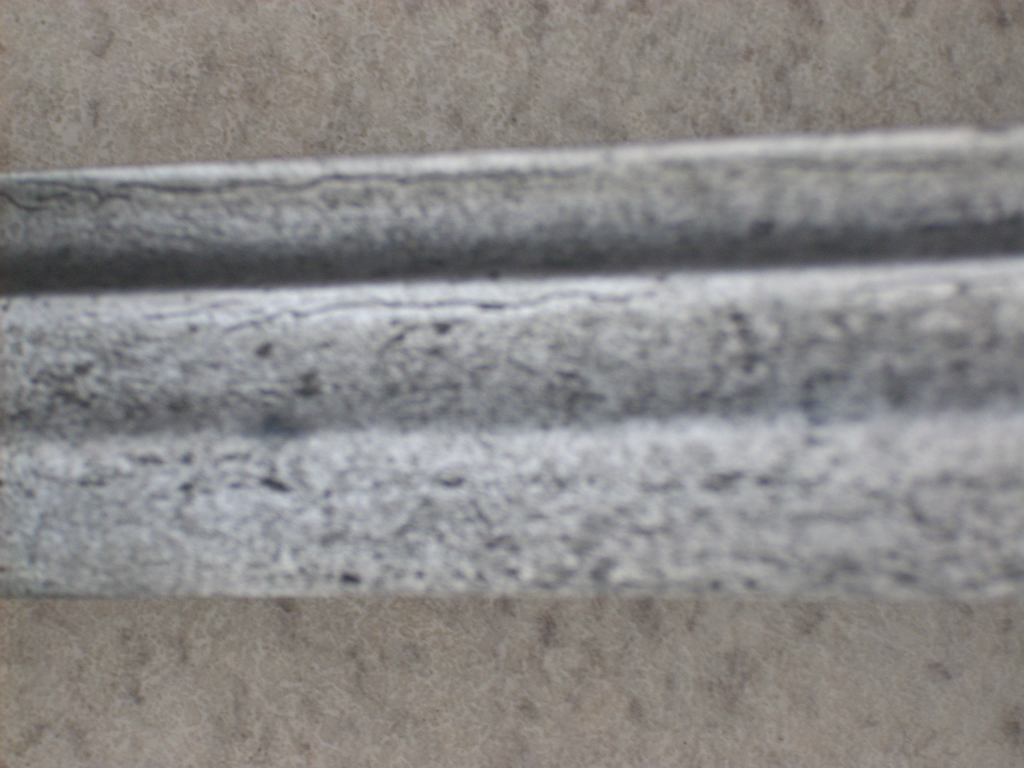

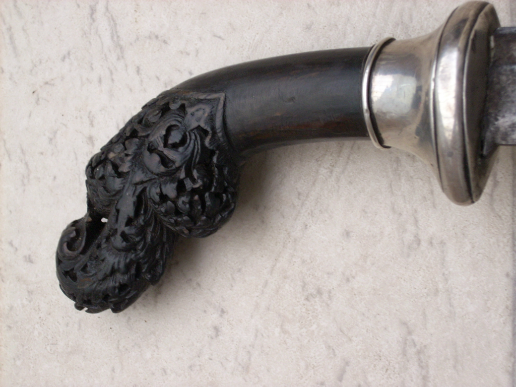

Originally Posted by kai
Hello Miguel,

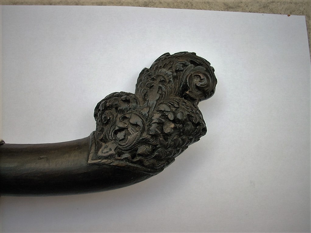

Hello Kai, pics as promised.
Miguel
Old 15th June 2017, 09:53 PM   #9
Horn!
Old 15th June 2017, 10:11 PM   #10
I agree with Detlef, that it's most likely horn. I am not ready to make a positive ID from these pics - some gentle cleaning, especially of the crevices, may be in order...
Still, what can be seen of the structure and the wear is consistent with horn which was most likely to begin with.

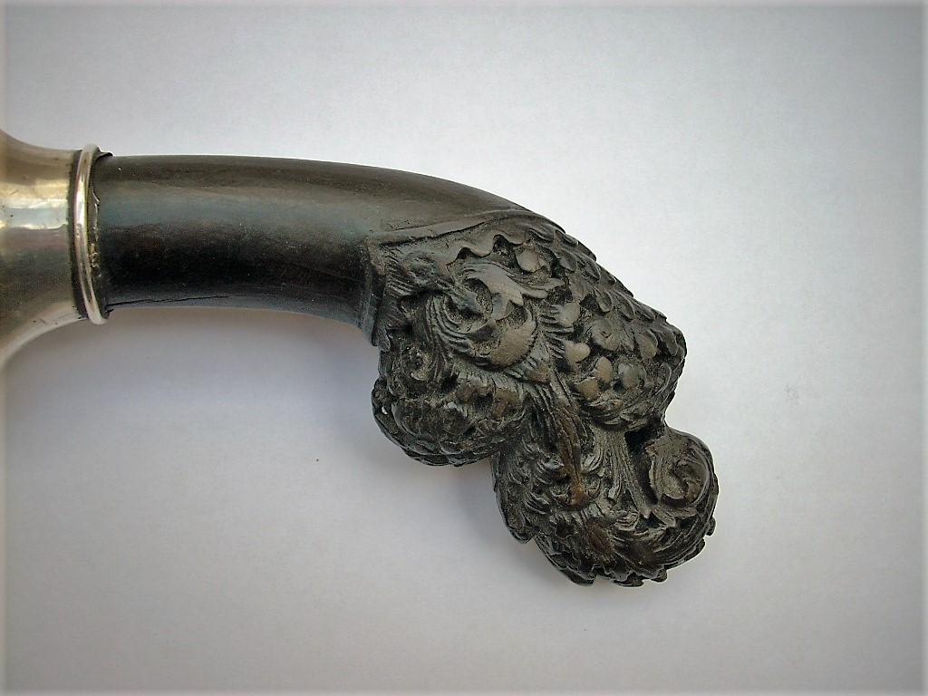

Old 7th October 2017, 09:11 PM   #11
Athanase
Athanase's Avatar
Join Date: Mar 2016
Location: Paris (France)
Posts: 432

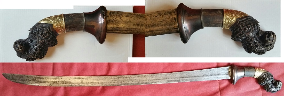

I have a very similar saber, also without scabbard.
The handle is in horn, covered with silver embossed and gilded, and a base in coper alloy (Suassa?). The blade, flexible, is made of laminated steel (or pamor?) and measures 77.5cm.
Overall length: 94cm
I wanted to know what is the red wood of the sheaths of the previous links?
