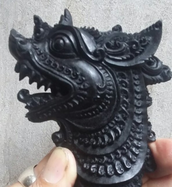

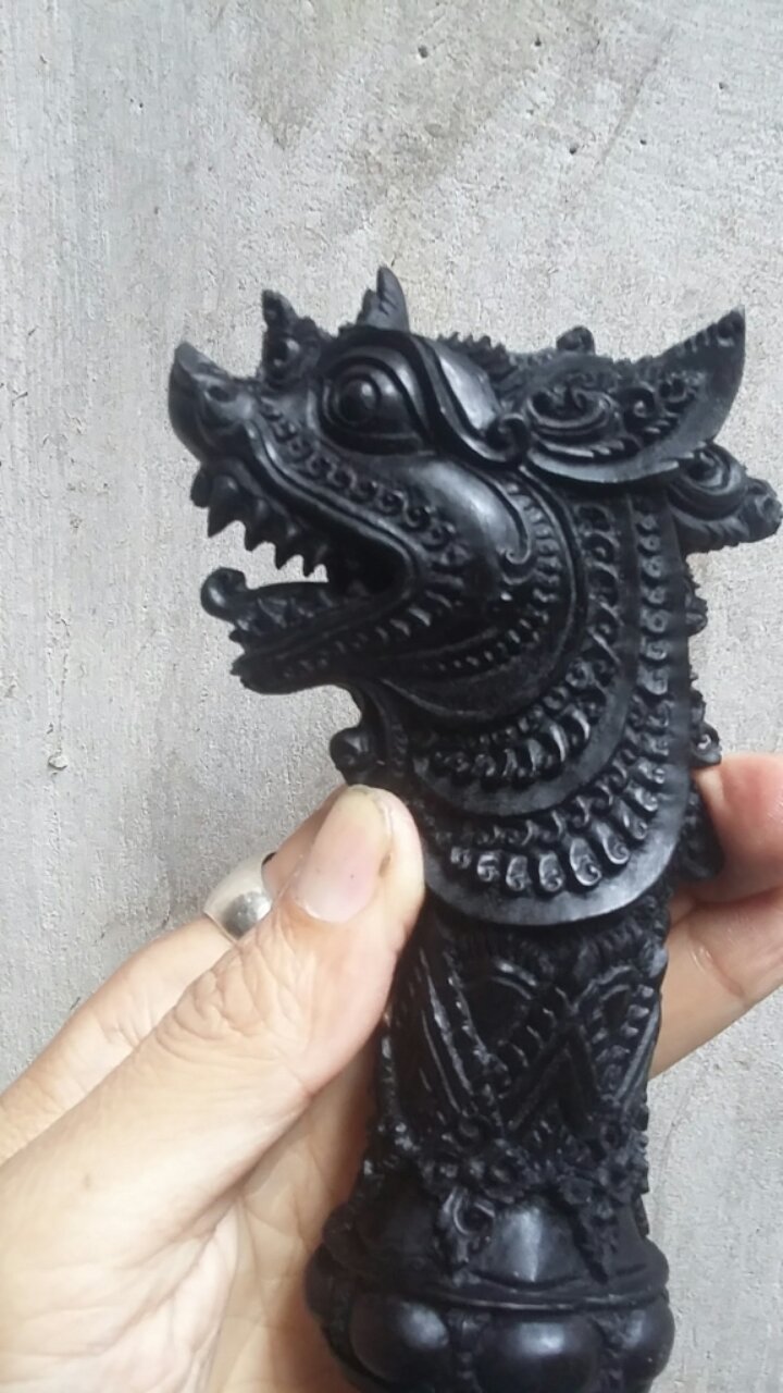

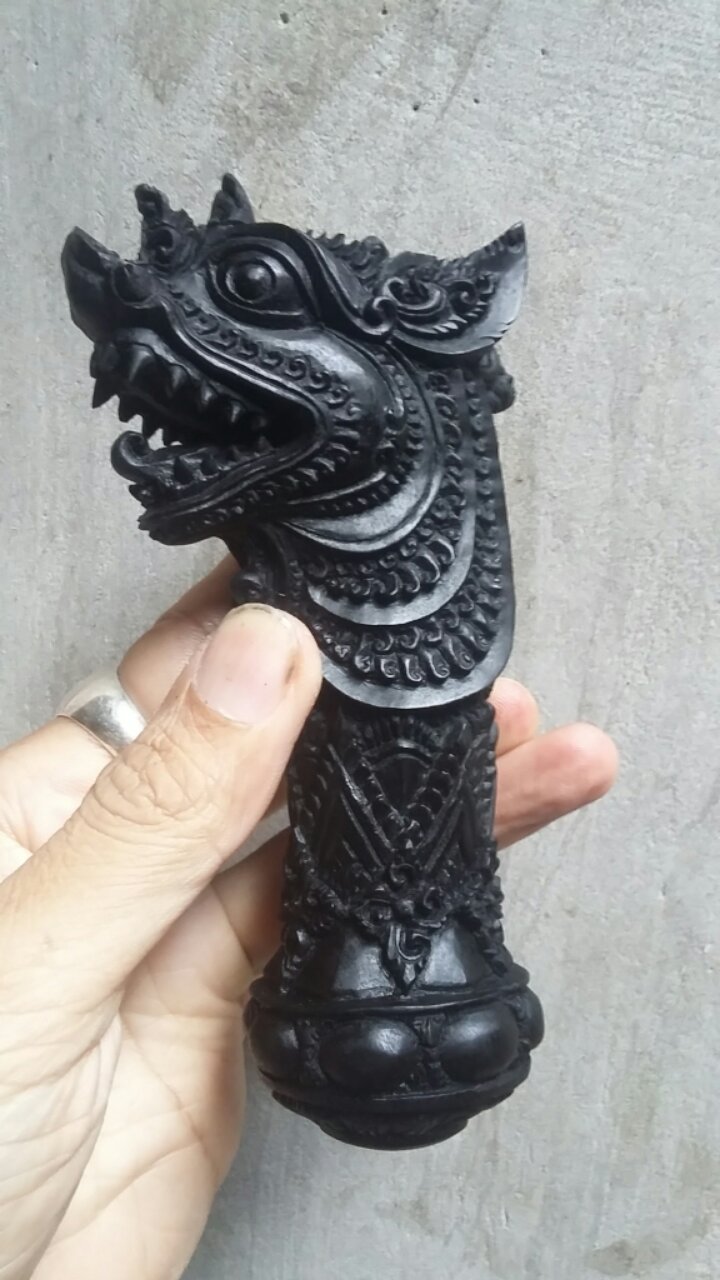

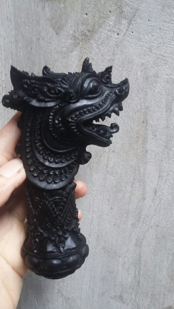

Pardon my ignorance. I just bought a handle that I think represent the Balinese Barong. I know that the fight between Barong and Rangda is a common theme in Balinese culture. Would like to seek forum members opinion on this handle.

Nice modern carving, but not a traditional design for a Balinese keris hilt AFAIK. You are correct that the battle between Rangda and Barong is and ancient depiction of the battle of good vs. evil and that the keris does indeed play a part in that battle as depicted in the Barong Dance that has become a staple of presentations mostly done for tourists these days.

Sinhalese lion on top, Madurese motif in the middle, Balinese selut, carwed in wood below.
So quite eclectic piece.

I agree completely that this handle does not use Balinese motifs, but I think it probably was carved in Bali.
The Balinese carvers are perhaps the best in the world, and in the current era they borrow forms and motifs from other cultures and societies. This is very good carving, it uses kayu arang (or ireng) which is commonly used in Balinese carvings. I think it is a very nice piece of current era Balinese art that has borrowed the motifs from elsewhere.
You're pretty good in identifying cultural origin of motifs, and you give the lion as Sinhalese. I am not disputing this, but my own feeling was more towards Siamese. Can you give a reference that ties this lion form to Ceylon?

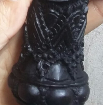

Alan, I also think that the carving of the lions head is of very good quality, with many small, crisp details, yet the parts below are not so accurate in execution. The difference is rather noticeable. And like you, I also suppose, it comes from Bali.

Re the lion head, yes, similarities, and I have seen these kastane hilts.
I don't have time at the moment, but I'll see if I can find some Siamese pics that influenced my feelings.
Re the variation of the motifs in execution, what I think I can see is perhaps a photo problem. This thing might look a bit different in the hand.

The best picture technically is the first one. The difference in carving quality between the parts to me seems noticeable.

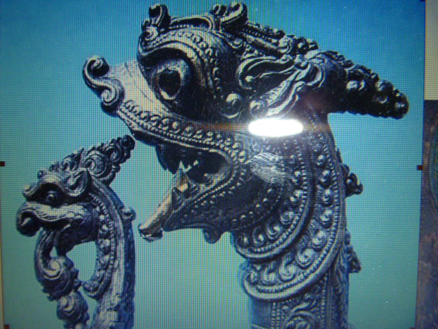

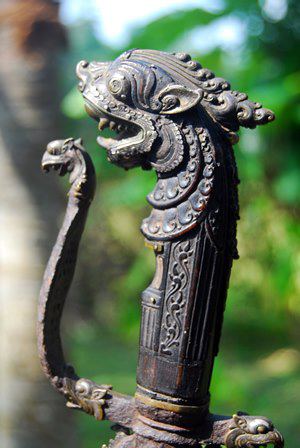

Of course, the lions head isn't exact copy of a Kastane, that surely wasn't attempted, and isn't possible (see Malayan and Indonesian Tajong hilts). Yet the model for it with some certainty was a Kastane handle. If the model was a picture of a Kastane (most likely), the similarity, of course, will be the greatest in profile.

I was thinking the same thing about the mix and Sinhalese lion attribution.

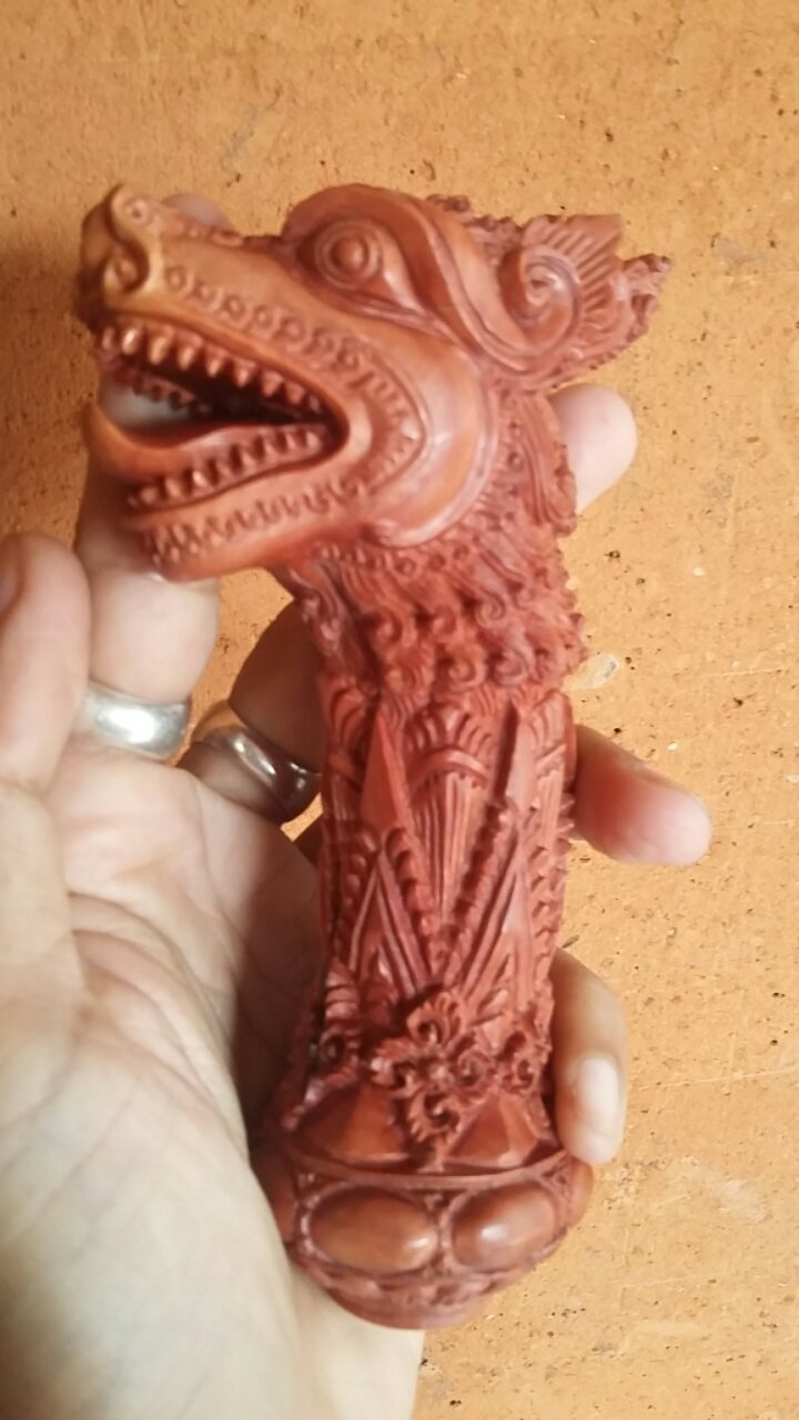

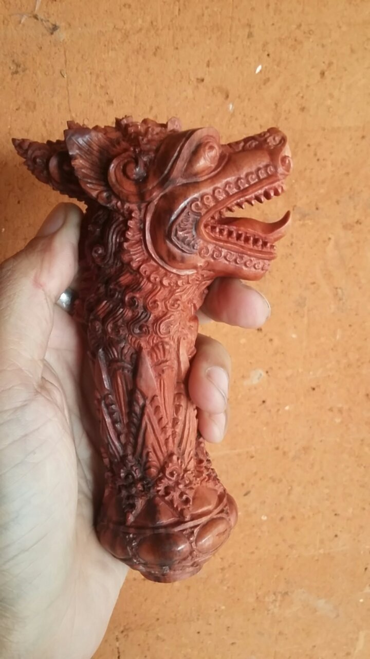

Dear forum members,
Thank you so much for all your insightful comments. Now I understand where the design of my barong handle came form.

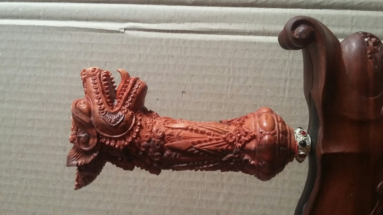

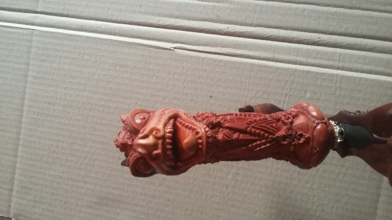

I also enclose pictures of another handle that I had earlier bought from the same dealer in Bali at a slightly cheaper price.
Not sure whether it resembles a lion or dragon? Perhaps it is also inspired by the Sinhala kastane sword?

Old 22nd July 2017, 09:26 AM   #10
Posts: 7,263
Yes, there is a noticeable difference in sharpness of detail between the head and the body of the hilt, but before I put it down to execution I would need to have it in my hand.
Balinese carving is rarely the work of a single person, it is usually a group effort, with people of varying degrees of skill being assigned different asks in completion of a whole, so what we are seeing here could well be because of that group involvement. Something to be expected, that does not speak against Balinese origin, but rather gives weight to that opinion.
Still, for me I still have a question in my mind about the lion head. Yes, there is similarity with that well known kastane for. No argument. But browsing pics of other SE Asian art works does not yet convince me that the model for that hilt was of Ceylonese origin.

Alan, I am not sure if we could find an SEA art work with greater likeness to it then the lions head on a Kastane handle.

The kastane is a Sinhalese (Ceylonese) weapon.
In old Sri Lanka it seems to have been primarily from the Kingdom of Kandi.
Kandi was Buddhist.
The Sinhalese people have a long association with lion symbolism, I believe a lexicographer would find that the very name of the people themselves comes from the word "sinha" or "simha" which comes from "singha" = lion.
In Sri Langka the name used for the Chinthe is "Simha", just as in Thailand the name used for the Chinthe is "singha", and this is where the confusion in calling the kastane pommel a "lion" originates. It is called a lion because the name of a Chinthe in Sri Langka is the same word as is used for a lion, but the artistic representation of the pommel is only the head of a lion.
The body of a lion and the body of a Chinthe are really very different:- one is an animal, one is human with a lion head.
If we consider the lion head on the kastane pommel in the context of weaponry from the region there are at least two possible interpretations. If interpreted as lion it becomes linked to the Sinhalese people as a whole, and perhaps to the warrior caste in particular. If interpreted as a Chinthe it becomes protective.
Possibly, as with much of symbolism from South and South East Asia, we have multi symbolism in play in this matter. That is to say that the symbol of the lion's head can be read in different ways dependent upon context. Even a weapon itself is not always just a weapon.

Now, with some delay we see another, similar hilt, in post #9. Seeing this hilt, I never would come to the idea the model for it would have been a picture of a Kastane pommel. It's something completely different - stylistically, and my analysis was only a stylistic one.
We have had a huge and in many aspects quite interesting and entertaining thread on our Forum (and a related entry in Wikipedia, which have seen many labour pains) about what the Kastane pommel depicts. I have not the slightest interest to step again in those waters. Yes, I also am acquainted with SEA temple guardians from books about SEA art and architecture since my childhood. I surely wasn'nt there, when the hilt from #1 was carved, yet it's absolutely obvious that the carver's model was a picture of a Ceylonese Kastane pommel. So a second attempt to be more clear:
Srilankan Simha (සිංහ) on top, Madurese motif in the middle, Balinese selut, carwed in wood below.
A quite eclectic piece.
Yes, and the carving quality is quite inconsistent.
