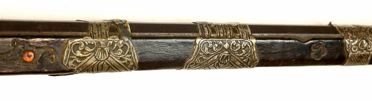

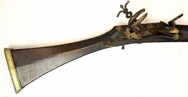

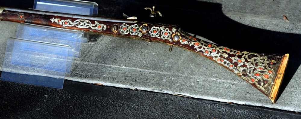

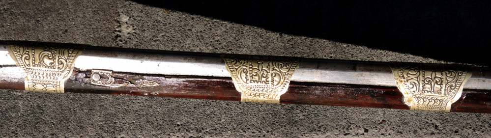

A recent addition to my collection is this Algerian Miquelet Kabyle Smoothbore Musket. Bore is approx .50. Probable age mid 19th century.
Profusely covered with nice inlaid very thin brass decoration and corals. Unfortunately some of the decoration has been lost over time, but the majority remains.
Comments welcome.
Stu

Well well well it's a pure beauty.
The most typical Algerian rifle, in very good condition.
If you don't have the book Gold and Coral, you should buy it immediately.
You will see plenty of them, exactly like yours...
I think that the lock was decorated and some brass or silver is missing.

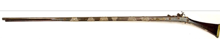

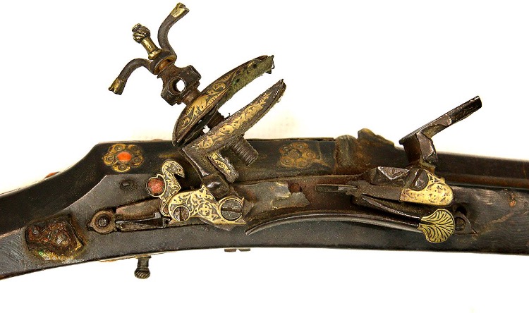

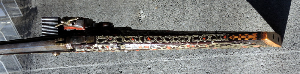

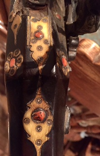

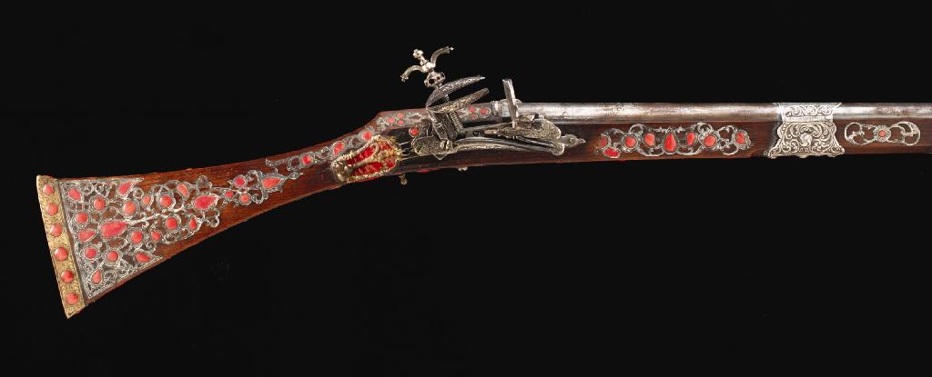

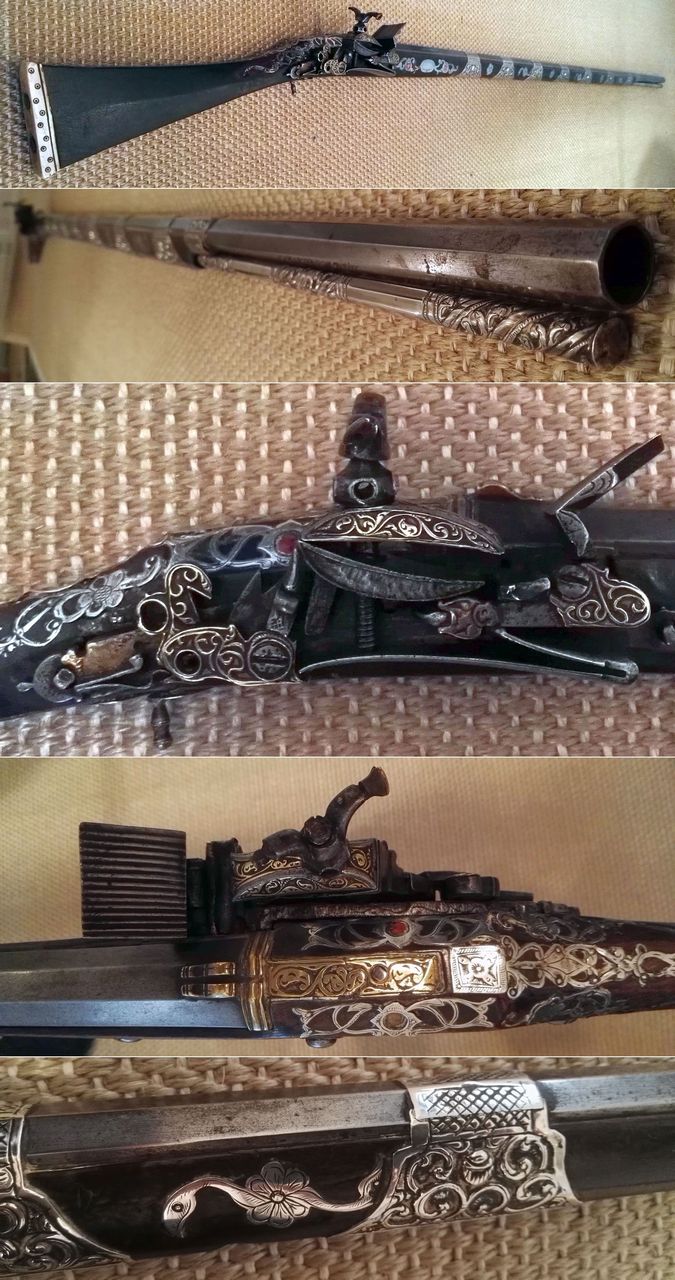

Another Algerian ... A toe Lock ...Perhaps someone can tell me the difference ?
Placed to emphasis the decorative coral technique (similar to the one above) on Algerian weapons...
Described as AN ALGERIAN SILVER-MOUNTED TOE-LOCK MUSKET, SECOND QUARTER OF THE 19TH CENTURY with engraved barrel retained by five silver bands repous,e with scrollwork, fitted with silver back-sight and with a further band of silver over the breech, iron lock inset with chased silver panels, cut with a brief numeric inscription beneath the cock (possibly including the date 1259 A.H. for circa 1843/44), retaining its embroidered silk hand-guard, figured hardwood three-quarter stock inlaid with a running pattern of silver foliage enriched with coral leaves over its full surface, three engraved silver flowerhead side-nail washers, engraved brass butt-plate inlaid with coral en suite, and wooden ramrod with large silver tip matching the barrel bands 92.4cm; 36Gin barrel. From http://www.thomasdelmar.com/Catalogu...1205/page2.htm Auctioned more than 10 years ago.
On the subject of Coral Decoration please see http://www.vikingsword.com/vb/showthread.php?t=19669 at # 25.

Default "toe" locks

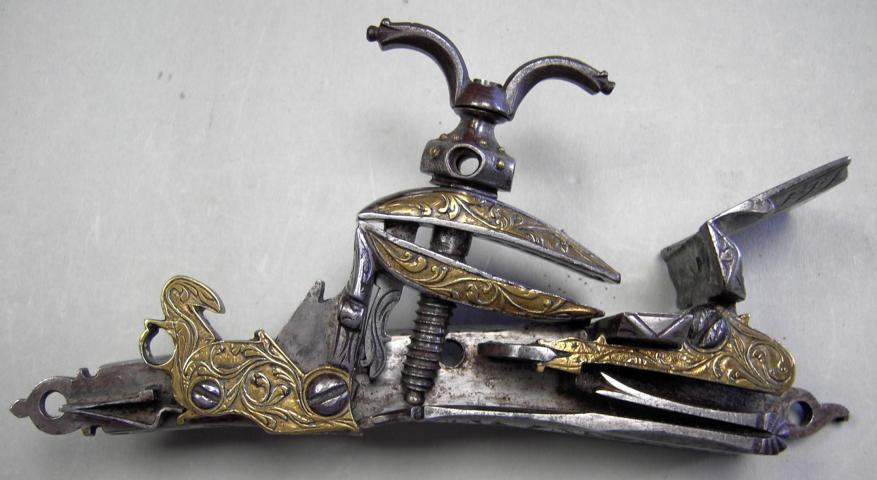

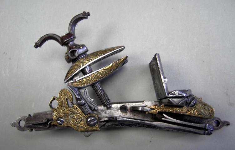

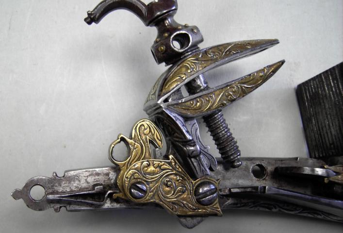

The term "Algerian toe lock" is often applied by collectors to these mechanisms, but in actuality, this is something of a misnomer. For one thing, locks powered by an external mainspring that pushes DOWN on the "TOE" of the cock are not restricted to Algeria; the common "focile alla romana" of central Italy and the locks found on a number of 17th cent. French and Austrian breechloaders also share this characteristic.
Spain is the birthplace of the external-mechanism flintlock systems common to much of North Africa, the Ottoman Empire, the Caucasus, and Iran. In most places, it is the "patilla" (little foot) or "a la española" type that is characteristic; the mainspring pushes UP on the HEEL of the cock and the sear (linkage between trigger and cock) system is more direct and robust. These are commonly known to collectors as "miquelets", which arises from a 19th cent. neologism.
The Algerian lock, also of Spanish origin, is an interesting exception not only mechanically but developmentally. Its antecedent is a short-lived Spanish type called "agujeta" because the sear arrangement consisted of elongated pivoting bars with ends that went through holes in the lockplate and were thus likened to needles. (J D Lavin, "A History of Spanish Firearms" (1965) pp 170-172, also "Spanish Agujeta-lock Firearms" in ART, ARMS, AND ARMOUR (ed Robt Held, 1979). In Spain, the agujeta was in vogue only for the latter half of the 17th cent., disappearing by the early 18th, but enough of them must have made their way to al-Maghrib to become popular if not iconic in Algeria through the end of the 19th cent. Stylistic similarities, including elongated cock jaws, wing-shaped jaw screw finials, shape of priming pan bridle, outsized mainspring, and a dog catch safety hook are obvious. The Algerian version tends to be larger than the Spanish, and has a somewhat simplified sear which nonetheless does not make it more reliable since many existing specimens no longer function well.
Spanish authors of the period were not fond of this system, pointing to the weakness of the sear mechanism and the difficulty of maintenance and repair.
Mechanically-inclined readers can look at an exploded diagram of an agujeta sear linkage in Lavin, "History..." p 172, and compare it with the Algerian version in H Blackmore, "Guns and Rifles of the World"(1965), diagram p 115.

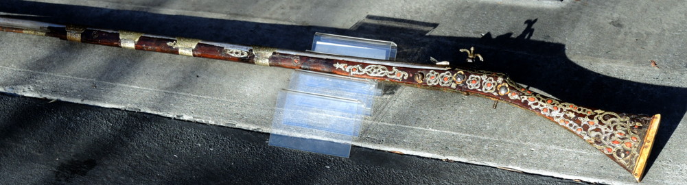

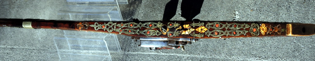

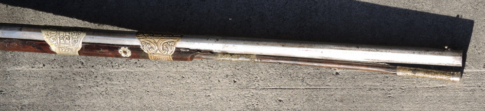

HI STU
HERE IS MY KABYLE MUSKET WHICH I HAD POSTED SOMETIME BACK ,HAS LESS CORAL DECORATIONS THAN YOURS BUT ITS VERY LONG ,REGARDS

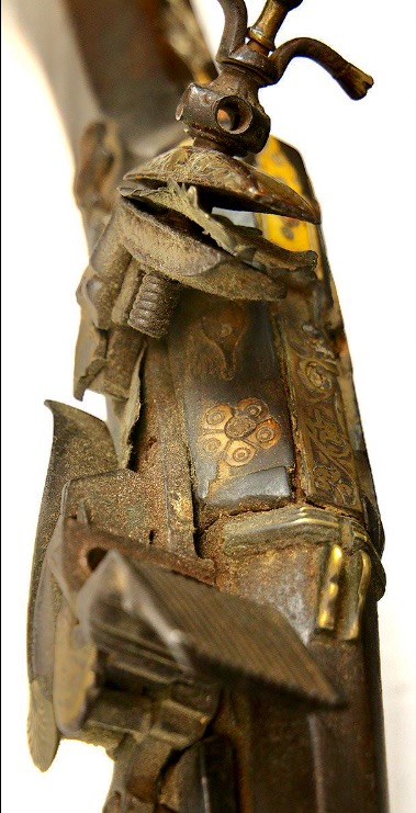

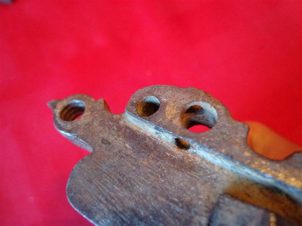

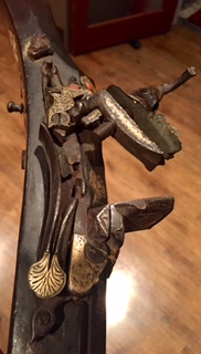

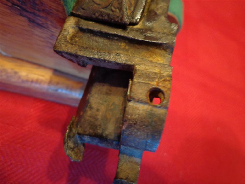

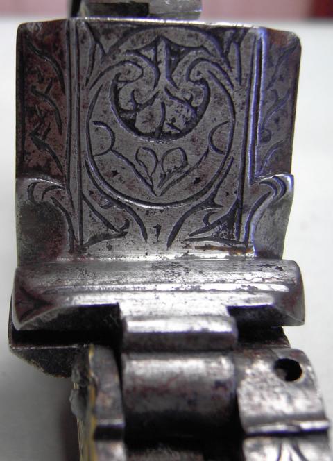

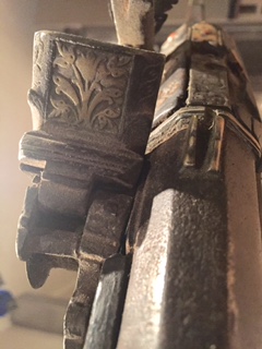

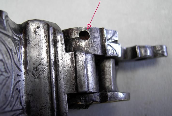

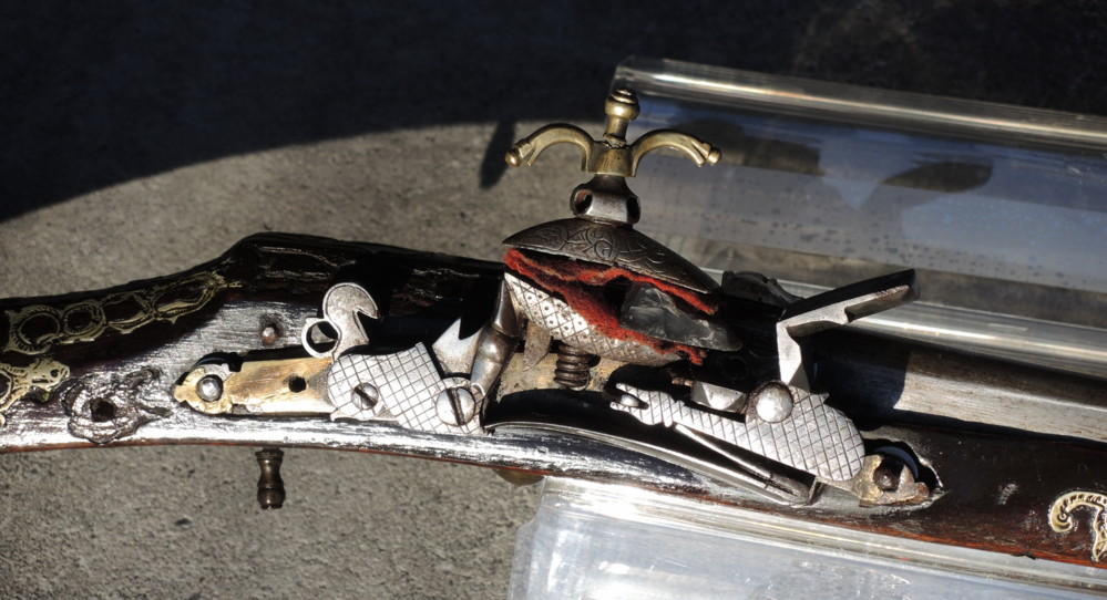

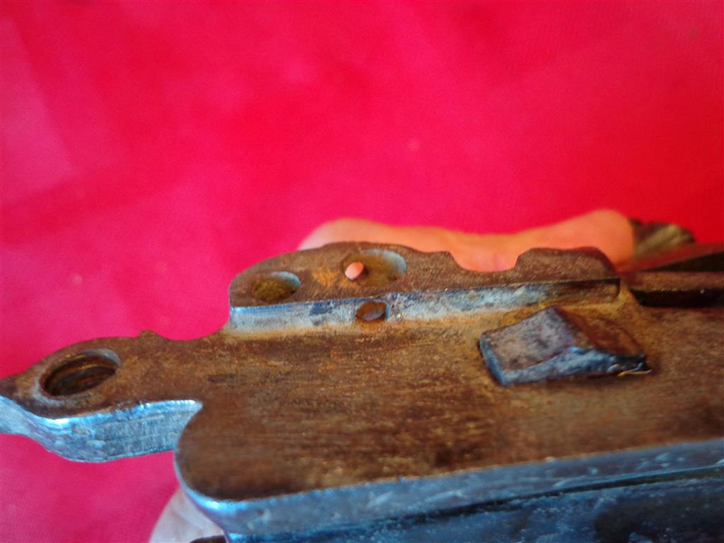

The lock of a moukhala has details that give me reason to ask some questions:
When the battery is closed there is a remarkable gap between pan and the battery what is not explainable for me. As far as I know there have no parts of the lock been replaced so that I am convinced that the battery is the original one. But why this big gap? In my foto archive I have some more pictures of locks of the same type that show the same gap. Does anyone know the reason for this gap?
When the battery is closed one can see a small hole with a diameter of ca. 2mm and a depth down to the screw that fixes the battery. What is this hole made for?
Old 25th June 2017, 07:40 PM   #18
rickystl
Join Date: Jul 2010
Location: St. Louis, MO area.
Posts: 1,633
Hi Corrado.

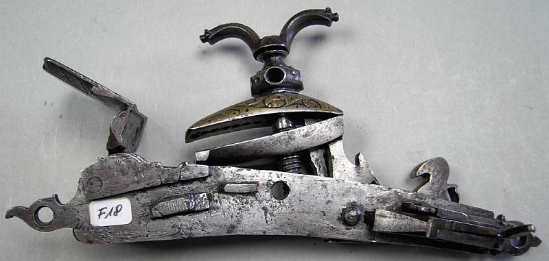

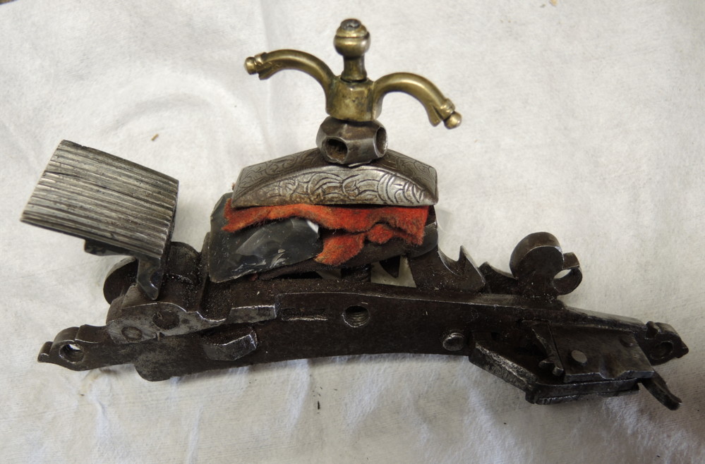

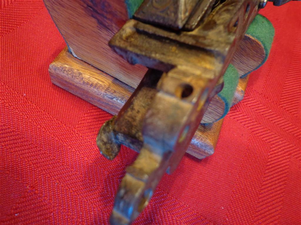

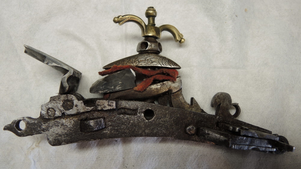

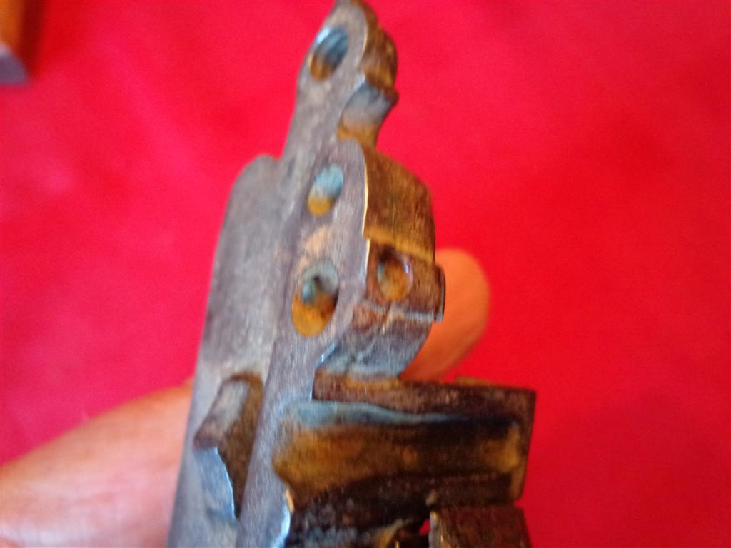

That's a nice looking Algerian lock. I think I may be able to help. At least partially. I looked at all of my Algerian locks. And all have this hole, but with a tiny pin in the hole. I've never really noticed this until now. There is also a smaller hole on the bottom of the frizzen screw area opposite the hole on top.
Here is a "parts" lock I have. It appears what we call a frizzen "screw" is not really a screw. Even though the screw on the outside has a slot for a screwdriver, there are no threads in the hole where the frizzen screw seats on the inside of the lock.The one pic below explains it better. So for this conversation we will call the frizzen screw a frizzen "pin". LOL It appears that the tiny pin on yours is missing. Look close and see if there is a smaller hole on your lock below the frizzen pin area like the photo below. I'm guessing that if the frizzen pin is removed there would be another hole in the pin itself. Honestly, I've never taken on apart at this area to find out. That would be three holes total. My guess is that once the frizzen pin was inserted, a hole was drilled all the way through the top, pin, and lower area, and a tiny pin inserted what is now three holes, to keep the frizzen pin itself from working it's way out. So, if your tiny pin is missing, you can probably take a punch and small ball peen hammer and knock the frizzen pin out.
You would think it it would be much easier to simply thread the end of the frizzen pin and the hole in the lockplate, like the hammer screw. I can only speculate the reason for doing it in this matter. It seems they avoided making "threaded" screws or holes whenever possible, especially small screws. But the frizzen pin is not really small. Curious.
The last photo you posted, it does seem that the frizzen is sitting just a bit high in the cradle. Hmmm. Maybe the frizzen pin is slightly bent (?). This, possibly due to the tiny support pin missing (?).
If the tiny pin is missing, and the frizzen pin slightly bent, that could account for this gap between the frizzen cover and the pan. Actually, an easy fix - by the right gunsmith. All the frizzens on my Algerian locks close as normal. But they also all have the pin still in them.
Hope this helps. Let me know.

Hi rickystl,
your theory is quite good and I tried to get out the bolt that holds the battery but it was not possible. The "screw" is not turnable because of rust but I think it is as you said. There has been a pin that secured the bolt.
Best regards
corrado26

Default retaining pins (fieles)
The little hole was indeed intended to receive a locking-pin ("fiel" , in Spanish) intended to keep both the pan-cover and cock pivot bolts secure once they were tightened during assembly. Alonzo Martínez de Espinar, in his 1644 treatise ARTE DE BALLESTERÍA Y MONTERÍA, wrote:
"Fieles...are similar to headless nails, that notwithstanding the fact that the threaded screw retains and adjusts the cock, and battery, to the [lock]plate, after being adjusted the screw is drilled through its very threads, and being in place... the fiel is inserted in order that it always remain secure, and adjusted."
James D. Lavin, in A HISTORY OF SPANISH FIREARMS (1965), notes that on early miquelets other screws were secured with fieles as well. The use of these pins began to disappear (in Europe) during the 18th cent., probably because of more precise thread-cutting on screws, and, as Lavin points out, the tremendous pressure of the mainspring against the cock was sufficient to prevent its screw from rotating or backing out. The lighter spring providing tension on the pan-cover/battery made the fiel more necessary and it was the last to disappear.
So, it would not be unusual to find the used of these retaining pins on Algerian locks, considering that they derive from 17th cent. Spanish (Catalan, to be more precise) antecedents. Their continued use on these locks probably speaks to technical conservatism and the relatively poor quality of thread-cutting often found in locks made in the Islamic world.
The complete lack of threads on the battery pivot-bolt of the lock under discussion is an interesting manufacturing shortcut. With a fiel holding it in place, there is no reason why it shouldn't perform as well as a threaded screw. Interesting to note that pre-modern cultures in the East have shown an aversion to threaded screws in mechanical assembly despite their generally high level of metalworking skills. Indian firearms in general don't tend to use them, and an extreme absence of screws is encountered in guns from Japan, Korea, and the Malay Archipelago -- everything is held together with mortises, unthreaded bolts retained by fieles, and by sheer friction. Firearms from China and Vietnam are an in-between, with the better examples containing screwed components as early as the 18th cent., but this may well be the result of Jesuit technical influence (Peking, 17th-18th cent.) and French and Portuguese expat artisans (Annam, 18th cent.).

Default trouble-shooting gap between pan and cover
This seems to be an anomaly, the space is pretty big, it almost negates the purpose of the pan-cover as a means of retaining the fine-grained priming powder in the pan!
Like Rick, I've handled my share of Algerian locks, varying from masterful to crude, and on all of them, the pan cover fit was adequate. Could it be that the problem here might be a pivot bolt (or its corresponding hole in the pan-cover) having suffered excessive wear so that the upward pressure of the battery-spring would tend to lift it clear of the pan? If you applied pressure to the pan-cover when the unit was closed, and it moved downward to meet the pan, that might be the problem.
In general, I find that the overall fit and finish of these Algerian agujetas is pretty darned good. At least when you compare their build quality to most of the Moroccan snaphaunces. The mechanical failings of the agujeta seem to be more a matter of engineering and perhaps premature wear from dicey heat treating. The criticisms of 17th cent. Spanish writers (mentioned in a prior post) point to a problem with the design that was apparent centuries ago.

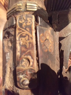

corrado26
Hi Corrado.
Your lock appears in otherwise good condition. So I don't think it is a case of rust. It seems at some point the fiel (thanks Philip) broke. While the upper half of the fiel is missing, the lower half may still be intact. This, combined with the frizzen pin itself being slightly bent is probably why the pin won't remove. Hmmm. You could take a tiny 1/16" (1.5875mm) drill bit and try drilling where the existing hole is and see if if will drill all the way through. Then you may be able to remove the frizzen pin (?).
Meantime, I'll try this myself on one of my parts locks. Would be interesting to see what the end of the frizzen pin looks like. LOL

Hi Philip.
Thanks so much for the information and insight. I always learn something from your comments. LOL
Yes, it's interesting the Eastern gunmakers aversion to using threads whenever possible. The Indian and Japanese matchlocks come to mind. The entire gun was built without using a single screw. And when you do find threads, they are not done as well as their European counterparts. As you mention, it's curious considering their otherwise high level of skill in metal working.
And as you mention, the Algerian locks seem to have design cues from the mid-17th Century. Unless marked, the lock could have been made in 1650 or 1850. LOL Hard to believe they were still being made and used for this long.
And the Moroccan snaphaunce design dates from the late 16th to early 17th Century. Change came very slowly in this part of the World.
Algerian Lock: I believe the screwdriver slot on the frizzen pin is so the three holes could be re-aligned should the frizzen need replaced or other maintenance to the lock.

Here is one that has not been seen before as far as I know.
Old 3rd July 2017, 07:36 AM   #27
corrado26
corrado26's Avatar
Join Date: Dec 2014
Posts: 1,266
what a wonderful piece

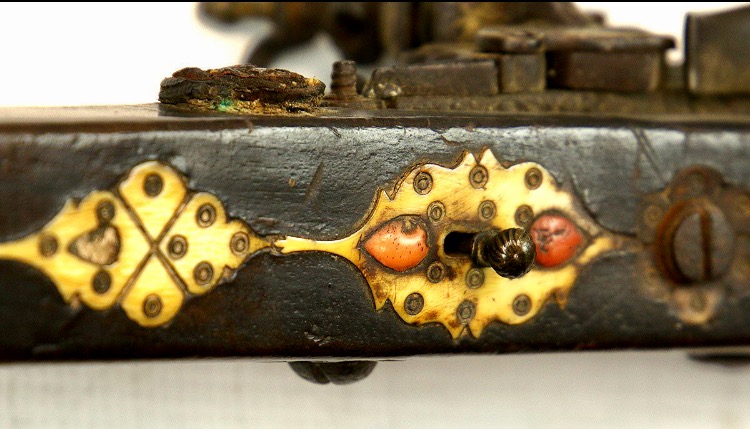

I second that comment!! Wonderful piece. I especially like the decorated IRON ramrod. Obviously made with the gun. Usually the ramrods are wood. Often with the fron third wrapped in brass.
A couple other interesting items on these Algerian long guns. The stocks are made only 2/3rds length, and the lock plates are only about half way inlet into the stocks. And every one I've seen are built this way.
