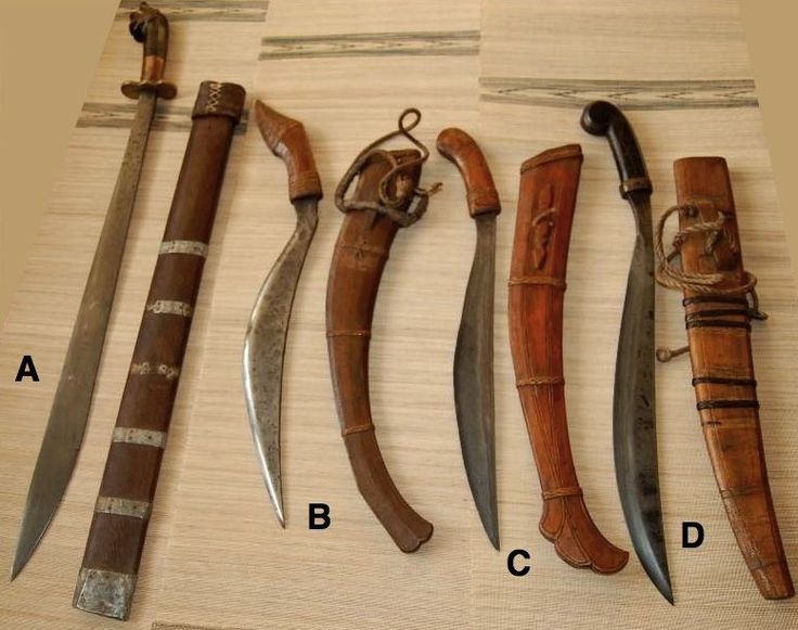

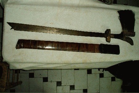

The picture of the kampilan from the unidentified kampilan thread is still in question on whether it may be of visayan origin or moro. Although the fact that its made from carbonated steel speaks against it being Visayan, any thoughts as to whats the origin of tribe and date?
The second picture was taken from Wikipedia, the measurement of the blades aren't listed but I was wondering if anyone has ever seen a "ginunting" like that before (the biggest one)?

Hi Maharlika:
Welcome to the forum.
With regard to the ginunting that you show, it is really hard to assess its size because there is no scale for comparison. Also, the camera angle may be accentuating its apparent length.
In my experience, I have seen ginunting of 25-28 inches in length but I don't recall anything longer than that. I don't own an example that long, but I have handled such long versions.
Ian.

Originally Posted by Ian
Hi Maharlika:
Ian.

It is true, the angle could possible make the sword like bigger in length. However in regards to the kampilan above, it seems the specimen is still up to debate on whether it is a Visayan piece.
It is apparent to me that the animist Visayans don't seem to have the same level of advances in comparison to their south east asian brothers including the moros. They seem to have the sophistication in terms of weaponry and architecture as the Papuan people.
I have yet to see a sword that rivals the laminated steel and height of the 3 foot swords used in Indonesia and Mindinao.
