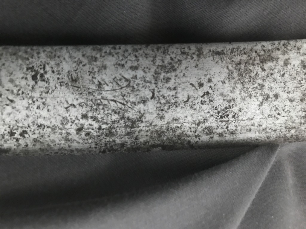

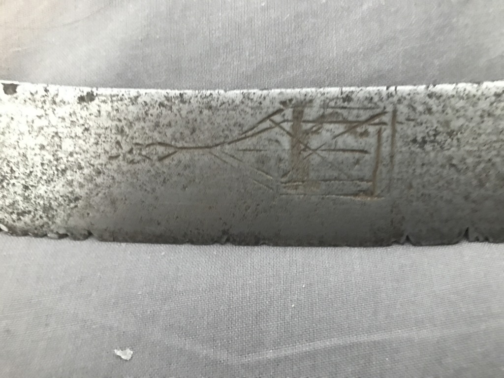

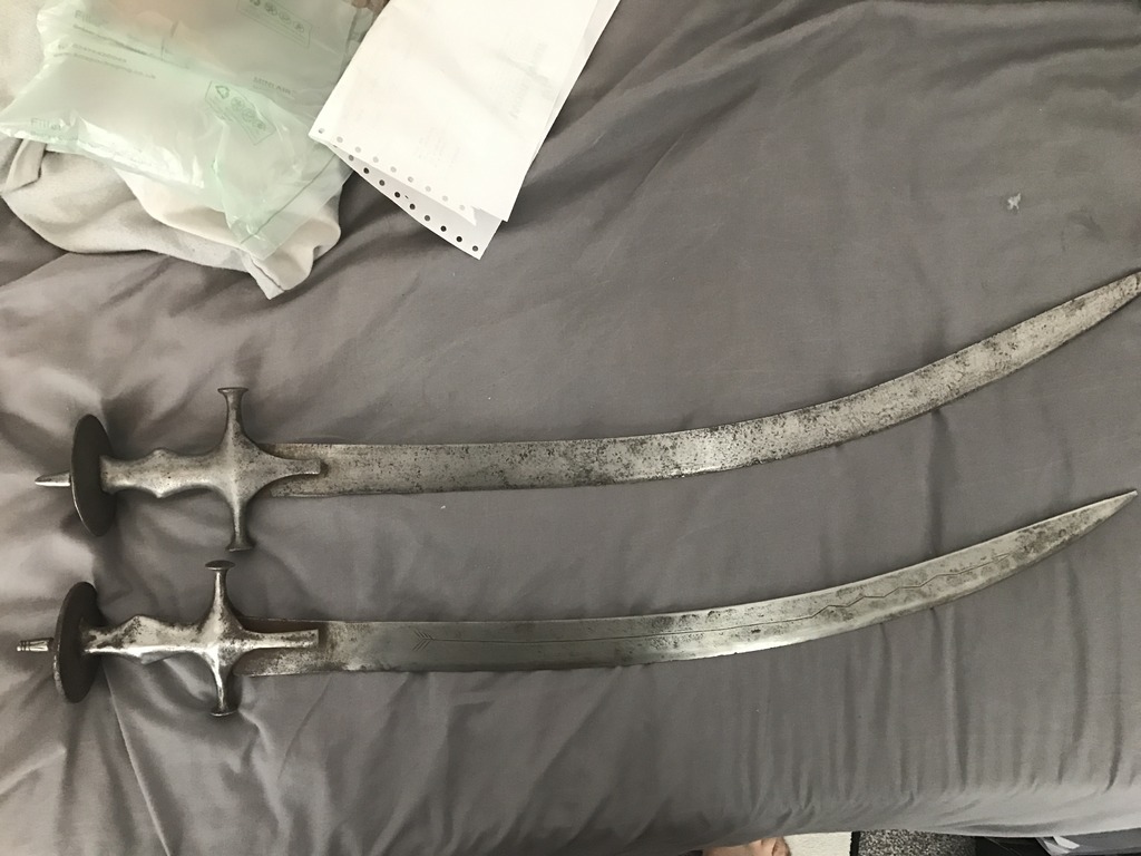

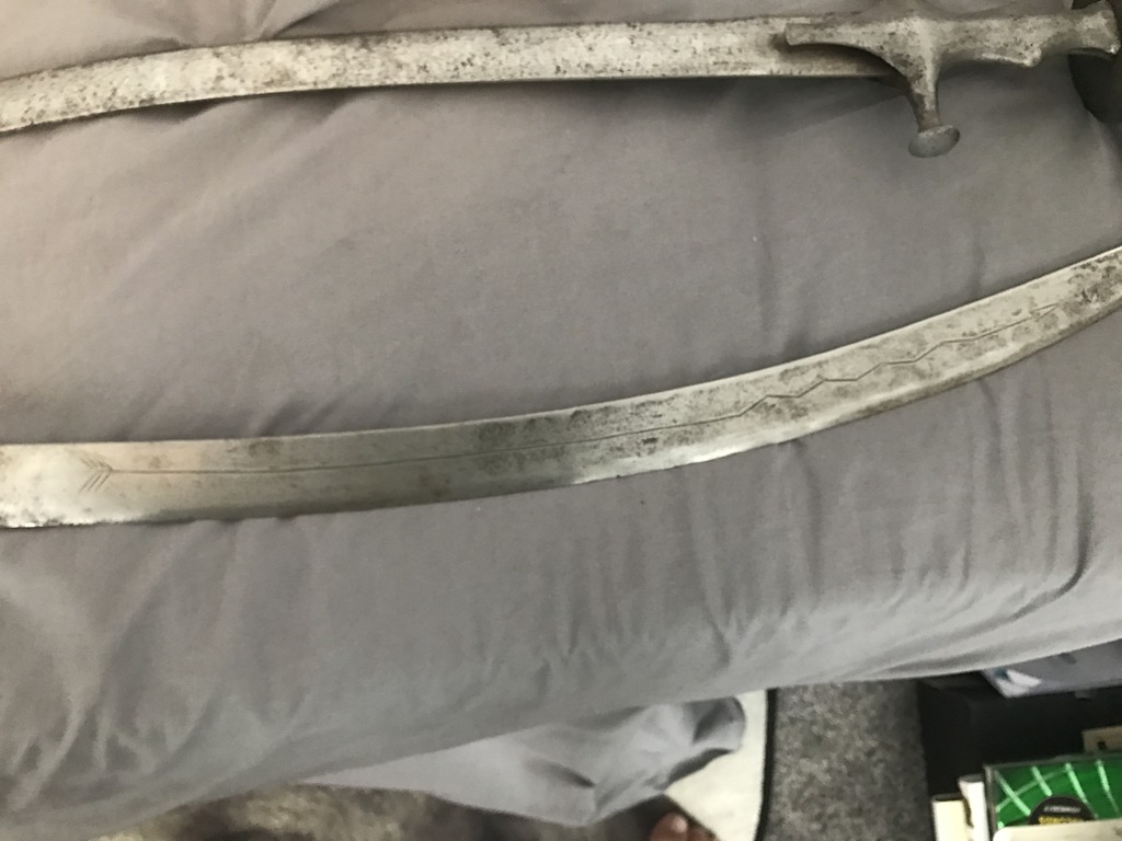

Hi, I recently got these two Tulwars as a start to my antique swords and weapons collection as before I only collected deactivated firearms and bayonets. I think they're real by the looks and feel of them and they seem actually balanced and everything but I was interested to ask incase anyone recognized the markings on the blades or had anything to say about them from their own knowledge. The swords are supposedly from an armoury in Bikaner, Rajasthan.

The tulwars are real and genuine antiques. The markings are very crude attempts to resemble the cartouche and eye-lash mark, and as such do not mean anything other than someone tried to add "value" to the blade, i.e. sell it for more rupies.

As Alex has well noted, these appear quite genuine, although tulwars seem to multiply in and around Rajasthan, as the supply seems boundless. If these had come from the Bikaner armoury they would have had stippled (dotted) script markings at the upper part of the blade. Naturally not every weapon had to have had these as there must have been tremendous volume of stores there.
With these markings, I agree that the one with crude arcs and dentated lines probably was attempting to imitate the so called 'sickle' marks, as these seem to have been prolific on examples of the paluoar 's of Afghan regions to the north.
Also the 'arrow' mark was used by one of the Rajput clans, but I need to find it in my notes. I believe the symbol was illustrated in Tod's book on Rajasthan.
The other marking which seems geometric resembles markings used by the Kalash people of Chitral, an ethnic group formerly Kafirs of Luristan who are animist and use these kinds of symbols.
It is difficult to say exactly what situation these tulwars came from, but often these crude imitation markings were used to imply quality (value as Alex has noted) or in more pragmatic circumstances they were applied to imbue certain symbolism of perhaps talismanic nature.

Thank you very much for the replies and welcome! I'm glad to hear they appear genuine to people with more experience than myself. Also very interesting and grateful to find out about the markings! I probably should get a book on Tulwar or Indian weapons. If the arrow is a Rajput clan symbol could it possibly be evidence that that one at least is from Rajasthan? There are also a lot of chips in one of them that definitely look like its been struck by another sword (to me at least) multiple times, not sure if anyone can see that on these pictures. They have definitely been sharpened before at some point. Could that mean it was used in some form of "well known" conflict?

Both swords appear not only genuine but also bear clear marks of being actually used on the battlefield.
However, I am of the oppinion that the engravings were added as a form of "trench art" as they are too crude to be considered to increase the market value of the swords.
Moreover, there might be some talismanic value attached to them (like Jim suggested).

I was hoping that they might be from combat too, the cuts in the blade are shaped like a blade. It would be really interesting if that's what they are.
Thanks for the replies everyone Does anyone have any idea what date these could be from? I was estimating around 1800 or somewhere around there. Sorry for so many questions but It's very interesting to hear what experienced people have to say about these!
