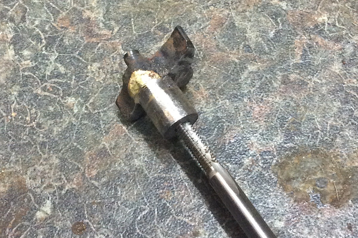

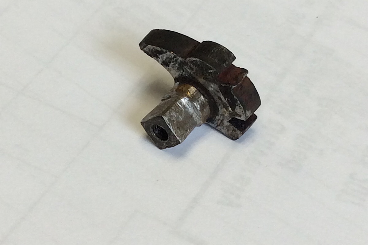

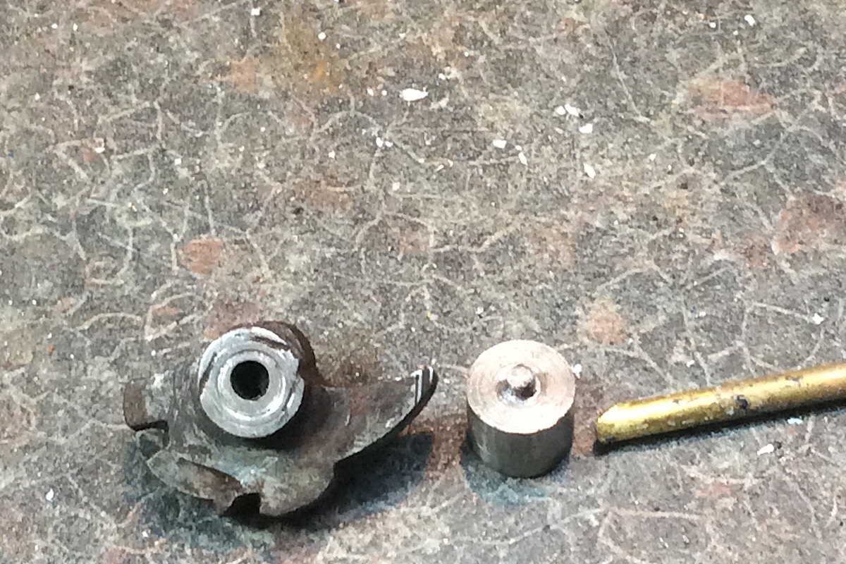

Step one make a piece of round bar that is the same overall diameter as original, there will be a remenant of this on the tumbler face. Also the hole where the screw that holds on the hammer is threaded will probably be remaining on the tumbler
When making the replacement round ( on a lathe) I leave a little nipple that helps central the replacement part onto the tumbler. This also will add to strength
The hole that accepts the screw that holds on the hammer can now be drilled and tapped. I generally drill this hole shorter than originals would have as I do not want to weaken the joint by drilling through it

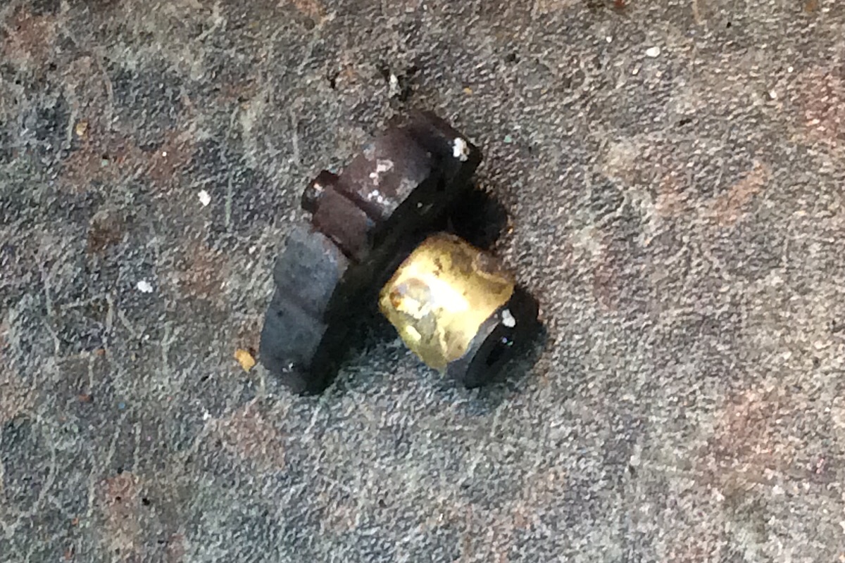

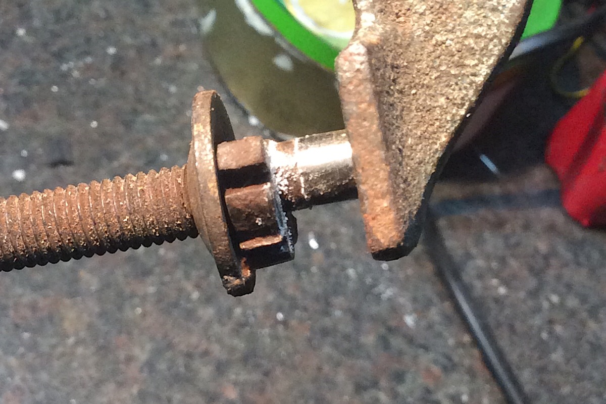

Then clean and roughen both parts and flux it ready for braizing
When braizing the brass runs between the 2 faces , and everywhere else, it might go into the hole for hammer screw, if so tap this out again
File off the waste brass, brass that is not in the joint will not provide any strength so clean off as much as possible.

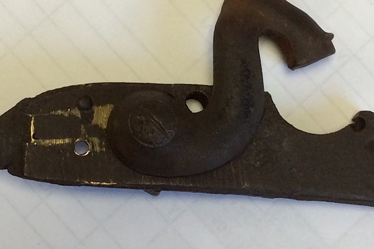

The next step is to fit hammer, getting this aligned is tricky
I recommend hand files all the time, takes longer but achieves the job.
No real trick here just go slow.
I have a good source of old shotgun hammers and find they fit and look perfect, care though they are generally are tapered being a larger square on opening closest to the side plate
Once fitted job done and hopefully the platination I have on the old hammer matches the rest of the metal work.

Ingenious system, but the welding misses the piece, if it was tempered.
Another job to face would be to rebuild the half cock safety, desoldering the part that covers the previous drill, and its triangular spring. It is difficult, but largely satisfactory. Notice that the tumbler still has the recess to act.

I will not be re building the safety as it is the history of the weapon having this removed, probably, maybe? during the conversion from flint to percussion, if the safety was just missing I would probably try a re build
With respect to tempering I have never found the meal to be v soft after a weld or braise but then I will not be shooting the weapon so it will only be going through a few cocks and gentle releases.
