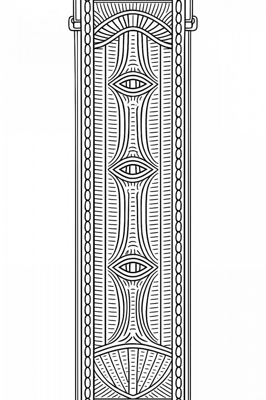

A recent Ebay auction (I did not bid). This is an unusual piece. It was listed as a dha but many features don't line up. I am assuming the German portepee tassel is not original to the sword.
Tang appears to pass through and be peened over a pommel plate/end cap. Dha-type swords are uncommon with peened full-tang construction.
Scabbard is form fit leather, I do not recall another dha with a leather scabbard. It is heavily tooled with repeating geometric motifs, including eye/lozenge forms and punched border decoration. Tje design appears tribal to me. A raised central strip running down one face of the scabbard with multiple small repeated tabs/loops/fixtures spaced along it. These look functional rather than decorative.
Provenance from seller: obtained from the grandchildren of Wigand Wüster (German owner), could be a Stalingrad veteran and author of a memoir of his POW experience.

Location: Singapore
Posts: 467
I feel the scabbard is likely the most diagnostic feature, clearly made for the blade, unusual motifs.

I am not sure about an African origin, the scabbard has a very African appearance to my eyes. And mainland sword scabbards are very seldom made from leather.
Agree completely with you Jeff!

I can see why someone thought this might be a SE Asian dha, daab, daav. Looking at the sword without the scabbard, it could pass for a Cambodian sword I suppose. But I can't place the leather scabbard and its "tribal" designs in a mainland SE Asian context, and the portepee tassel is a challenge to explain.
