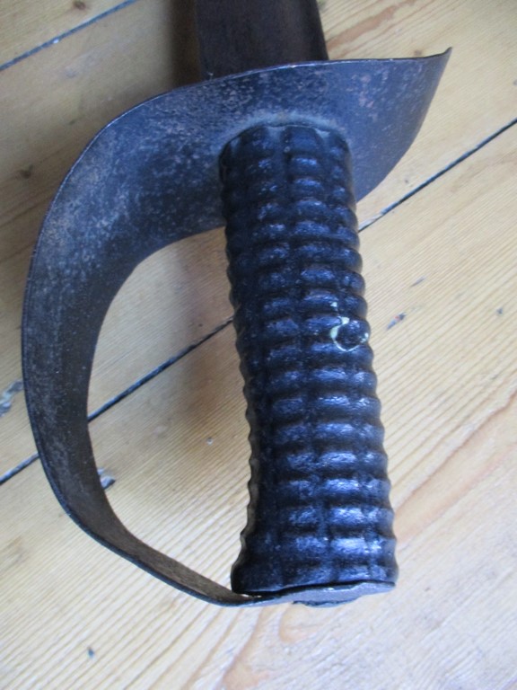

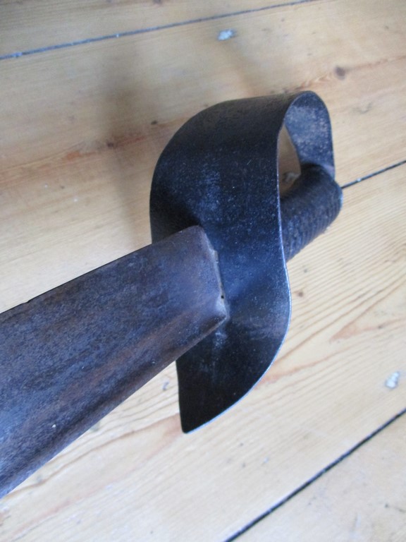

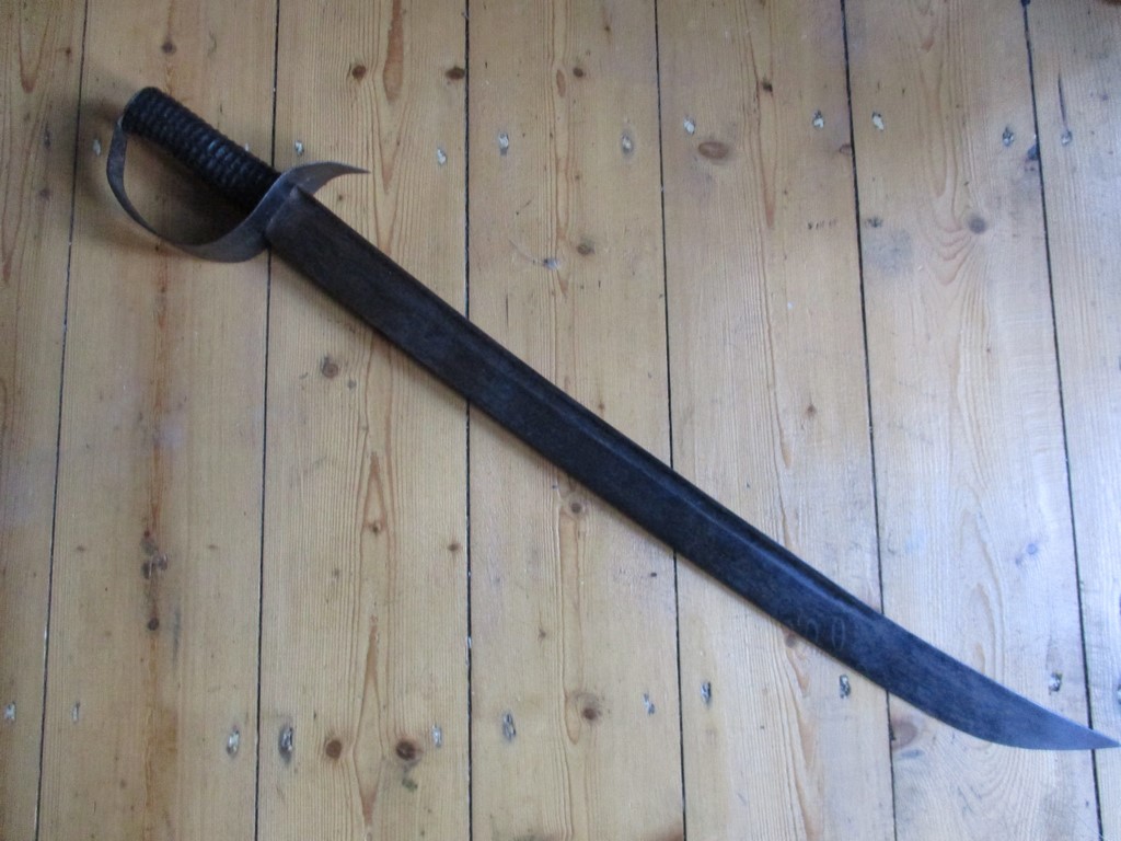

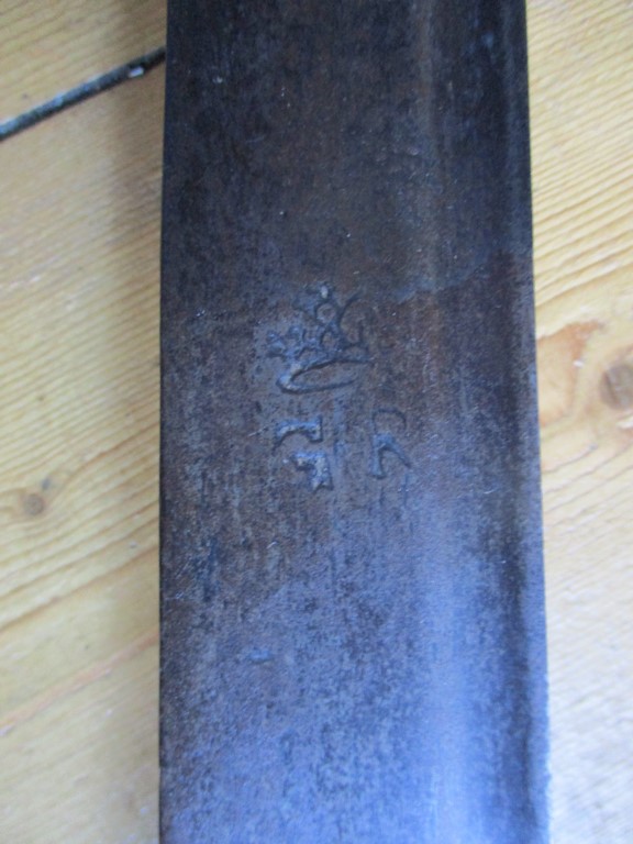

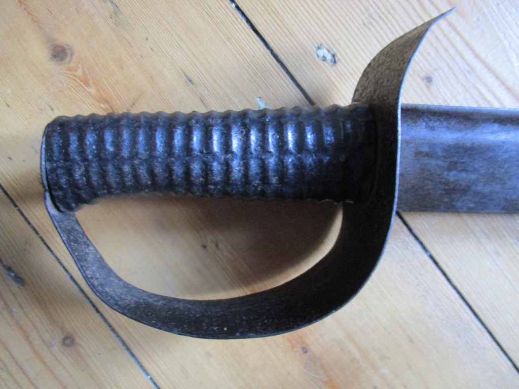

A new acquisition . This cutlass appears to be a British 1814 Pattern but the guard is a narrow dish type rather than the 'figure of eight' . The grip is ribbed iron and the blade has a narrow fuller and is stamped 'GR' with crown. Blade length ( across the curve ) is 24 inches ( 61 cm ) .

Yes it does have an early looking blade but it is closest to the Pattern 1814 cutlass which featured this type post 1803 ribbed iron hilt and had a short curved blade unlike its straight bladed P1804 predecessor .... however the guard is different to the P 1814 which had the same figure of eight ( double disc ) hilt as the P 1804. Its a puzzle to me . If it wasnt for the GR crown I would say it was a commercial variant.

Nice cutlass. Remember this thread back in 2013 on machetes - it discussed the GR used by commercial makers and shows some 19th century catalogues for cutlasses and machetes. One is reprinted from Gilkerson.

According to Gilkerson the cast iron handle with 18 ribs and 6 vertical grooves first appeared on the Brit 1804 cutlass. The handle was almost straight.
Later versions of the handle are more shaped with a swelling and slight curve at the end to fit in the hand better. The 1830's coastguard cutlass is an example.
And this one - courtesy of Cap'n Mark.
http://www.vikingsword.com/vb/showthread.php?t=12145
The straight handle on yours would tend to indicate nearer the early part of the century.
The 1814 appears with both types of handle. But for a cutlass that did not go into production there are an awful lot of examples. I believe most of these were private purchase using blades similar to those shown in the catalogues (see above post) some of which were marked with GR.
