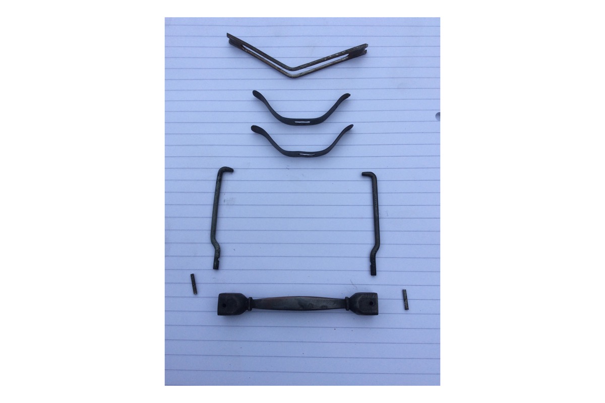

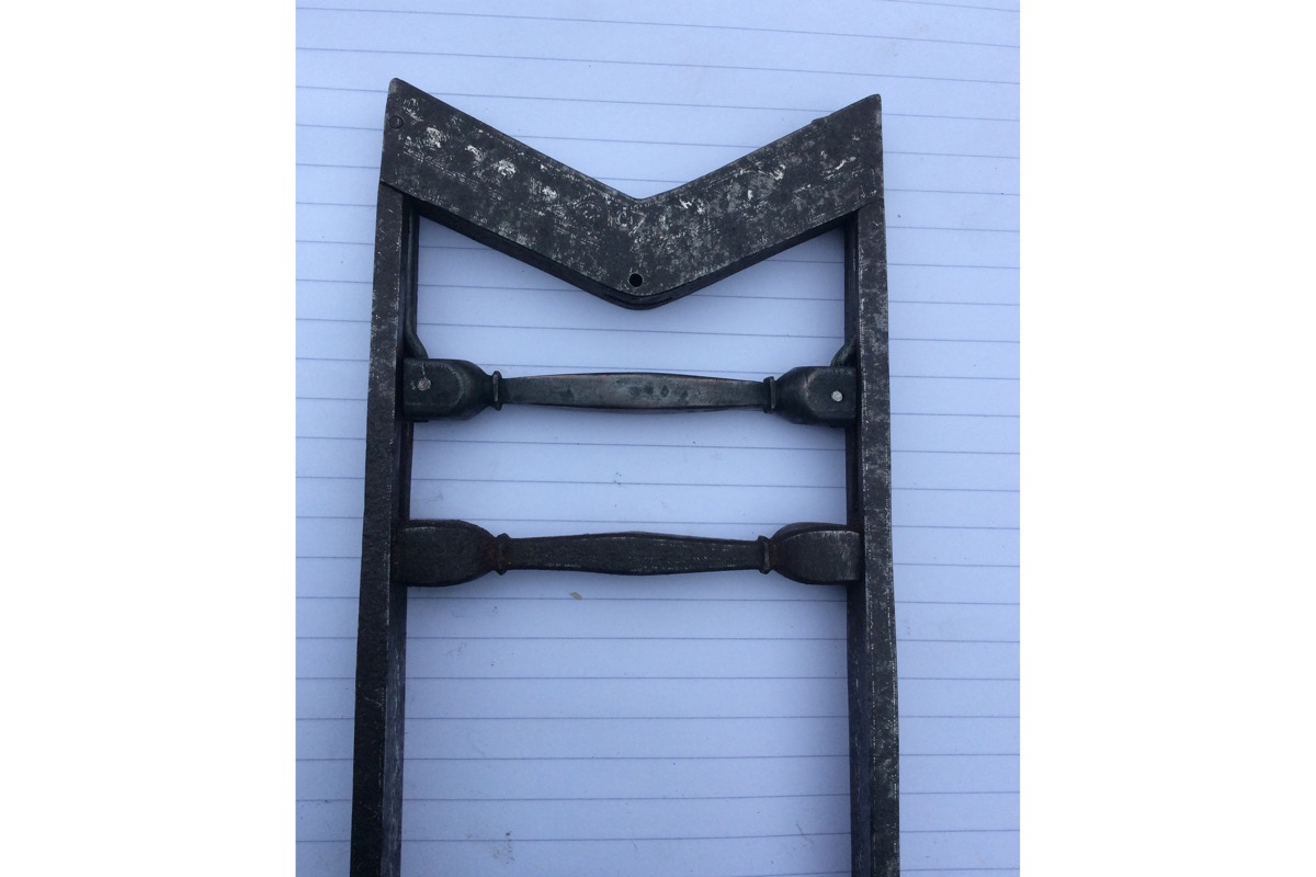

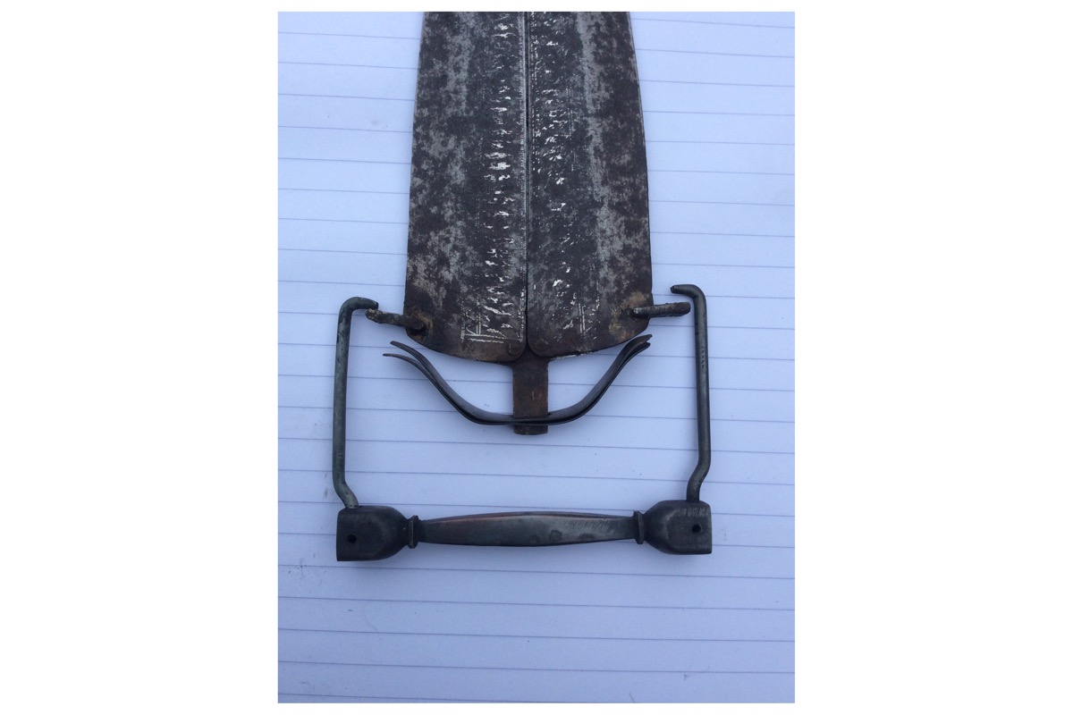

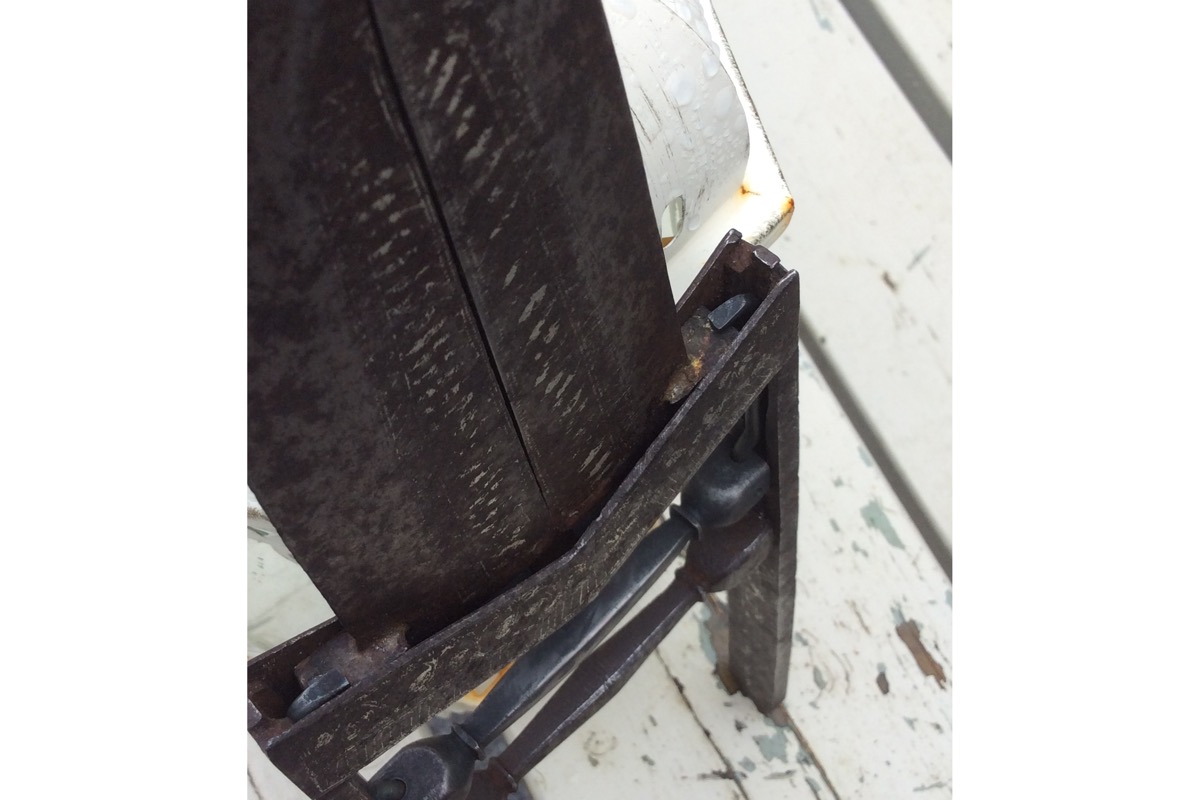

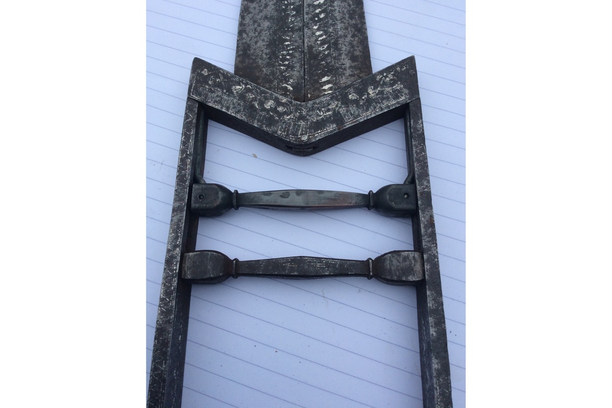

Scissors katar project finished
The first picture shows all the new parts I had to make and the follow on's are the assembley stages in more or less the correct order
I taught people might find a series of exploded diagrams showing all the parts of the mechanism interesting and useful for reference
An interesting build and i am happy with how all worked out
Hopefully pictures are in order showing missing parts made and then gradually assembled together
