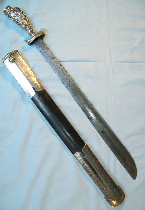

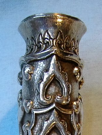

Default A Lovely Indonesian Parang With An Amazing Pedang Lurus Style Hilt

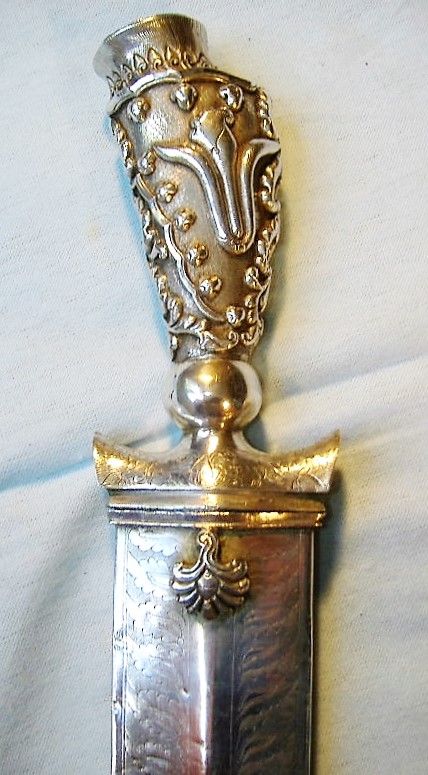

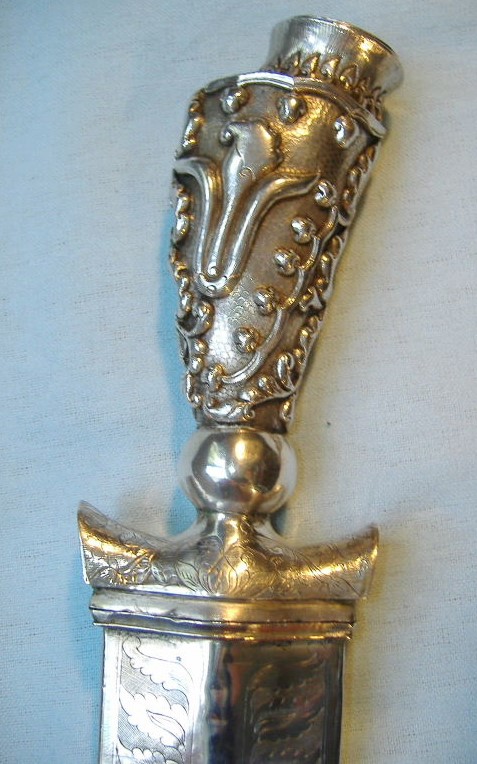

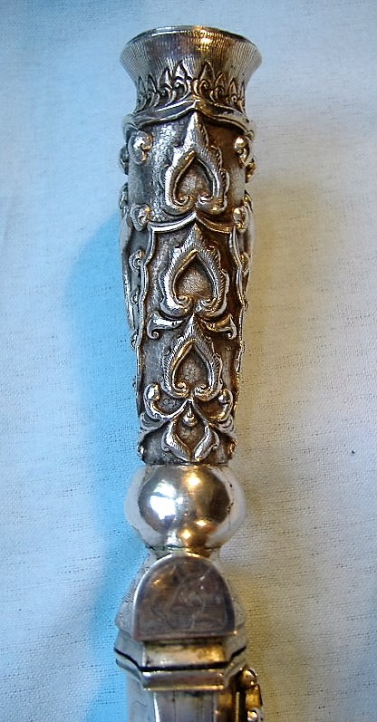

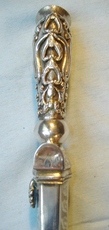

This Indonesian sword/pedang I suspect is Javanese, and is uniquely mounted in fine silver fittings, with the hilt in particular showing amazing craftsmanship. For lack of a better way to phrase it, I would call the hilt type something more typically seen on a pedang lurus or pedang tusuk. Please note the relief work. Not only is the raised work more exaggerated than usual, but look at the tiny scales(think naga) and the "hair" at the top. The detail is just incredible to me.

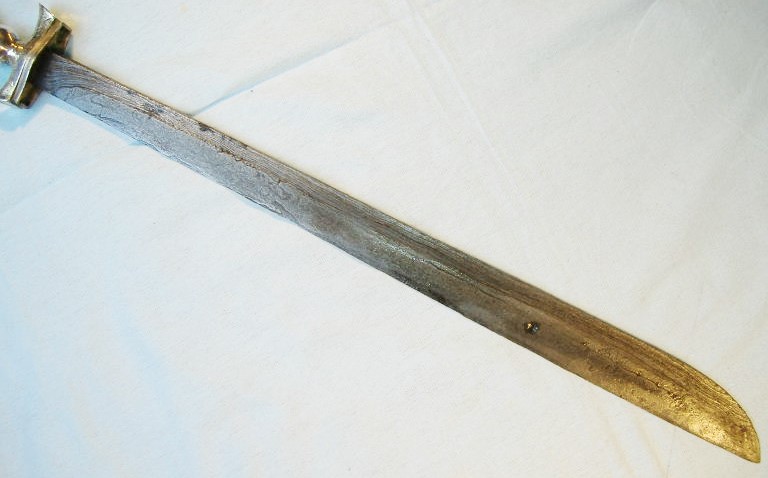

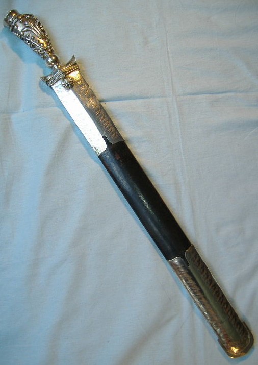

The blade is a rather average pamor steel one. The scabbard is hardwood painted or lacquered black with silver mounts, each with engraved floral motifs along the sides.
Dimensions:
Overall length: 24.5in.
Blade lenght: 18.5in.

I'm usually not into these, but this one I like. The hilt looks like true repose and not just the chased form (or could also be soldered work as well). Better and more challenging craftsmanship.
Also the blade is unusual for these, no? I like this blade than the usual blades found on these.
Congrats!

Thanks Battara....indeed, you would appreciate this silver work! It's the "snake skin" base that blows my mind.

the attention to detail is just incredible!!

Lovely sword Charles.
Battara, I think this is more likely to solder work, creating a solid silver foundation for the grip, rather than repousse that might dent and damage from handling.
Seems like a lot of silver in this hilt--how heavy is the sword, Charles?

Actually, this is embossing work, pretty good quality. It is still done in a range of qualities in Kota Gede, just outside Jogja. They make all sorts of stuff, and export all over the world.
By "embossing", I mean that the design is applied from the face of the work that we see, not from the reverse face, as in repousse work. It is definitely not solder work.
