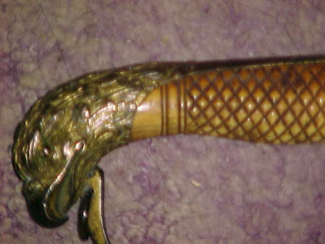

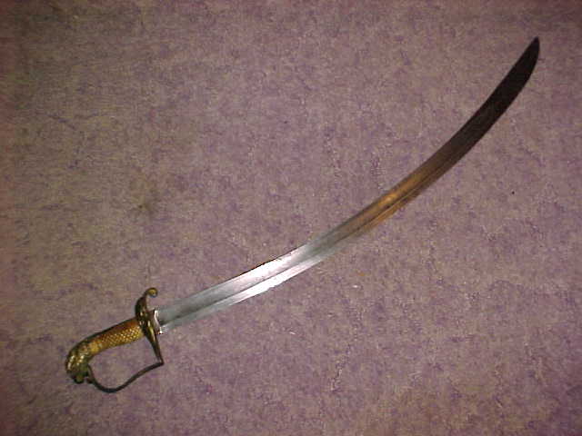

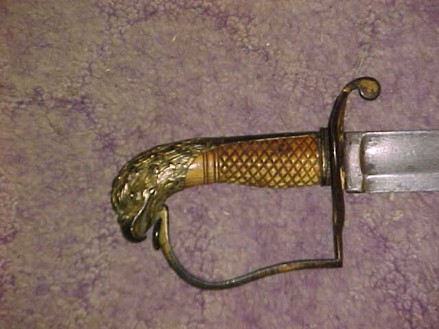

Default Early 1800's US Eagle head Sword

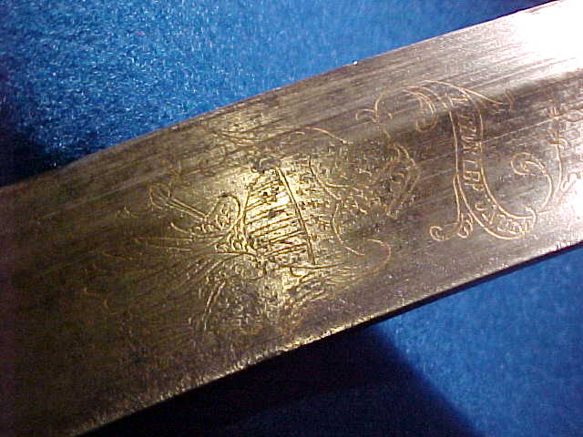

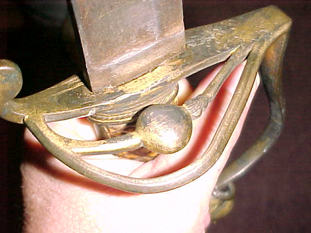

I picked this up a couple of days ago in a trade. I believe it is an Artillery Officer's sabre from 1800-1820. Of course missing scabbard. Has floral design on both sides with kettle type drums, crossed flag and pike with "freedom" capand the U>S> eagl withe motto on the other. Can't make out any markings, but thinking German maker. Has flamming bomb on bottom of cross guard. Your thoughts?

A very pretty eagle pommel from the first decade of the 19th century. I have one that is similar with a plain blade marked to Woolley Deakin & Co. Mine has leather over wood for the grip. John Salter of London sold similar eagle pommel swords. Even if it turned out to be a German blade, the bird is Brit ish
A worthwhile book for these is this title http://www.gunandswordcollector.com/..._EA_eagle.html
Without a maker or retailer name on the blade, there isn't a whole lot more that can be said. A flaming bomb motif usually marks a grenadier in Europe and while this is the first I have seen in the counterguard like that on an eagle pommel, I have seen a couple with multiple grenades chased into the gaurd.
IMO, one of the prettier eagles.

In searching through whatever info I could find on line, I did find that it seems most American eagle head officers swords pre 1820s or 30s were produced in England, France or Germany. One note claimed that examples with langets were typically German produced....is that a reasonable axiom?
For some reason this example seemed British to me, I think due to the cross hatch on the bone grips, which reminded me of other British hilts of this time.
I am curious on the eagles, while this one has a smooth head, the others, such as Ketland, have pronounced flat heads but I cannot think of the term.
It seems this has been rather appointed the 'American' form of eagle, sometimes called 'screaming eagle' ?
