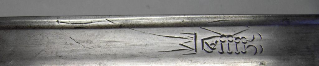

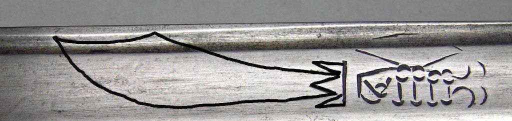

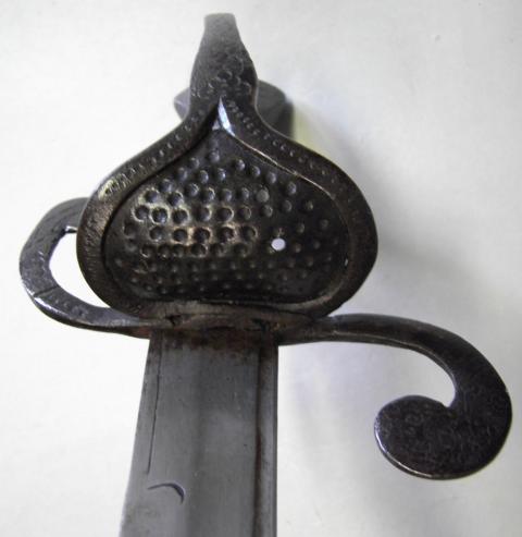

I have got this campaign sabre last week and wonder if someone here in this forum has ever seen the mark or sign on the left side of the blade. It shows a hand holding a falchion and I'd like to know what this sign stands for. Another mark on this blade is a Greece letter "Pi" and a crescent moon what might stand for Standler at Munich. Total length is 107cm.

the falchion is the maker sign of the workshop Stantler and your sabre is a so called half hilt popular in fe Holland Sweden Germany and Switzerland 1625-1650

Thanks a lot for both replies, so I learnt that the falchion is the maker's mark of the workshop Stantler. Until today I just knew the crescent moon and the "Pi" beeing the Stantler-mark.

The falchion mark seems to have been used (though not very often) by Christoph Stantler I. A good, sharp, example can be seen on a two-hand sword in the Vienna Historisches Museum, inv. no. 161.162, from the old Burgerliche Zeughaus, dated 1573.
A very interesting sword you have there, by the way.

many thanks for this helpful information. By the way this sword was sold by HH in Munich, auction 66 in 2013 lot 3402. But I wasn't the buyer at that time. Sometimes one has to wait for a better opportunity...............

That bizarre configuration of arcs and lines looks almost like some sort of western attempt at Islamic script at a glance. Then again closely it seems more a geometric spasm.

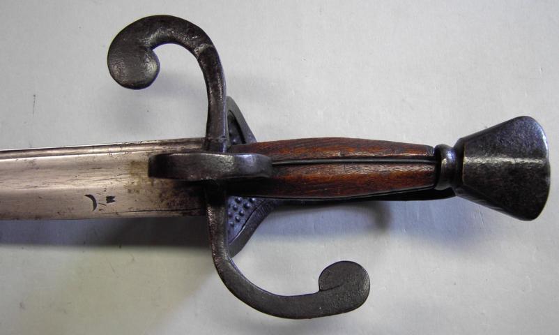

Can we get a close up of the 'pi' ? These marks are often elusive and varied as they are so often degenerated to almost being indiscernible.

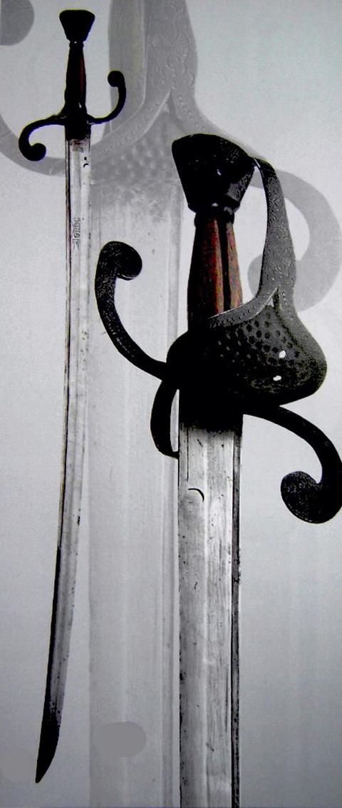

Can we see the whole thing please?

here it is in full length
