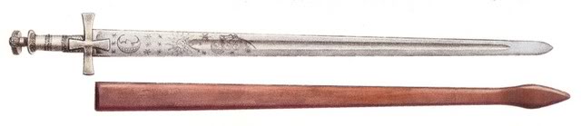

I was digging around in my image archives today and came across a couple odd images that I was hoping I could learn more about.
The first is a kaskara, but was labeled as Ethiopian. I know of another kaskara with this odd pommel configuration, I believe the MET has it.

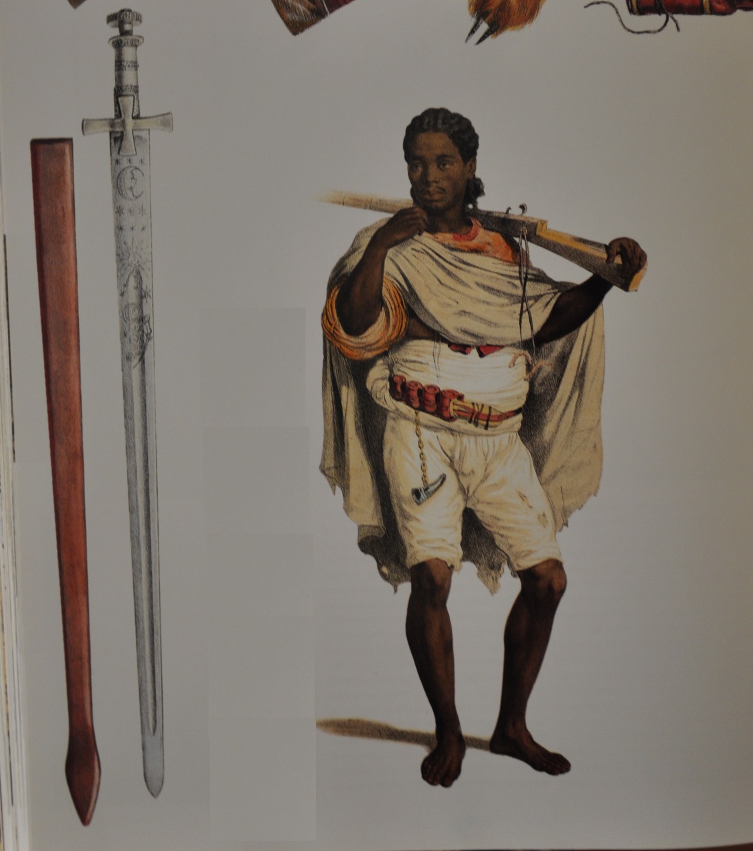

I think your first sword is Ethiopian and the museum was right (this time).
I will post some documents tomorrow to prove it.
When I say Ethiopian I mean found in Ethiopia and used by Ethiopians,
The sword was probably captured from a battle between Sudanese and Ethiopians and refitted with a new pommel later by Ethiopians.
Kubur
Old 28th October 2016, 07:21 AM   #14
Kubur
Kubur's Avatar
Posts: 2,145

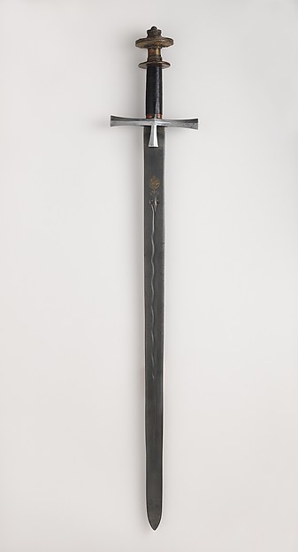

In fact your sword is not from the MET.
The kaskara from the MET is here.
Your drawing comes from an old French traveller book, the author drawns and collected objects from Ethiopia, objects used by Ethiopians.
Theophile Lefebvre, Voyage en Abyssinie, 1845.
Kubur
