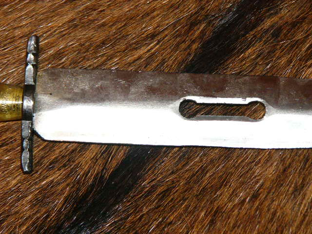

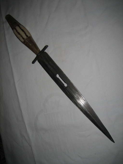

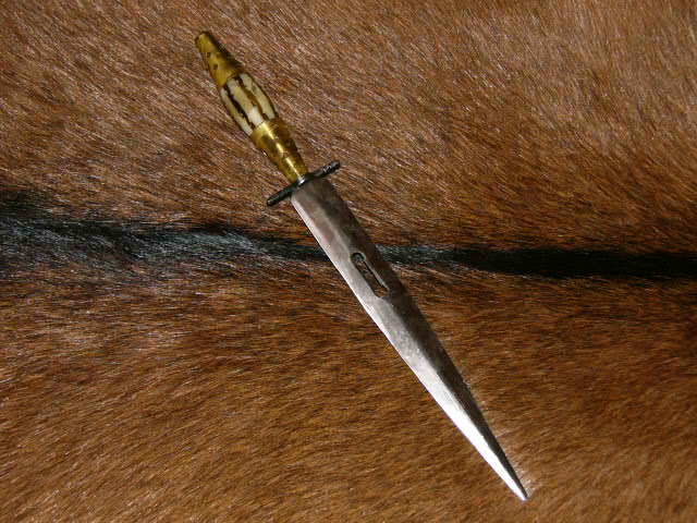

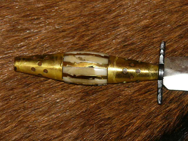

I just bought this "Castillian Dagger" in Toledo. Believe me, it was hard to find anything in Toledo that was not tourist junk. It has a Toledo mark and is dated 1870. If anyone can offe more insights, I would appreciate it.

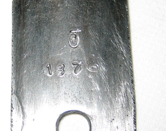

Marcus,
That looks like it might be a modern reproduction. It is hard to see the tang stamp on the knife. Do you have a better image?

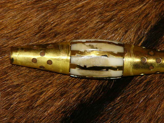

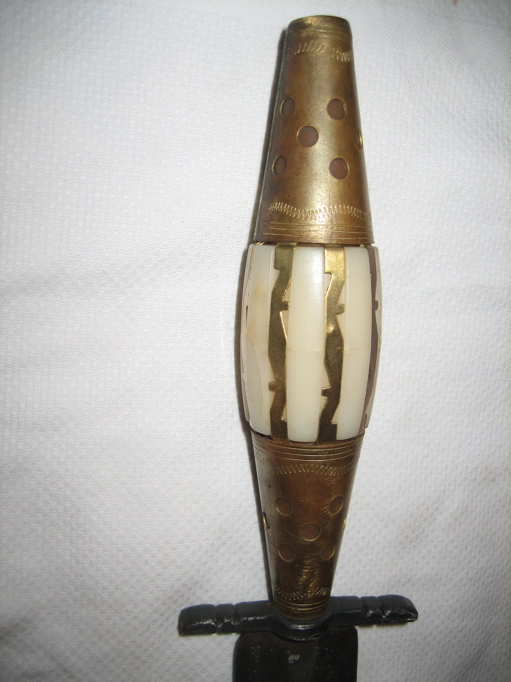

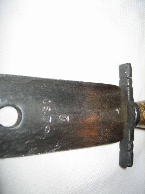

I believe the dealer was very reputable. We talked for an hour. He knew the difference between old and new and did not misrepresent his pieces. He did tell me that he thought the inlays that look like bone were probably bakelite or some other early synthetic.
Here is another picture of the proof mark.

It's an "Albacete" dagger, named such because this pattern is considered typical from the city of Albacete, in the actual Spanish region of Castilla La Mancha
The pictures are not clear enough to pass a truly accurate judgement about the age of this specimen, but if its indeed old, the style would coincide with the second half of the 19th. - beginning of 20th centuries.
I would not place much hope in the blade's inscriptions. Decoration on these blades used to be punched with geometrical patterns of dots or etched with foliage and inscriptions. Featuring the manufaturing date is not unheard of, but it normally appars as an etching. The "Toledo" mark is even more spurious. In short, they are good candidates to be later additions.
Despite of this, if it's indeed old it's a nice exemplar. My congratulations on actually finding a weapon really worth buying in the city, it's not easy, as you've already pointed out. And the few places with some genuine material are freakingly expensive...

Hi Marcus,
Not2sharp has summed it up pretty neatly. It is a dagger in the Albacete pattern, but its date of manufacture is a puzzle. If the inserts are indeed synthetic, as you suspect, (the handle looks too white to be bone) then that would date is as post WWI and daggers such as your were still being manufactured as late as 1960 for the tourist trade. I also find that "1870" highly suspect, and by way of comment can add that the practice of falsifying dates of manufacture as well as brands was not uncommon amongst Spanish cutlers. The all too ubiquitous "Toledo" can be found in any number of junk Spanish navajas, knives and swords, being a generic brand intended to beguile tourists, trading on the justly famous reputation of the sword blades manufactured in that city before the 20th cntry.
I could not identify the logo-brand from my books
Is the blade hardened?

As far as I can tell it is good steel. It has a nice sharp edge. However, I think Julio himself questioned the date. I can certainly believe that the stampings were added later to try to create a history for the piece. Anyway, when I get back to the states I will show it to my blacksmith friend and let you know what he says.

The reason I asked is because it is very hard to stamp a hardened blade, at least to the depth of that "1870".
Be that as it may, you did not do badly at all for the price you paid because it is obviously handmade and E85 is small change in Spain for anything.

Does anyone know what the purpose was for the cut-outs in the blades of these daggers?

Posts: 221
Marcus
The shifty eyed ones will suggest that the cutout would be coated with poison, or used to inject air (promote gangerine) into the wound, or perhaps there to ease the extraction of the knife. None of which make much sense since someone locked into that level of combat would very much like to see his opponent die immediately rather then within hours, days, or weeks from some desease or toxin. Most likely they were 1) a decorative device, and 2) used by the bladesmith to ease the manufacture of the knife. The cutouts do not appear on all Abacete daggers.

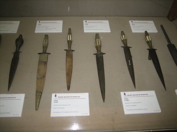

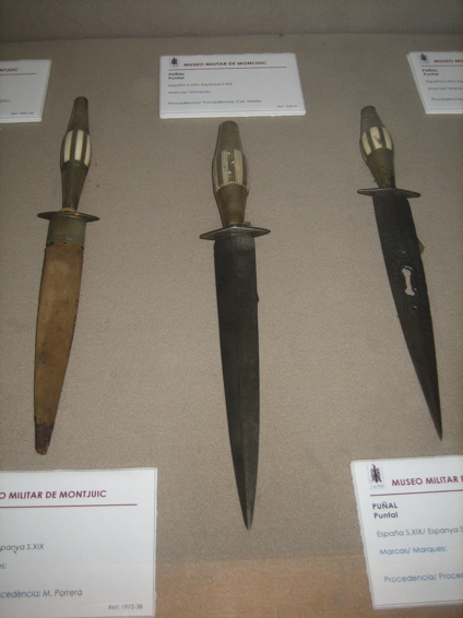

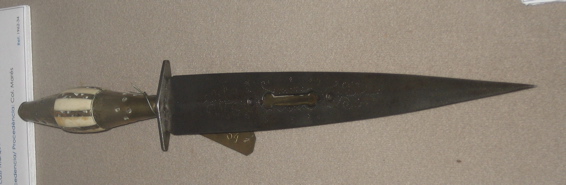

I got to the military museum in Barcelona today (after all the Picasso exhibits earlier this week, it was my wife's turn to be patient). Here are pictures of similar weapons from their collection. Most have the cut out. One has a metal (brass?) insert in the cut out.
Marcus

The metal insert would have been a "bodkin" used as a crossbar to limit blade penetration.
Notice the sword all the way on the right (yes, all three shown in illustration are specialized hunting swords):
This was particularly useful when you wanted to be able to control dangerous game; to keep them at a distance rather then having them ride up the blade to within striking range. It doesn't make much sense on a knife; although, these daggers evolved from the hunting plug bayonet, so it may have been a stylistic element retained from the earlier form.

I thought it looked rather like a plug bayonet when I first saw it. For hunting, you say? I suppose after you took your one shot you had to do something if the Boar wasn't down.

In this kind of daggers, the cutouts are decorative, as are the brass inserts in some of them. They tend not to be attached very securely, so the majority of them have been lost over time.
I'm glad you enjoyed your visit to the Montjüich Castle museum.
