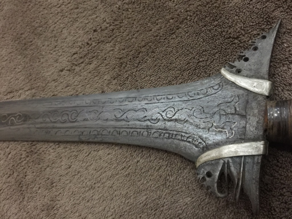

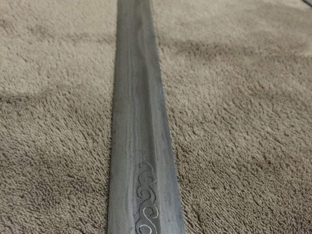

I recently purchased my second Moro sword from Mang Venn in Manila (a Barong). As I was there, a particular kris caught my eye and Mang Venn, savvy businessman as he is, lent it to me to "feel" if I wanted to get it too. Honestly, I do. It hit all the right buttons. But one thing that bugs me is identifying whether the kris is from Sulu and whether it's relatively modern or early post-war. The gangya is also confounding to me as the line seems very subtle but I can't confirm if it's actually separate or cosmetic. So help, please! Still new to this compared to you fine folk. But I am very excited as I got to meet a relative who's a politician in Sulu who'll send me a kris once he finds a good one there.

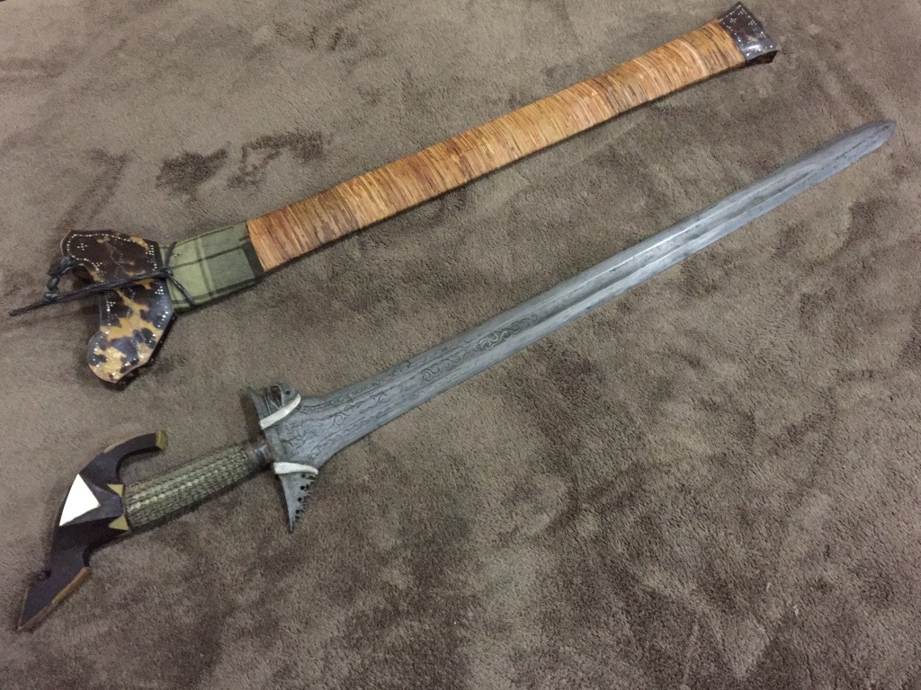

32.5 inches overall with a 24.5 inch blade. Longer than I am used to (apart from some tourist kris I see all over the Philippines).

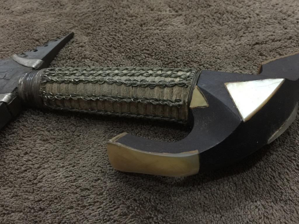

I was told the blade is Maguindanao with recent Sulu fittings. Given the inlays that seems to be the case. The fuller is nicely done. Uniform width throughout. The blade is a bit thinner than I'm used to seeing, but overall it feels very well balanced. The handle does seem a bit tight though. A mother of pearl panel at the very end is broken which I shall endeavor to remedy.

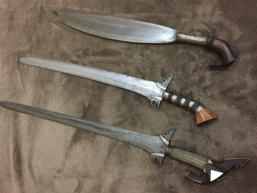

All 3 pieces seem to have received later Sulu fittings during their working life (with the barung blade being probably the oldest of the lot IMHO); the hilt of this kris seems to be a fairly late replacement though - well after WW2 and more like late 20th century (or possibly recent and artificially aged). I'd be tempted to try replacing it with a more traditional hilt style (make sure to keep the ferrule which seems to be genuine and old while the clamps could need a quality upgrade).
Please post a close-up of the base of the blade taken from exactly above (a slight angle as in your pics can distort some features).

The proposition of replacing the hilt by myself scares me. While I've handled a great number of pieces, I am not well-versed in what features would be found in a hilt reconstruction despite reading so many posts here about those same features. What kind of hilt would you say fits this piece?
