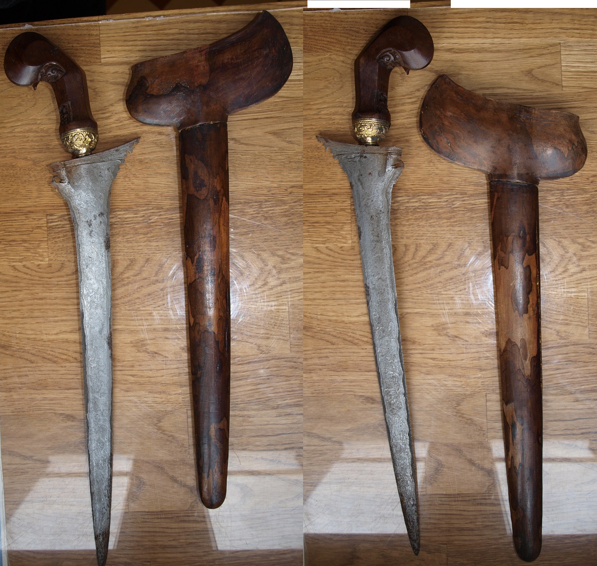

Here is a Solo keris (I think) with a strong straight blade.
The pamor is simple (Ngulit Semangka?), but I have failed to identify the Dapur.
The blade measures 34.5 cm and the selut is made of copper (or copper alloys) with gilding.

Don't look Central Javanese to my eyes, I would place this keris more to East Java or to the North Coast, I tend to the last one. Would be interesting what others have to say.

Only the hilt is from Solo IMO (but with a very curved shape), the blade and scabbard rather look from East Java. The blade has a simple dapur (kembang kacang, jalen, lambe gajah, pejetan, full greneng, and grooves on the sirah cecak like Balinese blades) which may be identified as Kala Dete according to the EK, and the pamor pattern as Pedaringan Kebak. Other opinions are welcome!
PS: I agree with Detlef that the blade may also originate from the North Coast.

I would agree Detlef, that dress is not Solo.
Sempana Bener might be a good guess on dhapur, though as far as i know that dhapur does not include greneng beyond the gonjo and on yours it seems to extend onto the blade itself. Closer images of the base of the blade might be helpful.

Yes greneng begins on the blade.
This is a detail that was that I could not find the dapur.
I thought he came from Solo due to the handle.
For warangka gayaman I can recognize those of Madura and Yogyakarta but not those of other Java region. I don't know what is good documentation on this subject.
Thank you for your help.

Nothing at all Solo about this keris.
It is fairly rustic work, and I cannot associate it with any kraton style. It has elements of both North Coast Jawa and East Jawa, but it could be from anywhere in Jawa or from anywhere with a Javanese influence.
