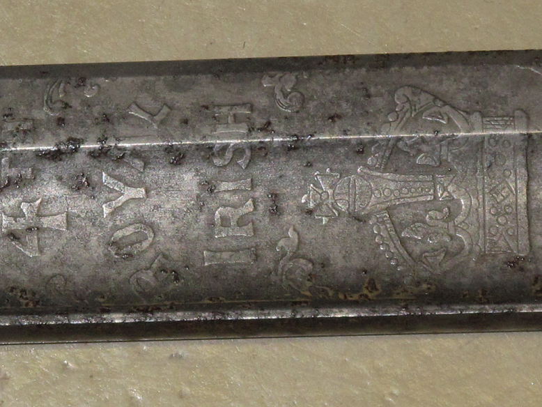

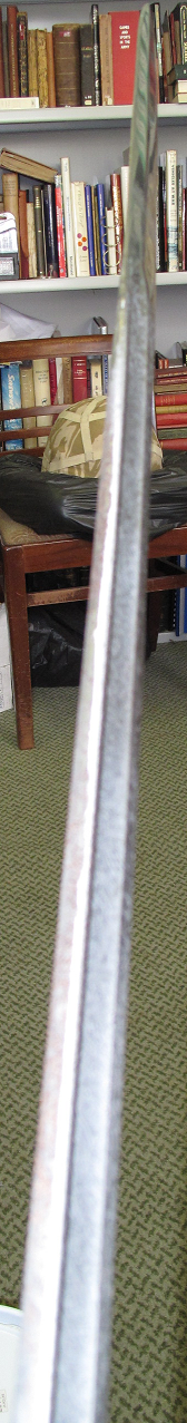

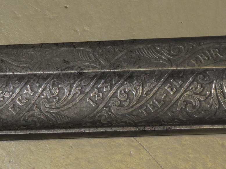

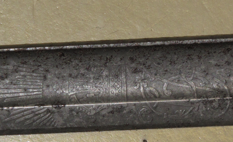

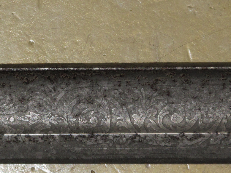

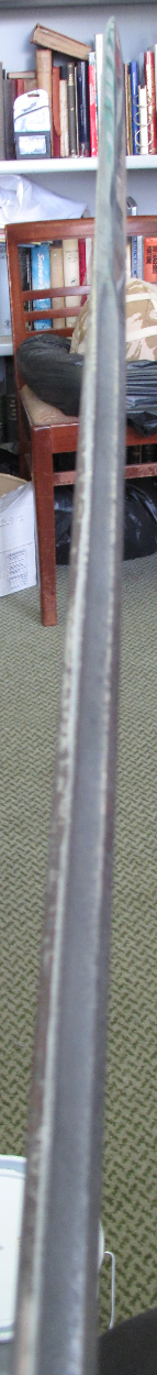

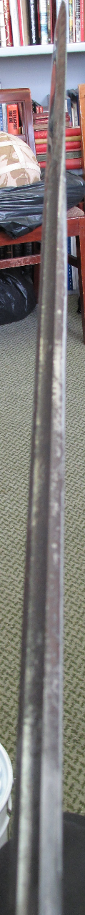

Firstly, some background. Recently I persuaded my boss to cut loose on the string and buy some Renaissance Metal De-Corroder (please read the information therewith before responding), a handy little compound which seems to be very effective in killing rust without killing your object in the process and rather less deleterious to its appearance than wire wool. Full of cautious enthusiasm I set to work with this stuff on one of our swords. This particular sword was in a dire state; it had sat in its scabbard for something like 15 years, and the centre of the blade was one solid cloud of rust for about half the total length of the blade. It was a sorry thing, and I held out little hope of improving its lot in life. This was made especially sad by the fact that this particular blade was visible a fine example, inscribed with (just about visible) battle honours one one side and what turned out to be the 4th Dragoon Guards' regimental emblem on the other.
(And yes, I realise this is a European weapon - bear with me, neh? )
So I went to work. Ideally one should simply immerse the affected metal in the solution, but being run on a shoestring we neither have, nor can afford, a tank of such a capacity (let alone the volume of solution to fill it), making it necessary for me to paint the solution onto the sword. This obviously necessitates constantly re-applying a thin layer to the metal, as well as accepting much greater evaporative losses. But still, it couldn't hurt, frankly. The photos included show a view of the untreated blade; all that brown gunk is rust. It wasn't at all pretty.
The results, therefore, surpassed all my expectations. As you can plainly see if the post-treatment pictures (the more normally-proportioned ones), the sword is one more legible, the text almost unmarred by more than a decade (at least) of neglect. All in all I was very, very happy - and extremely glad I'd bought that superb product. End of intro; more in post 2.

Now, on to the Ethnographic bit! As you may be aware (dear reader) we have in our museum a jezail, with what looks like a watered barrel. "Aha", says I - "a prime candidate for de-rusting. It's a melancholy thought, that no-one shall again see the beautiful metalwork hidden beneath the mottled ugliness of rust, bearing witness to (inadvertent) neglect stretching over years." But wait - how will this stuff affect the very steel I seek to preserve, the wonderfully patterned wootz (or Damascus, or whatever it is - I'm still not wholly clear on this point)? Full of my increasingly typical circumspection, I rang up the chaps at Picreator and was told that it should be fine - Renaissance Metal De-Corroder shouldn't affect sound steel unless you leave said steel in the fluid for about a month or two, at which point you're just asking for trouble. Deciding that this would do, I filled a mug with the solution, rested the (clamped-up) barrel's breech end therein, and went home, fretting. I had already treated the hammer, trigger, trigger spindle and two of the barrel bands, with good results - but I still worried about that pattern.
The end result of this has been... interesting. What's undeniable is that the solution has removed a whole bunch of corrosion. It's not just removed it - it's devoured it. Sections of metal that haven't seen the light of day for decades are once more staring happily at me. Huzzah! But all the same, I'm a tad concerned. As you can see in the photographs, there is a clear boundary layer between the treated and untreated areas of steel. Treated steel seems to lose at least some of its lustre; it becomes very, very clean, but doesn't seem to shine as it once did. In addition, the area around the breech plug now has patches of orange colour, which I assume to be copper. This I find mystifying and more than a little worrying. I'm additionally not sure whether the solution has affected the watering, simply because - surprise, surprise - it was buried under rust heretofore.
Included are pictures. Note difference in colour and patina between the hammer and its lock; the clearly defined layers between different sections; and the strange deposits towards the very back of the barrel. Any ideas as to what they are, what the effect of this stuff on the watering might be, and what's making the steel so grey and lifeless (if very, very clean)?

Posts: 2,928
Hi,
Sounds like your rust eater is a somewhat acidic product. This is not umcommon of course, and most rust removers are by nature highly corrosive.
The results on the sword blade looks quite good in the pictures.
The results on the gun parts are perhaps not quite as desirable.
Thing is, oxidisation goes through several stages, and having some stable oxidisation in pits is sometimes more desirable than 'cleaning' those pits out.
On an old steel/iron surface, what can look like a mottled dark shiny 'patina' (not rusty and flaky just dark and obviously slightly oxidised), will often be hiding a multitude of small, tiny and microscopic corroded imperfections which will all be revealed if using a corrosive solution to eat the oxidisation out of them.
even an undamaged polished steel surface can be affected by the acid and mildly etched. Which can leave a grey looking colour.
Of course it all depends on the type of steel/iron, how its treated with the etching solution etc.
Try some tests with scrap pieces of ferrous metals.
One thing to remember is that there is no 'magic bullet' for cleaning up a neglected piece of rusty metal.
Slow is best, as removing patina is much easier than restoring it.
If a piece is pitted, then a decision has to be made as to if the oxidisation is to be totally removed, stabilised, left alone, repolished etc, etc.
Total removal might make a piece look 'sandblasted', repolishing might make it look new.....
The two 'best' solutions are often:
Stabilise and conserve, removing loose flakes but essentially leave 'as is'.
Or partial removal of oxidisation (down to or close to the level of the surface) while preserving the dark stable oxidisation in the small pits so as to maintain a 'natural' flat shiny surface (even if it is mottled).
So perhaps a wipe over with your solution to start to remove the loose, surface stuff, then neutralise and repeat if needed.
Never a good idea to treat a piece with different techniques in sections as you might get very different results. Or worse, you might get 'rings' where the top of the liquid level was.
