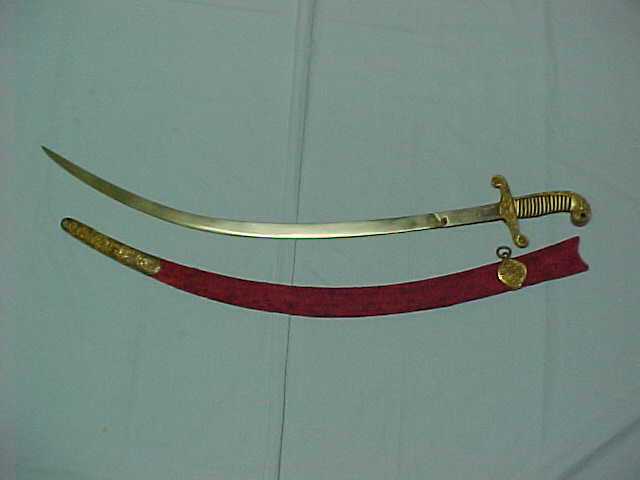

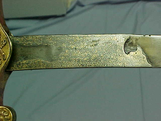

I always find it interesting when you have a hilt from one culture and a blade from another. One can find Indian blades mounted in British hilts. One also finds many British blades mounted in Indian hilts. Here is an interesting example that has some unique features worth discussing. The shamshir blade has a most interesting feature near the hilt. The blade has been sandwiched with two steel plates. The plates look to have been koftgari'ed at one time but most of it is worn off. The plates do not serve any functional purpose so I wonder what the intent was. I have only found this feature pictured on one other sword. It is pictured in Stone's and referred to as Salapa.(p. 537 figure 688). That example even has similar scalloping as my example. Why do this? If one wanted to simply add koftgari then why not to the blade? If one wanted to add support to this section of the blade why not forge it thicker? The hilt appears to be British and I would venture a late 18th, early 19th century guess. A real neat combination and makes my imagination run as to how they came together.

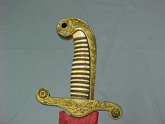

is that ivory hilt?

These plates are essentially identical to those that descend from the bolster on many yatagans.

It is an interesting combination, but don’t you think the two plates are there, more for looks than for any practical use?
The Salapa Stone shows seem to have a yatagan blade, as far as I can see, but the name seems to refer more to the hilt than to the blade.

Is that blank area on the bolsters (? gotta call 'em something) where a (tulwar?) lagnet once was?
I think the feature may be more a familial mark of cultural relation to yatagan than a directly utilitous feature, although it does stiffen the blade, of course, and should help with shock absorbtion, and one might speculate that the breakable solder joint provides something that can "give" while sparing the actual sword; again, a-la "crumple zones" on cars. Mainly I think its purpose is to express a relation to/visually "cash in on"yatagan, khanda, pata, firengi, etc. with their overlays at blade base and spine. As for why not forge them right in originally, I guess there's two answers to that; A/ I often seen pieces where the cutler/hilter seems to have been having an argument with the bladesmith, as it were, re-arranging his intent on tang angle, etc.; and B/ "That's the way we do." having descended from a seperate feature (yatagan bolster or khanda reinforcers) it remains a seperate feature. What is interesting is to see it persist when any continuation into a bolster or guard seems to have been eliminated.

Rick, is the blade light and thin?
