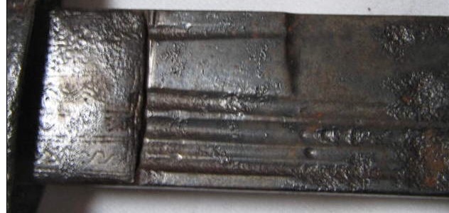

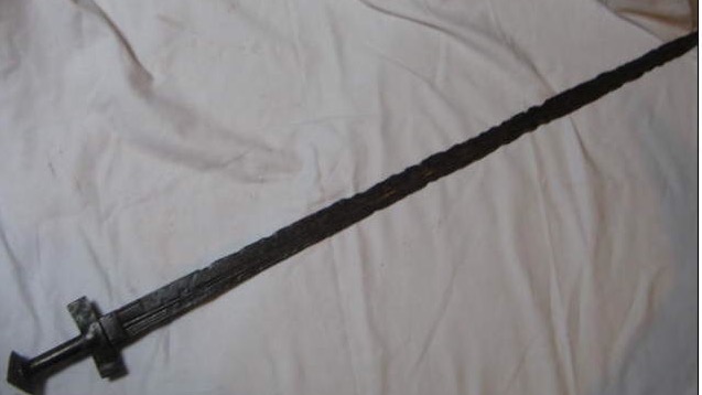

Just won the auction for this but it won't arrive for awhile. The blade supposedly says "Zacona Toscania". Zacona is a town in Tuscany, I presume that's where it was made. Does that town have a history of making swords?

Pity about the blade damage from rust, but otherwise a very nice and interesting takouba. Iain has similar Italian backsword blade mounted ones and I am sure he will chime in.

An intriguing one! I'll hold off on detailed comments until I can see better images, but this has some interesting features like the brass at the base of the blade.
A pity about the condition of the blade, somewhat relic condition, but I still see a lot of appeal to the piece. I think you will find that the blade has been modified to be two edged.

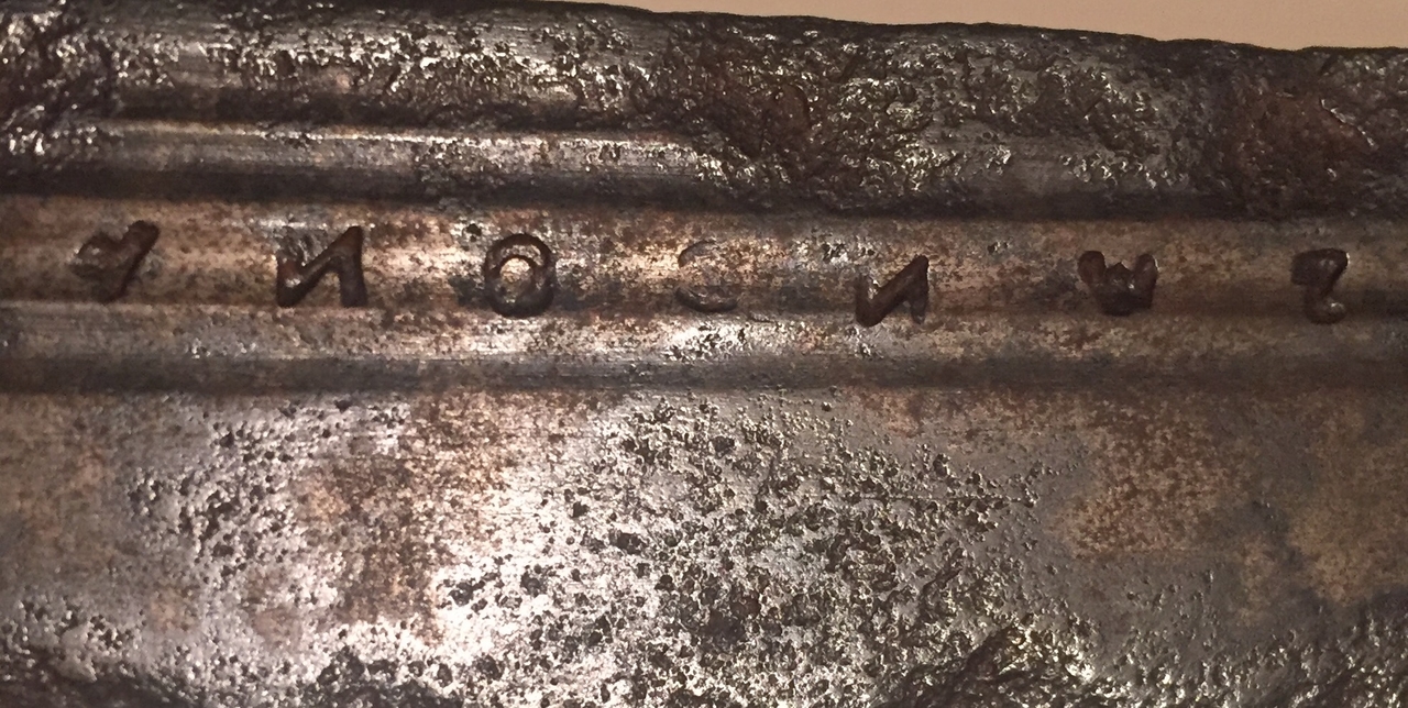

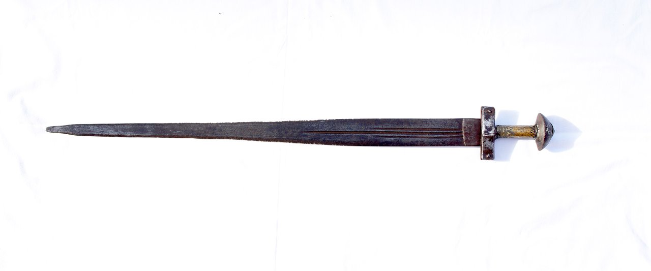

Now this is very interesting, especially as it is well established that the single edge blade is rather an anomaly among North African swords, as the broadsword is obviously favored. However, we know that with the brisk trade in blades through various entrepots there were occasions where these became mingled in the volume in whatever small degree.
We know that many blades, despite the more dominant input from Solingen, actually likely came from Italian sources which confluenced with the other trade networks inbound on occasion.
I would suspect this to be possibly a schiavona blade and of latter quarter 18th c. I will here go out on a limb with the inscription on the blade,
'ZACONA TOSCIANA'.
Clearly the Tosciana refers to Tuscany, but I would offer the speculation that the 'zacona' may relate to the Croatian/Slovenian word 'zakona' which loosely refers to 'law'.
We know that in Venice, the famed bodyguards of the Doge consisted largely of Dalmatian (Croatian) forces, and that the schiavona (indeed termed for this nationality) was quite well known in their use.
Perhaps this inscription might relate to some force or unit in Tuscany with some legal or enforcement capacity?
Whatever the case, this blade's terrible condition may be testament to its having been in this hilt for a very long time, thus, one of the much sought after early takouba with European blade. I would rely here on Iain's view on the character and likely age of the hilt.
My question would be otherwise, why would someone mount a virtual relic condition blade in a takouba? The tribesmen in these regions take great pride in their takouba, and would deem such a sword very poorly.

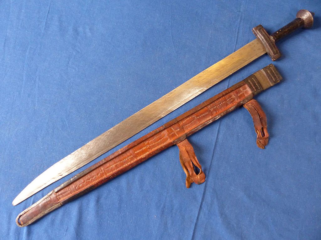

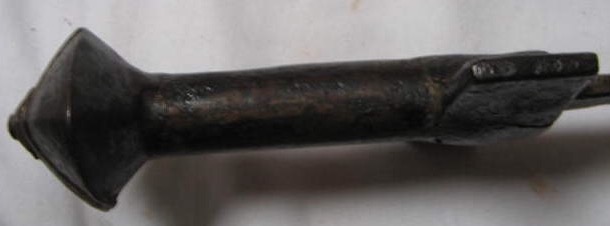

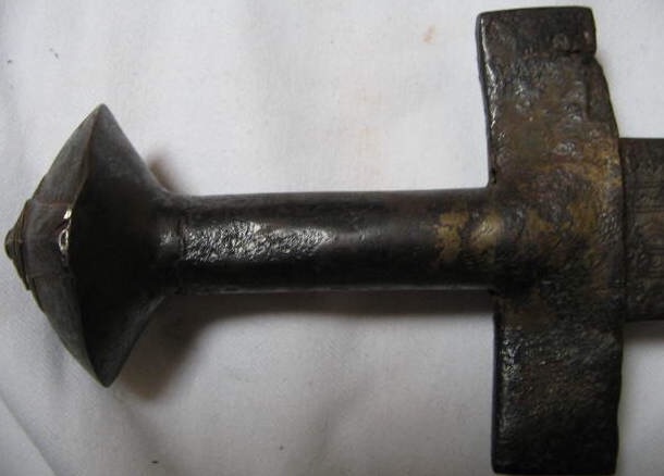

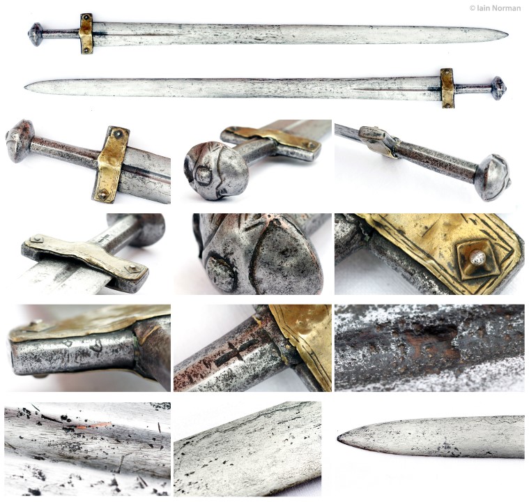

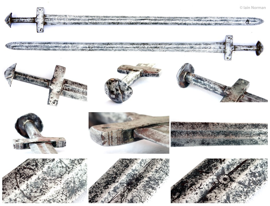

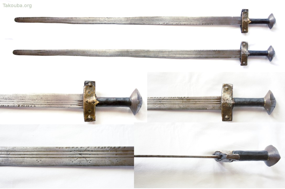

The hilt is old, although not the oldest style I think we can identify. I think it has been with the blade since it was first mounted.
It is very hard to put a date to the hilt styles other than old, older, oldest type classification.
You have what I tend to think of as the second oldest style. The pommel is large but more of a lozenge shape than rounded. A medial ridge is defined. The guard is not boxy, but rather a wing shape, swelling where it meets the grip. The grip tube is round, not multi faceted.
Zacona I think will refer to the town, the phrase would be odd in Serbian or Croatian and in any case would require a K not a C. The blade is of a type that was widely exported including the well known firangi swords of India.I own one similar, see attached. I think the blade can be older than the 18th century, but I am not the best for dating this blade style. Better images will help when it arrives.
I am including images of what I would consider to be older hilt styles as well, hopefully what I am describing is visible from these images. In any case I think the blade and hilt are an authentic and original marriage and the sword is an excellent example of a hilt that has been with the blade for a very long time.

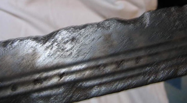

I think, it is an early Renaissance blade and one possibility could be, that this blade was found in a warrior tomb and was combined with a takouba hilt.
I wonder what can cause such massive nicks? Was he a guy like Bud Spencer?

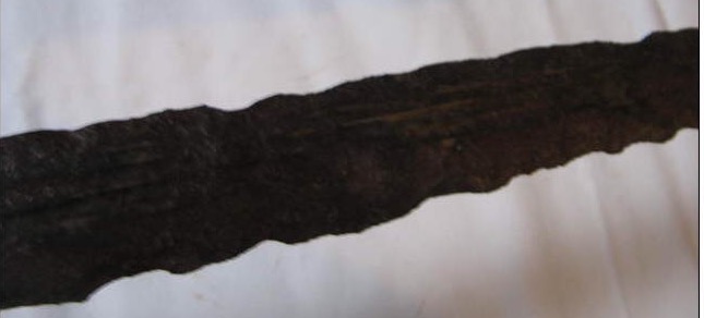

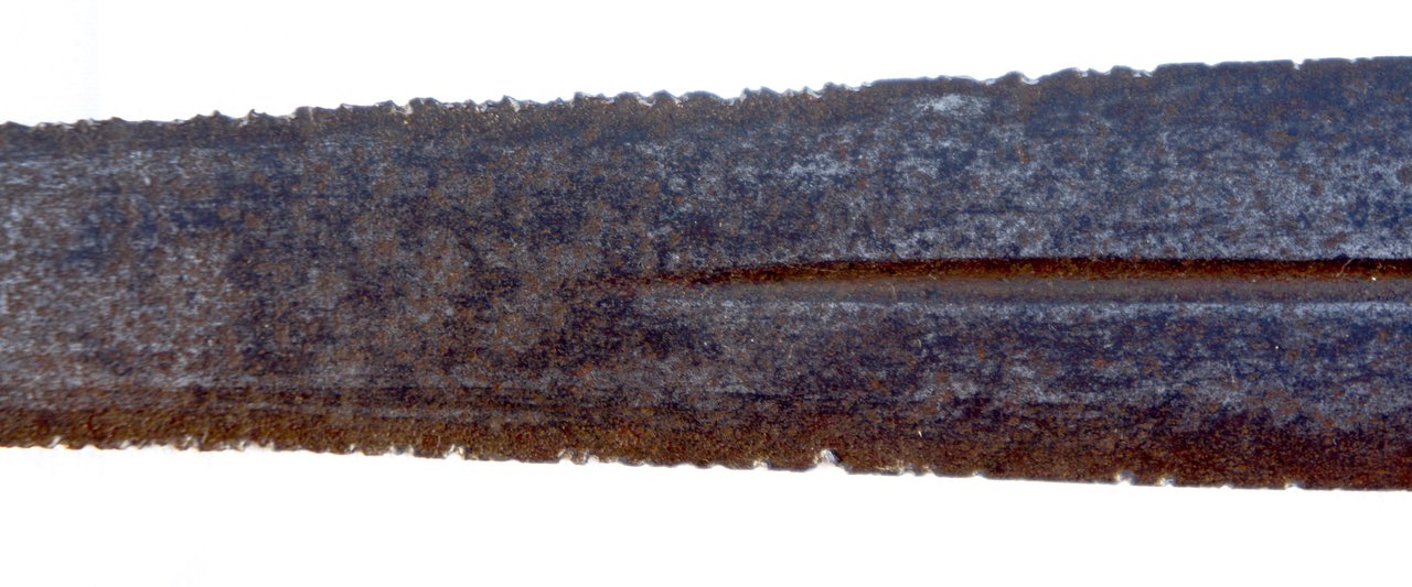

Those extensive and quite regular indentations to the blade on both sides seem very odd...
I kind of doubt if they were caused only by rust.

If it's from rust I wonder if the pattern is due to the way the blade was forged? Or did somebody beat on the blade? You'd think that level of abuse would have snapped the blade.
A combination I think. I have seen other takouba blades with abuse to the edge that looks more than just coincidental...

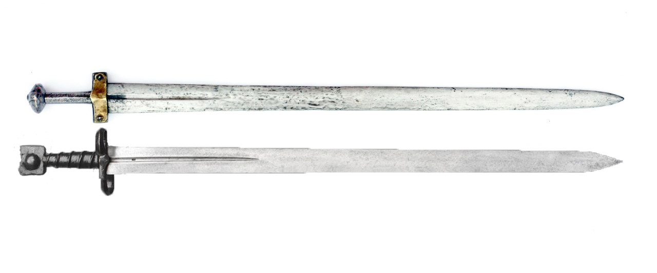

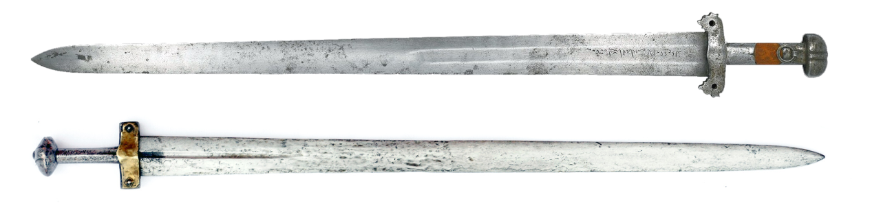

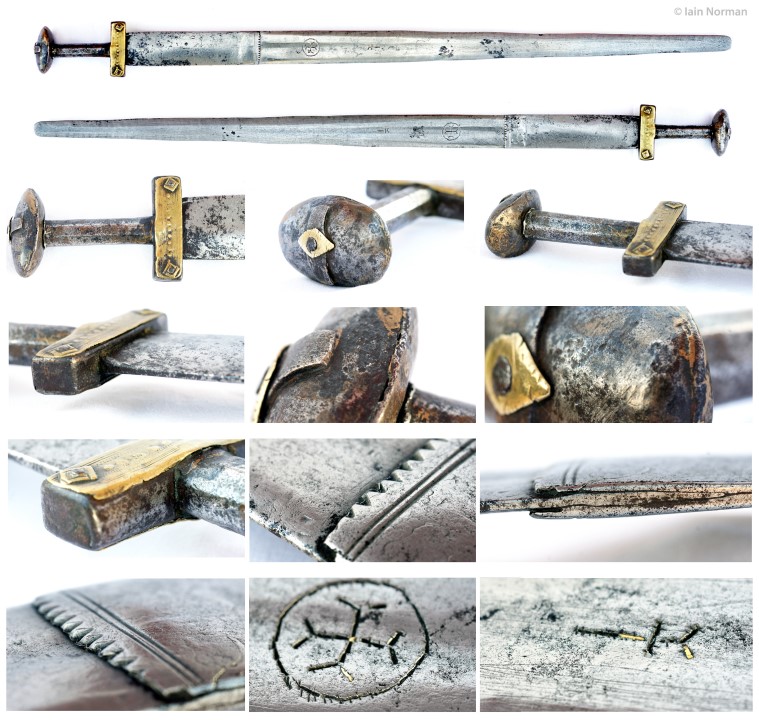

By exported I mean they were made in Europe, some were mounted in Europe, some were exported as bare blades.
As an example one of the swords I posted above next to a schiavonesca. The blades are marked the same, the form is the same, one spent its life in Europe, the other blade quite a ways away.
With a little time this summer I'll hopefully finish a longish article on this topic. There are interesting records in terms of shipments from Italy to Ottoman and Mamluk areas including blades and you find European blades being mounted in Mamluk mounts as well.
Note: for clarity the schiavonesca and the mamluk sword in the comparison images are not mine, but sourced from past auctions and used here simply to illustrate elements of the takouba form.
In terms of your blade and the examples I have given we are looking at earlier blades than the stereotypical patterns of the 18th and 19th century marked with elements like the ubiquitous half moons, made specifically for export long after those styles had past their popularity in Europe.
