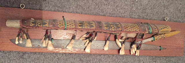

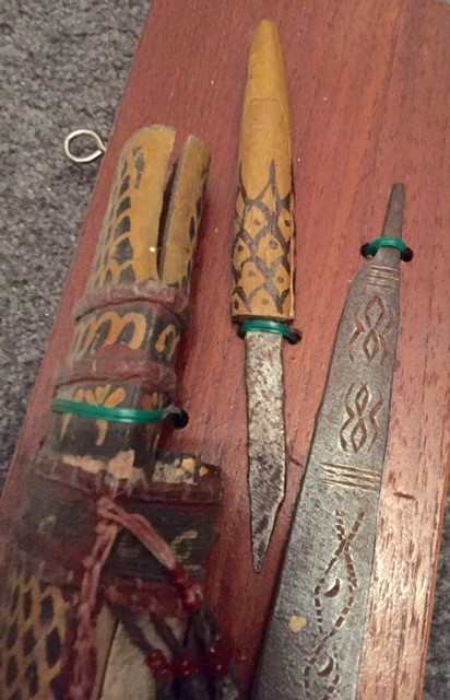

HAD THIS DAYAK MANDAU SWORD FOR SOME TIME NOW, WHICH HAS BEEN MOUNTED FOR DISPLAY BY PREVIOUS OWNER AT SOME STAGE
COMMENTS WELCOME

Unfortunately this mandau is a modern piece made for tourist.

Thanks Carlos I had it since 15 years but its good to know,as I better sell it for something Real,had no idea ,cheers
Old 16th May 2016, 05:35 PM   #4

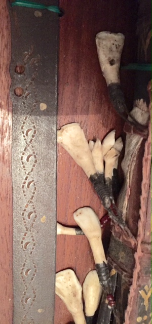

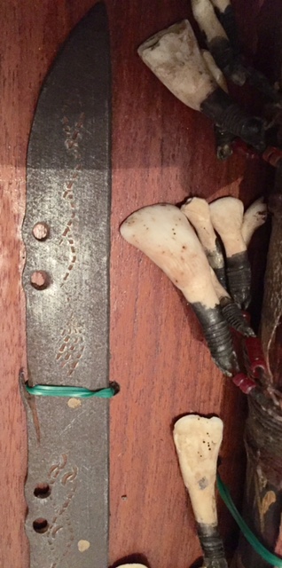

Quite a few low quality and/or recycled pieces got this "dangling tooth" treatment; not based on any traditional culture though.
I believe this was a fad appearing around WW2 and continued till around the Indonesian independance. Any confirmed later examples?

THANKS KAI GREAT INFORMATION,WAS TOLD THEY ARE HORSE TEETH,BUT UNSURE,LOOKS REALLY OLD ,BUT>????

It is amazing how many of these have shown up in reference books as antique and legit examples...much to the horror of those that know better.

I believe that many of these readily identifiable modern examples are actually made in West Irian Jaya (now West Papua). This was the former Dutch part of Papua-New Guinea, and was claimed by Indonesia when the Dutch withdrew in the early 1960s. Before claiming the territory at that time, the western half of Papua-New Guinea (i.e., Dutch New Guinea) had not been part of Indonesia. This was a major land grab by the Indonesians.
The poor blades on these mandau, at best "village" quality, suggest low skills in iron working, consistent with the proposed origin in West Papua. I think you will find that many of the teeth on these examples come from pigs--not large enough for horses and wrong shape.
