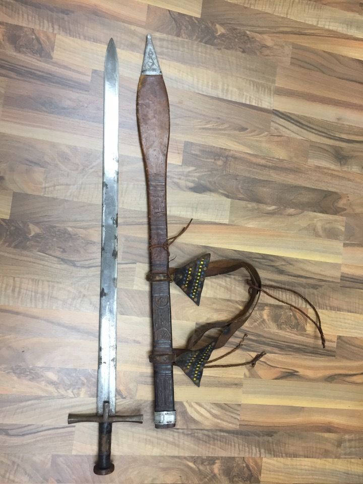

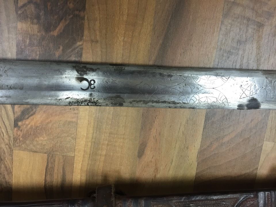

Just bought this kaskara at a price i couldn't refuse. it was listed as a 'turkish' sword...thanks for any comments.

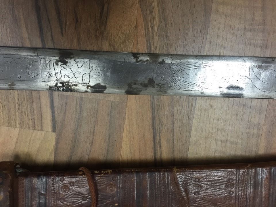

scabbard looks is in very good shape, as is the grip. should be with me in a few days when i'll add more info. interesting inscribed decorations on the blade appear to be a bit crude in european styles with some 'arabic' (ersatz?). one deep stamped mark in the fuller near the grip. is it a 'fly' variant?

Nice sword no doubt carried much, and likely used little although the heavy sharpening could indicate considerable use. Simple leather covered grip top suggests that a Hadendowa tassel once adorned it. Similar to those carried by the lads in the 1920-40 ethno-photographs in another thread.
I would say locally made blade due to the surface texture and what looks like a forged fuller. Also, the fuller appears irregular. The mark is a variation on the Fly. I have seen similar designs on blades made in Kassala. The inscribed designs on the blade would have been added by the owner once he took possession.
Date could be almost any time in mid-20th Century. A close up of the cross guard would help although it appears to be a multi-piece forging which would support the early part of mid-20th.

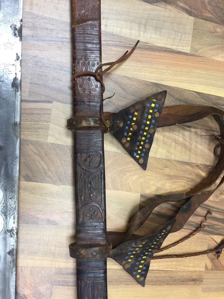

The scabbard is in good shape, but long term storage therein would make the blade rust as indicated by the black spots. Color (plastic?) tapes in decorative triangles also supports mid-20th.
Good addition to your collection.

The Edster is right about that scabbard. The tannic acid in compounds typically used to process raw hides into finished leather leaves traces in the material that cause unprotected iron or steel to stain or rust when left in contact over time. This is especially true with leather made in traditional societies in which the processes were not uniform or brought to a high standard. But you see this corrosion problem even on knives and swords from the industrial-era West as well. The general tendency is for blades to corrode worse when kept in all-leather sheaths, as opposed to metal or wood-lined scabbards.
Oiling the blade carries other risks, beginning with the tendency of leather to absorb it, leading to a darkening and softening of the material. Excessive use of oil causes the leather to eventuually rot and disintegrate.
The best remedy is to store your kaskara out of the scabbard. You may want to clean out any active rust from pitted areas (without refinishing the whole blade) and preserve it with a good wax. A common problem when storing and handling all-leather scabbards without blades in them is that they can become kinked since these sheaths have little sideways resilience now that they are a century or more old. Simple remedy is to shape a wooden lath to the same dimensions and shape of your blade, leaving it a few inches longer to serve as a handle for easy removal, and keep that in the scabbard so that it stays rigid and straight. Best to use a non-acidic deciduous wood like poplar or alder, which are relatively soft and easy to work, and won't react with the leather. (pine, cedar, and other woods from coniferous trees have a high acid content in their sap which makes them less desirable for the purpose).

What Ed said. Locally made blade. An attractive piece.

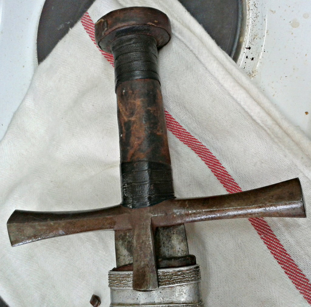

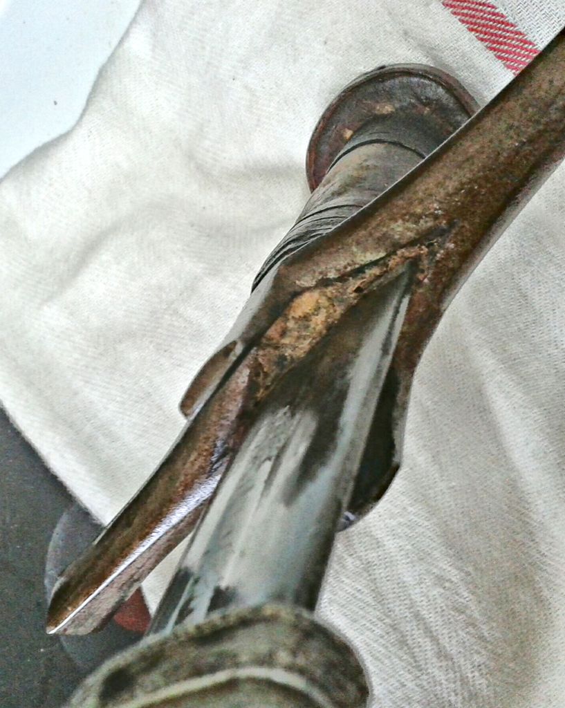

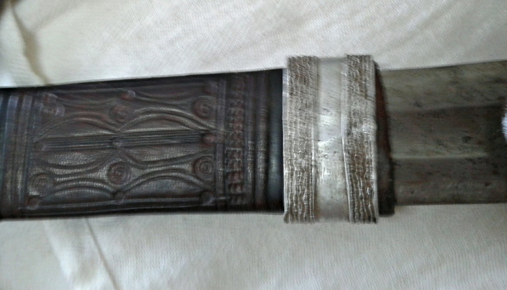

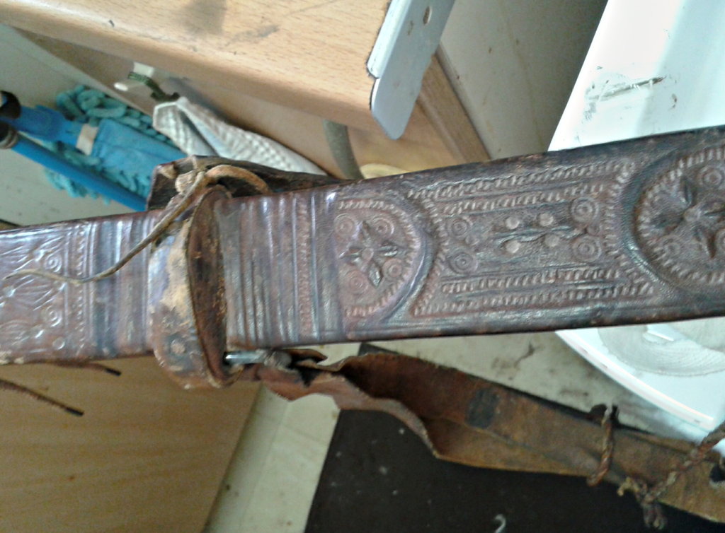

Old 11th May 2016, 01:04 PM   #5
kaskara arrived today, it's VERY sharp for the 3/4 of the slightly springy blade from the point. last quarter nearest the guard is unsharpened. leather strip winding over the languet on the grip and for the last inch or so of the leather covered disk pommel. the blue yellow decorations do appear to be thin plastic strips woven thru slits in the leather. couple of small areas along the edges of light active red rust. the black areas are very thin & not pitted there are a couple small areas that are pitted but appear the black rust form, not red. the guard appears to have been made in two halves and the arms forge welded together to fit around the blade & grip wood with a lenticular opening. the 'fly' stamp on the blade fuller is repeated on the other side, but under the blade side languet. i've brass brushed the red oxide and ballistol'd the blade & guard. fits the scabbard tightly, but seems to be loosening a bit as i draw & return the sword.
blade is 90cm. point to guard 140cm LOA. it's 4.2 cm. wide at the guard, has a 4mm edge at the guard slightly thicker as it approaches the wide fuller. blade is distal tapered. (can't find my digital micrometer ) sword weight is 950 grams w/o the scabbard.
some photos of the guard & grip area:

This may be an older sword, from the period suggested by Ed, and probably Kassalawi, where production was carried on well into the 20th century.
The 'fly' mark, is one we often refer to as 'the enigma' as we still have not conclusively resolved which possible European marking it might represent.
It is known to appear on much earlier blades (Briggs, 1965) which date back to WWI period. According to references once described by Ed some time ago, he indicated the fly was indicative of a warriors prowess, though not certain the exact mark referred to...it would seem this one.
The scribed markings on the blade are quite modern, and probably added in a commemorative sense.
The moons represent the 'lohr' or prayer panels often seen on earlier in the century examples, many from Darfur (Reed, 1987).
The script may or may not be Arabic, out of my range.
The eagle is the emblem of the Democratic Republic of Sudan 1970-85, representing a secretary bird holding a Mahdist type shield, and alluding to the Arab Eagle of Saladin from the 1950s.
Despite the relatively modern inscriptions and that it is a 20th century sword, these North African swords clearly show that the sword still stands as an important icon of heritage in these countries. I recall once being told by a Fur tribesman I knew, that his father always had his sa'if (kaskara) on the wall, and took it down to hold or wear during important events or ceremony.

Jim, The script on the blade is Arabic but is upside down... I think it says Sudan etc ...somewhat like the Arabic wording on the Eagle insignia...
I am interested to hear what members reckon on the fly mark which is similar to a local letter or figure 8 shape.
