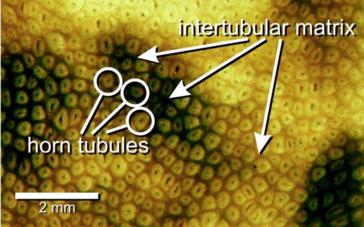

Each fibrous structure at magnification on end grain looks like a circle with a dot in the middle, rather like orange skin to look at.
Other than that I dont know of any test.
Much buffalo, goat & antelope horns can also be fiberous & often sold by unscroupolous dealers as Rhino horn. Especialy if of unusual coloring.
But magnification of end grain when visible reveals the truth.
I read lots but to be able to truly "see" it I had to handle authentic examples first.

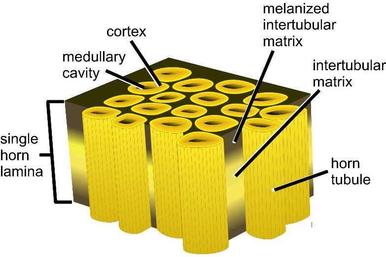

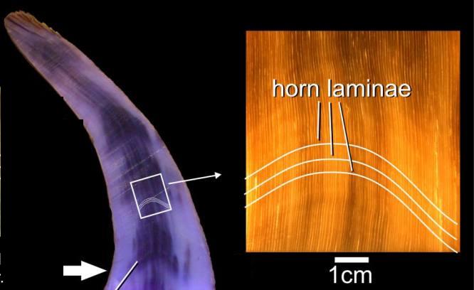

Hi Amuk,
perhaps these pictures will also help....
Regards David

Yep all horn contains keratin Tim, when burnt or if had boiling water poured over it most buffalo horn smells like an old farmyard full of manure & burnt hair. The same is true of rhino.
Thats a great picture Katana, shows the "orange peel" end grain structure well.
Sadley the fiberous side structure appearance is found on many horns that arnt rhino. I find one has to find where the grain runs out to get a true identyfying piece. But as Rhino is solid it never needs a buttcap on the handle anyway.
