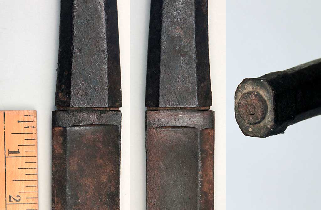

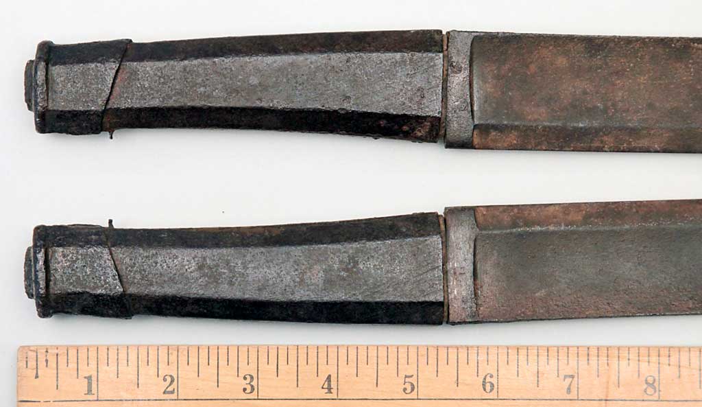

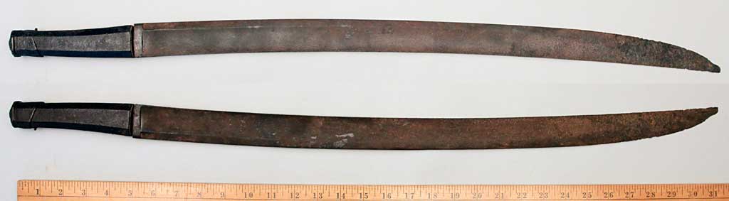

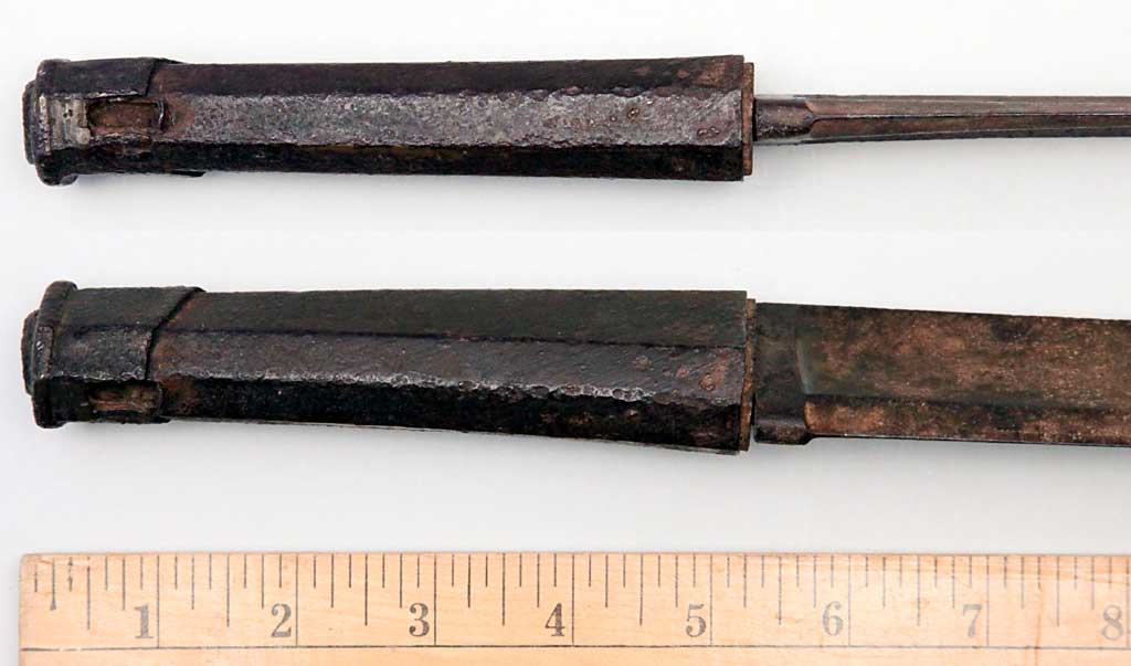

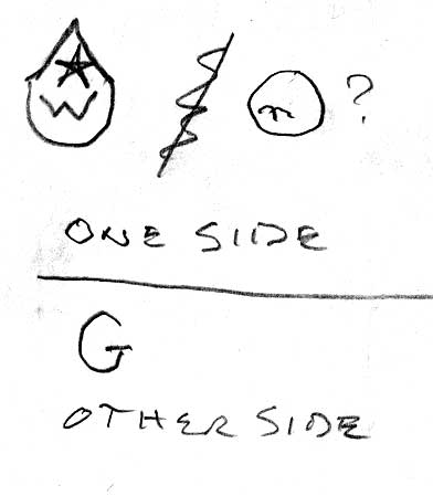

A friend found this saber in his grandfather's barn in northeastern Pennsylvania, probably about fifty years ago. The blade is 26¼ inches long with an overall hilted length of 36½ inches. There is a short ricasso with stamped marks - one is a W under a star within an impressed shield shape (not the teardrop as in the image below) and another much less well struck possibly with a P inside an impressed circle or oval. The opposite face of the ricasso appears to have a 'G' mark. The back of the blade is flat but it becomes sharp in the final 5½ inches. The body of the blade is mostly a wide shallowly convex fuller with a narrow bevel to the edge. The hilt is missing the guard (indeed, the hilt had been stuck back on backwards for longer than I have lived), but it is clear that there was a knuckle guard once that inserted into the pommel. The grip and pommel are covered in sheet iron which may be seen to be over a wooden core.
The blade looks to be of military type and I'll speculate later 18th to mid 19th century. I am not sure that I can place an octagonal iron clad grip, but that makes me suspect militia. So possibly something from the American Revolution up through to the War of 1812?
Your suggestions are welcomed!

it looks like the French naval sabre d'abordage model 1811 or 1833, apparently it was also in use in different countries.

As Ulfberth pointed out, this is the French boarding cutlass M1811 or 33 (so hard to tell those two apart!). Battara makes a good case for possible CW usage as well. If I had to guess, I'd say Civil War over War of 1812.
I am assuming by 'barn find' that it was hidden in the rafters or some such, versus just hanging on a hook? If it were in the South, I'd have laid odds on a Confederate piece. Like the American colonists before them fighting the Brits, times were tough and weapons scarce. Southern fighters often carried parts-swords or blacksmith made weapons into battle, such as the so called 'Dog River swords'. These weapons were often stashed in walls, under floors and in old barns to prevent them from being seized by Union troops as they made their way through the towns. I've seen swords from the Mexican War, French imported swords, etc, used by the Confeds. Being from PA, this logic doesn't quite hold, UNLESS it was a war trophy/seizure, which was also quite common. Being that it is the remnants of a naval sword, it very well could have been carried by a rebel blockade runner sailor.
From the look of it, the sword looks like it was still in use in its present form, meaning it isn't just a remnant with parts fallen off. Likewise, I don't think it's a post-war put-together made to whack cornstalks with. During the War of 1812, we weren't so desparate for weapons that we needed to fight the war (American contractors like Nathan Starr and Rose were putting out cutlasses in droves). The only final possibility is that it was a French used cutlass used by a French privateer. As a private purchase sword, it could have been a parts sword (to save on cost), made for the 1812 War (France vs Great Britiain with lots of French piracy going on). Well, anyway, my 2 cents...
