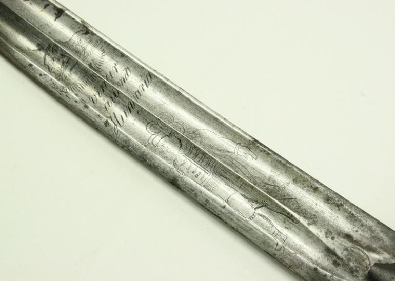

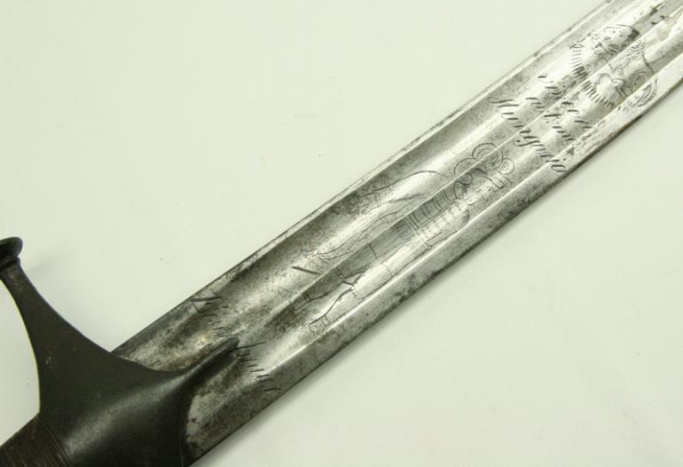

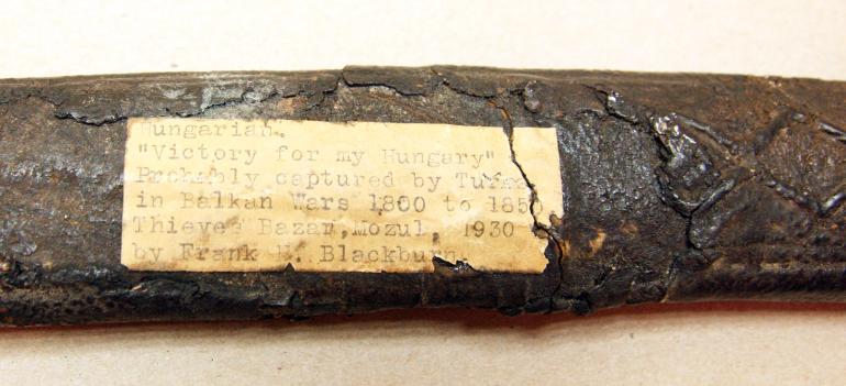

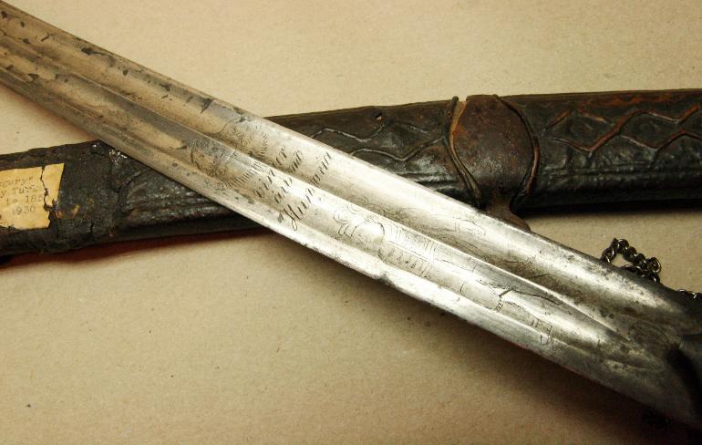

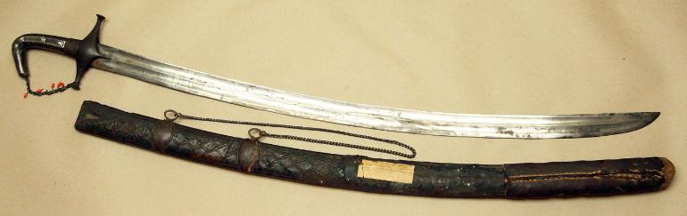

Just wanted to share the photos of this great sword with you. Even though this is not my area of collecting, I can appreciate the beauty of it. Blade is massive, 82 cm-long, almost 4 cm-wide. An interesting detail is the old typewritten label stating that someone named Frank F. Blackburn purchased it in Mozul, at the Thieves Bazar in 1930.
The blade is inscribed AUT VINCER MO HUNGARIA, which I roughly translated from Latin as VICTORY FOR MY HUNGARY, and is engraved with figures in hussar dress. Elgood describes blades like that as Majar, an Arabic for Magyar, which means 'a Hungarian' in Hungarian language. Apparently they were prized by the arabs for their quality.
I think the blade is probably earlier than the rest of the sword. I would date the sword to the 19th c., and the blade to 18th c.
Your opinions are welcome.

This is a fascinating example with some truly exciting potential!
Clearly the Syrian type hilt suggests Arabian attribution, and the Hungarian blade is well noted by Robert Elgood in his outstanding book on Arabian arms.
The collection tag is most interesting and I am curious about the rather broad assertion of being captured in 'Balkan wars' of 1800-50. I wonder of course which wars these might refer to, although obviously these were turbulent times with the Ottomans, and if perhaps an Arabian officer might have had this on campaign.
I agree with the 18th century attribution for this hussar type blade, and recall these same mounts and similarly inscribed Hungarian blades often misidentified as 18th century Hungarian sabres from years ago.

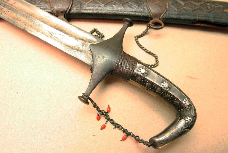

I also find the coral beads entwined in the chain guard interesting, and perhaps these offer possibility for the Balkan note as arent coral and turquoise often studded into certain yataghan hilts from those regions?

I would still like to know what significance with the coral beads in the chain guard. Some of these type features seem to occur in the form of small 'amuletic' type items in the chain, but often a string of beads in specific number are seen. It seems I read somewhere this has to do with religious significance in Islamic Faith.

I am not familiar with the history of Hungarian blade making, but I have no doubt that this blade was made in Solingen. It says Eisenhauer on it in large letters.
I don't think this was a dancing sword, unless it was a dance of death. One could take someone's head off with it in a split second.
It's a miracle the knuckle chain survived, most of these shamshirs that I've encountered in books and in museums had the chains missing, being delicate as they are. The beads have ornamental quality, pretty as they are, and maybe other significance, perhaps as the Islamic rosary beads?...
The inscription, badly spelled, should read VINCERE AUT MORI HUNGARIA -- conquer or die for Hungary. It was frequently used on northern and eastern European blades of the 17th and 18th cents. -- depending on the retail market for the blades, another country's name (frequently POLONIA) was substituted, or simply omitted. The occurrence of spelling errors may be attributed to illiterate artisans copying from pattern-books, and perhaps the general decline in the use of Latin outside of academia and the legal/medical professions in post-Reformation Europe.
Old 28th January 2018, 08:22 AM   #9
Kubur
Kubur's Avatar
Posts: 2,145
Ooopss I think that is an improper translation
Vincere aut mori is a latin sentence used by gladiators in the arena
its "Kill or die" (meaning), victory or death (litteraly)
its was then reused on many 18th European blades in French and Spanish too.
Another word was added a country, Patria or sometimes just the name of the king Roy or Rey... Then the moto became Nationalist...
