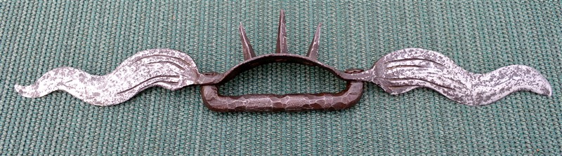

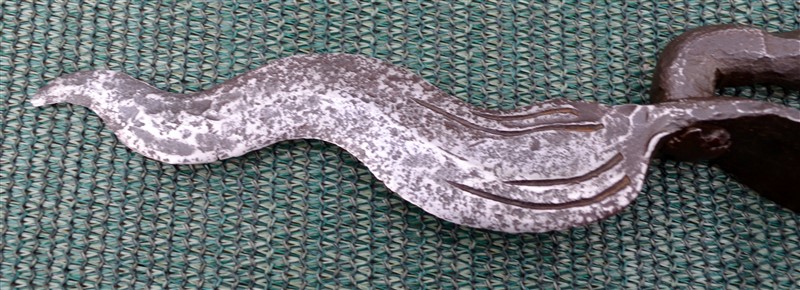

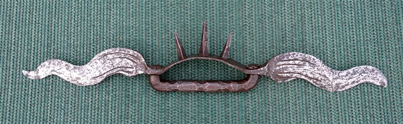

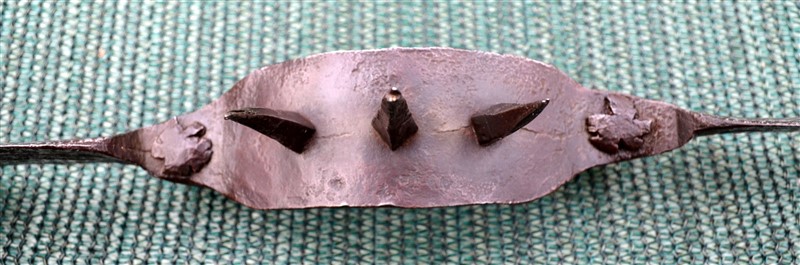

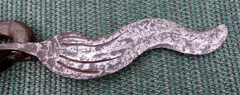

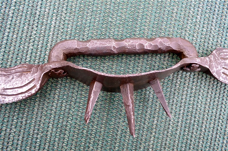

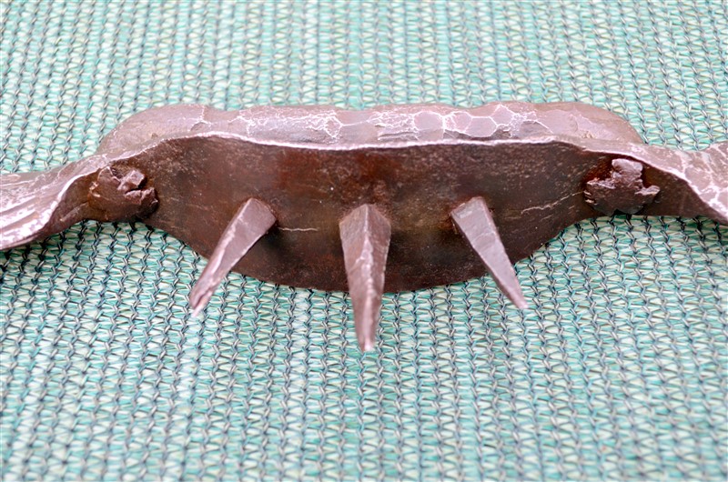

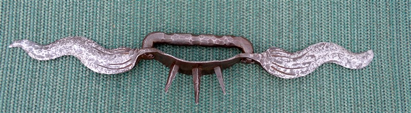

I think we can call this a haladie based on the fact that it has 2 opposite blades, however even though I have seen this weapon with a third blade, I have never seen one with 3 spikes and 2 blades.
It is hand forged and well made, but I am unsure how old this is or if it is a fantasy piece. I am seeing some interesting "old-new," items coming out of India recently, but I can not find anything like this.It measures 18" in length, the blades and spikes are sharp .
Old 31st January 2016, 11:02 PM   #2
you could poke somebodies eye out with that, as granny used to say.
bit crude, but i like it, not a parade piece, i suspect. how heavy is it? how's the 'feel'?
Old 31st January 2016, 11:31 PM   #3
drac2k
Posts: 1,334

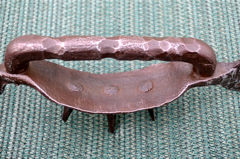

Very solid, about 1.0 to 1.5 lbs.It feels good, surprisingly comfortable to grip.I was wondering about the squared off handle, but after experimenting with it(playing),I found one could thrust with the weapon easily and the squared handle assisted in this.I think this would make a good Thug weapon and in close quarters be very effective !

This appears to be in the range of parrying type arms of India, much like the madu.

I do not doubt the ability of this haladie to inflict severe bodily damage, but ( just like Drac2k) have hesitations about its age and "historicity".
These days, anything that comes to the market from India as antique is suspect in my eyes until proven otherwise.
20-25 years ago many people bought "antiques" from China in good faith; this rapidly changed into " trust but verify" attitude; by now we all know with iron-clad certainty that everything coming out of there was manufactured last week at the latest.
As the availability of old tulwar handles in India comes down, we see more and more freshly cast ones. Taking into account ridiculously low hourly wages there, even seemingly reasonably-priced "antique" weapons must be bringing high percentage profits.
Caveat emptor!

There is a weapons called "vajra mushti" which is a nuckleduster that has spikes/blades etc at the nuckle and blades/spikes etc at either end, Jim already posted one variety. The grip of your haladie looks similar but with asymmetrical haladie blades attached.
As for the age, that is hard to tell, it has a very primitive/rustic look, not like most replicas that you might see lately. While researching an unusual symmetrical bladed haladie that I had a chance to look at I was told by someone with a lot of knowledge of Indian weapons this quote that may as well apply to your haladie as well.
Its not a weapon made that conforms to any I have seen before, nor does the style and construction method conform to known methods and styles. Therefore I would say it is either a village made item (amateur smith) or a modern reproduction.

Now that you have posted examples, I can see the similarities of the weapons; mine being the crudest of the lot.
