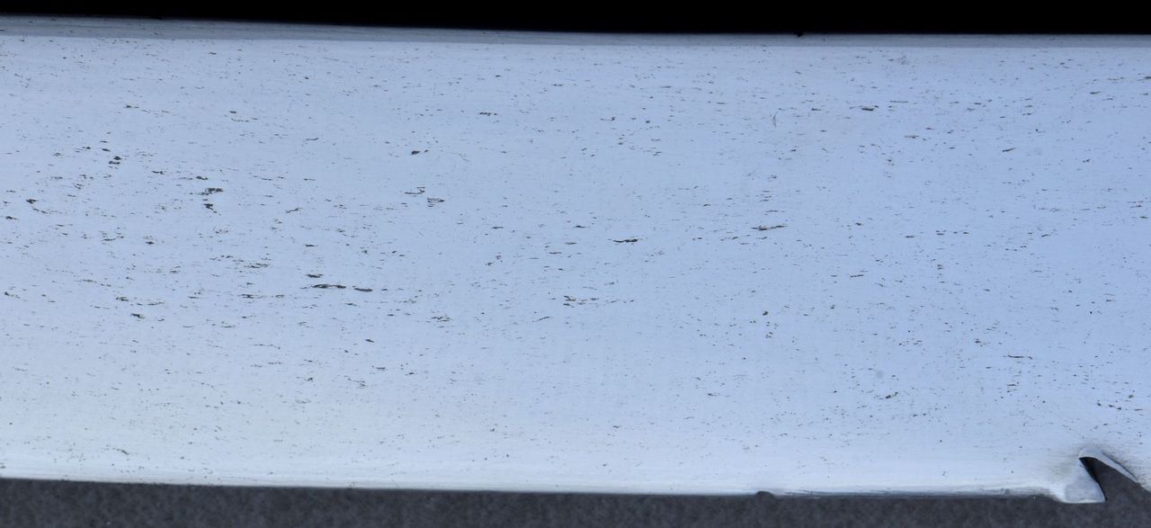

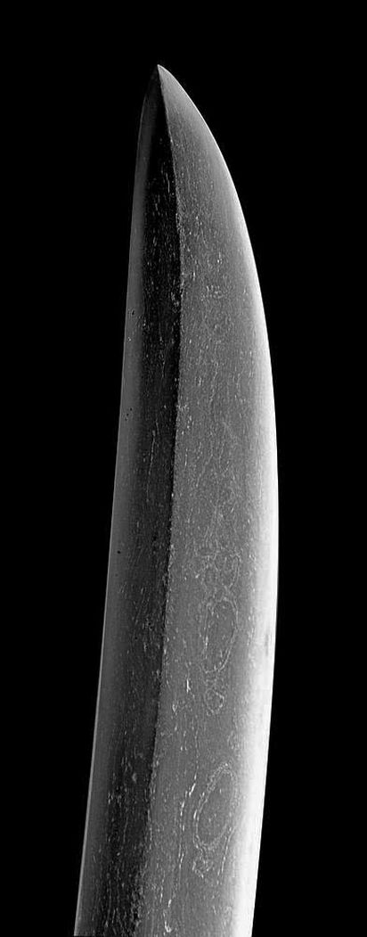

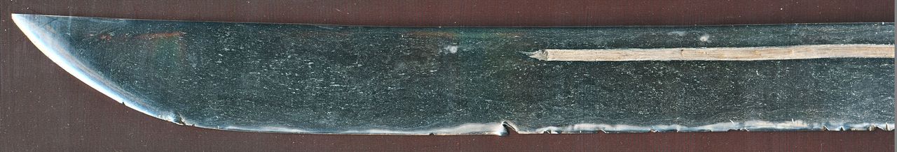

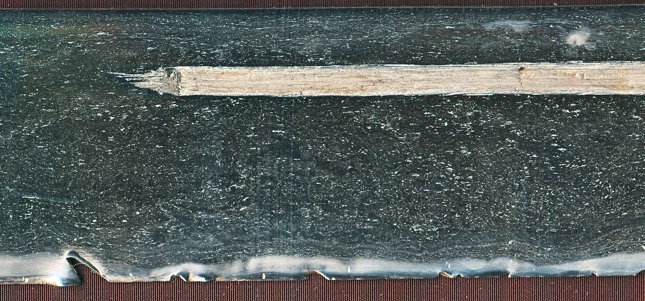

Hey Guys,
a few days ago I won this Dao for a very reasonable price. The blade itself was in pretty good condition with abolutely no forging pattern at all, only some deep nicks from earnest fighting. No pattern, no forging flaws. But it seems too old for a modern mono-steel blade. It was neccesary to polish the blade up to a grit of 2000, to see the first effects in the steel (picture 2 with silver steel).
After etching and cleaning, I was extremely surprised about the result. The surface looks almost like a clear sky at midnight, full of tiny stars. This is no pitting from corrosion, it has something to do with the steel.
I guess, this blade was made from chinese casted steel, similar like wootz but laminated and with a very narrow hamon.
The blade is heavy (71 cm without tang, 8 mm thick and 930 Grams blade only), very strong and tough together. This steel would be my personal choice for a heavy sword, it is absolutely reliable.
Right now only one side is finished, if someone is interested, I can show more pictures after I finished the work.
Any thoughts? This steel is completely new for me, so every opinion is helpful.
Roland

Hello Roland,
I don't think there is such a thing as cast steel. Due to its high carbon content, steel cannot be properly cast. If it can be cast, then it means it has a lower carbon content an we are talking about iron... cast iron more precisely.
But I believe I see clear signs of forging and possible lamination in your photos.

I have no idea about steel making in ancient China, it is pretty difficult for me, to gather informations about this interesting topic. It is easier to find informations about steel making in Borneo than in China. Do you have any links for me?
One reason for my guess that it is made from crucible steel (smelted in a pot and later forged out to a blade) is that the material behaviour is very similar compared to my Kilij and the reaction to the etchant is more like wootz than mechanical damascus.
I am sure, that this is high quality steel because despite of the very deep cut and other heavy notches, the blade is not bended or skewed.
Roland

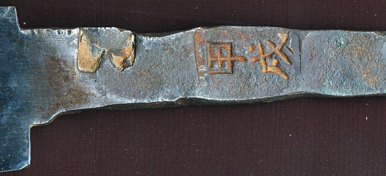

Originally Posted by benny.lee
There is no doubt that this is a Chinese DAO
From the point of view is "1754 DAO text"
Is the Qing Dynasty in China, 1814 OR 1874
I think he is an ordinary sergeant with a DAO
Hello Benny.lee can you elaborate please.
Are you able to read the mark at the tang? What tell us this inscription? What you can tell us about this sword?
Agree, a very interesting discussion.
Roland, are you going to restore the handle?

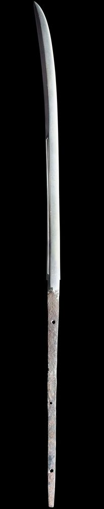

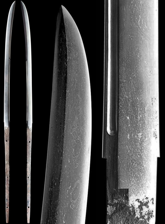

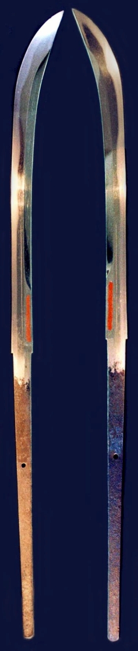

The inscription "1754" is a calendar, a 60 year cycle
On Chinese sword metal forging, the ancient no high temperature furnace, with charcoal as fuel, mixed with iron sand, after many times forging hammers
Posted pictures of the Ming Dynasty sword
benny.lee is offline   Reply With Quote
Thank you for sure.
This looks very similar to a Japanese naginata.
Yes in 16 Century, trade between China and Japan was frequent
But their use is different.
This DAO is used to Chinese equipment Navy, long rod, which can effectively attack the enemy in the boat

Hi Benny.lee,
thank you for the translation and the picture.
There is a second stamp on the hilt, which looks like a "B". Do you know the meaning of this stamp? A kind of military quality stamp like the Seki-stamp in Japan?
Hi Detlef,
yes I will restore the hilt, James is going to do the job. I will also search for ancient Dao parts.
Roland

Originally Posted by Roland_M
Hi Benny.lee,
Hi Detlef,
Roland
I think that's a flaw
Or a label, such as a workshop.
It is not a Chinese character
Thank you for sure.
Hello Benny Lee,
Looking at the photos of the Ming dynasty sword, I became convinced this is a Japan made Naginata, as one can clearly identfy the typically Japanese hada and hamon.
Please bear it in mind that at those times, weapons were one of the very few items Japan had available for trade and they traded them heavily with China in excange of various other items (silk, silver, gold, ivory, etc.).

Hello Benny Lee,
I have to agree here, it looks like a naginata, I would like to see if there are any other supposedly Chinese blades like this one, and how was it mounted in China.
