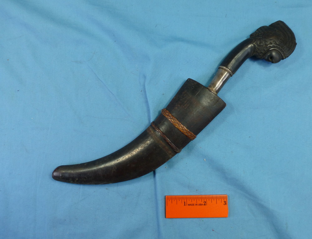

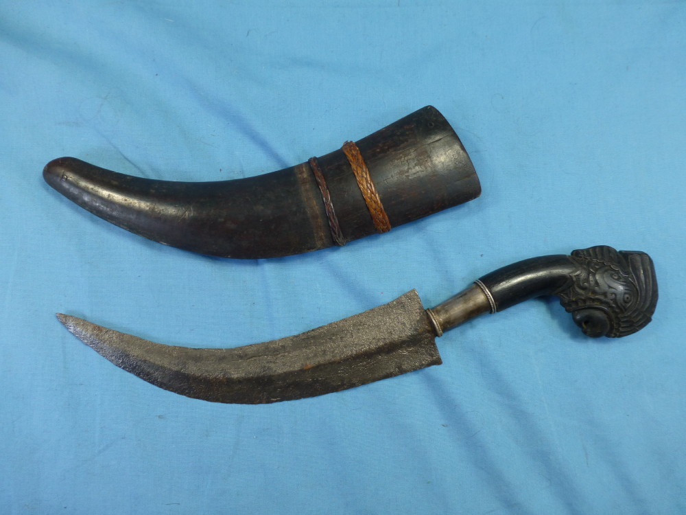

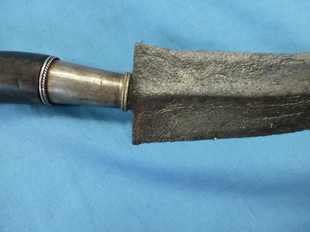

Artzi of Oriental Arms described this as:
“This Indonesian dagger in the style of an Arab Jambiya is likely to have come from Sumatra or Mentawi islands. This style of dagger is sometimes referred to as a Beladau.”
Comments?
Guesses on whether it would have been made for a native or someone originally from Arabia?
Guesses on age?

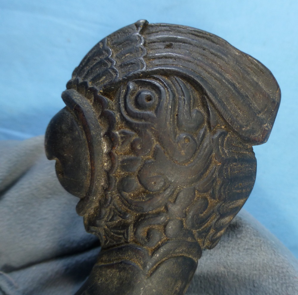

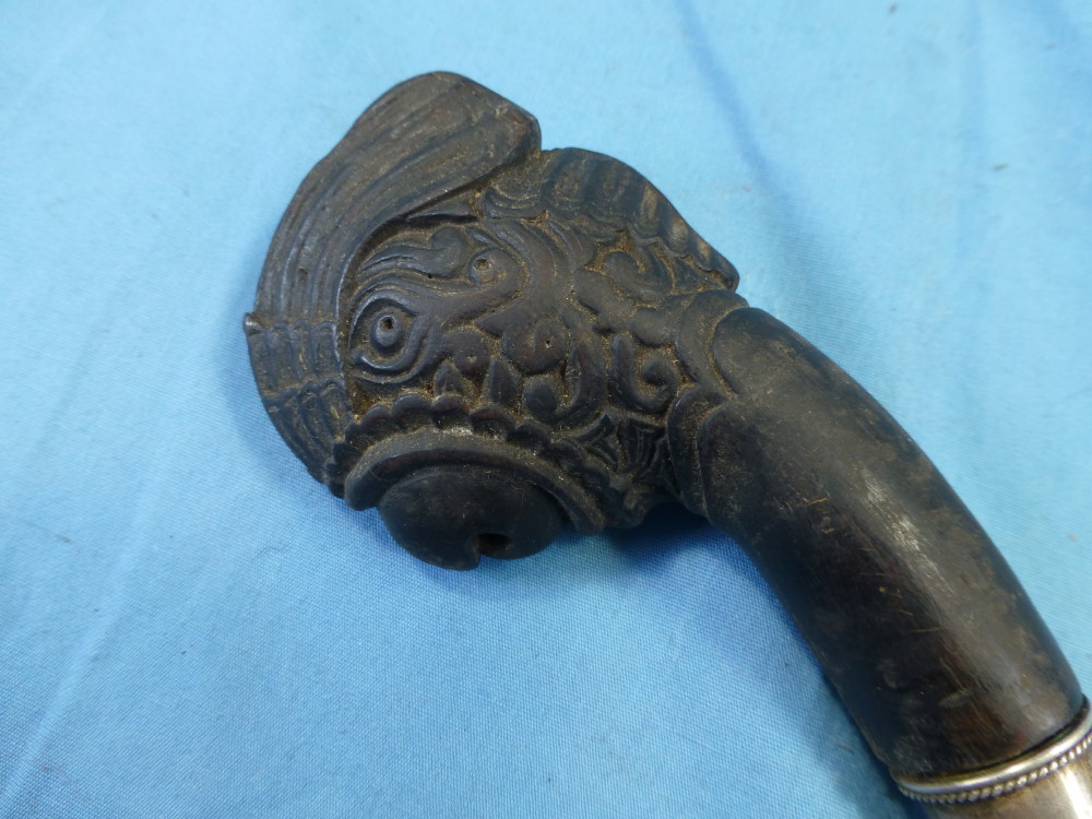

Hello Marcus,
I've seen this handle style by blades from the lesser Sunda islands like Lombok and Sumbawa. I doubt that it is a Mentawai dagger.

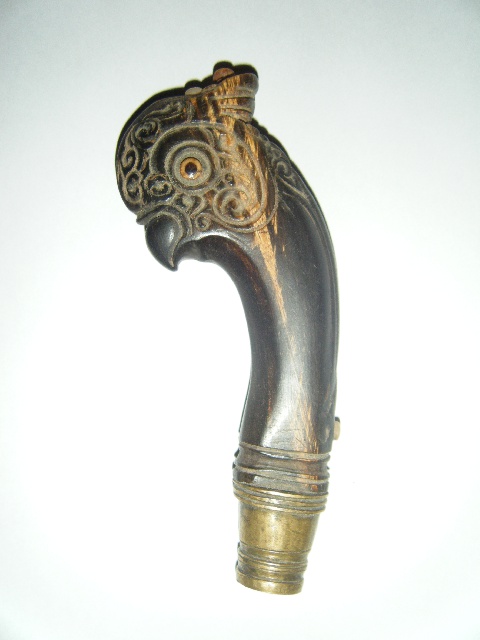

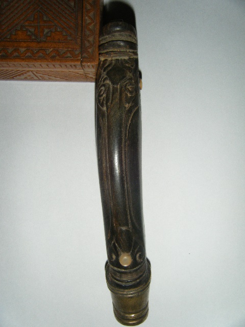

I've seen this sort of hilt with short pedang blades. I have a hilt in similar style in my collection but without blade. Will post some pictures later.
Old 27th October 2014, 06:53 PM   #6
Here my handle, approx. 14 cm high.

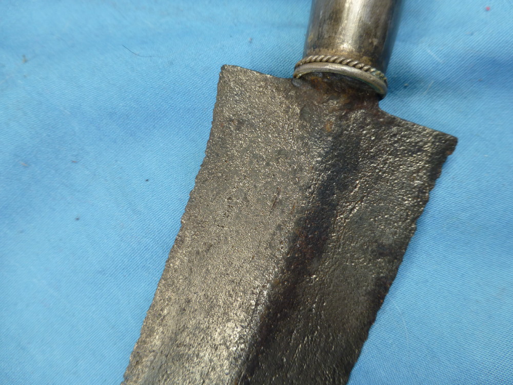

I see the similarity in the hilt of course, but to me the interesting question is whether the jambiya-like blade is indicative of a cross cultural effect.

Default Sumbawa
Originally Posted by Sajen
Hello Marcus,
There is indeed a picture of a sword from Sumbawa with a similar hilt on page 135 of the Van Zonneveld book.
