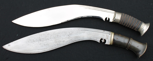

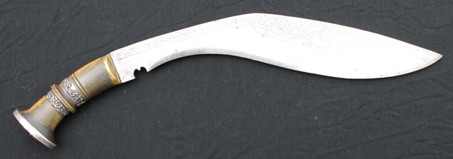

Below are two different styles of Officers private purchase kukri, manufactured by A.D.F.I&CO of Sialkot. Little is known about this company, but I have found mention of them making leather goods, officer’s swords, lances and other accoutrements from circa 1880-1930.

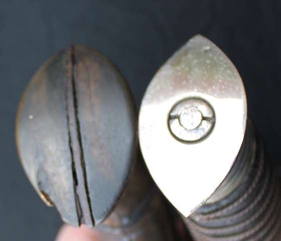

The first has nickel plated fittings, with a shagreen and wire bound grip, as would be found on officers swords of the period. The stepped hilt is fixed by a recessed pommel nut, like a MK1 issue kukri.

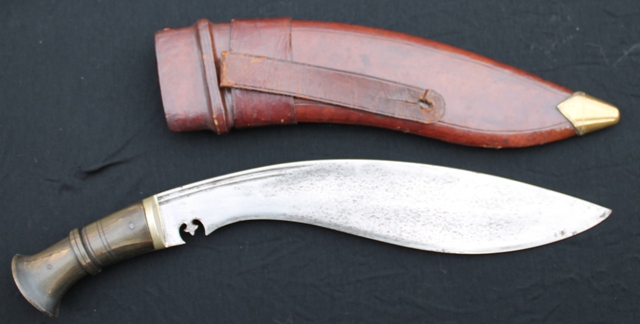

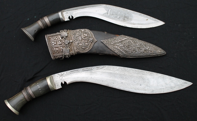

The second is similar in length and style, with a brown leather scabbard with brass chape.
It has a retaining strap fitted, again, like those found on officers swords scabbards of the period to fit a frog which could be worn on the Sam Browne belt system.
It has green horn grip scales fitted to either side of the full width tang.

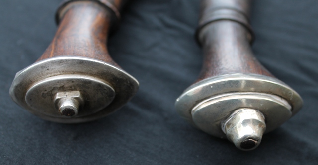

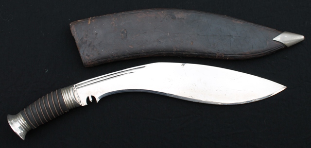

These next two are associated with the 10th Gurkha Rifles, and are of the regimental pattern for officers.
They both feature long Sirupate blades, although these two do show some differences in construction. They both exhibit stepped silver fittings to the pommel, in the form of a large stylised nut.
The scabbard is again fitted with straps for the Sam Brown belt system, once again more commonly associated with a British Officers Sword.

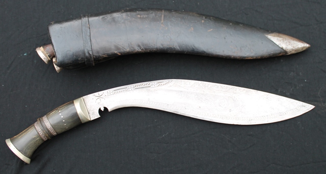

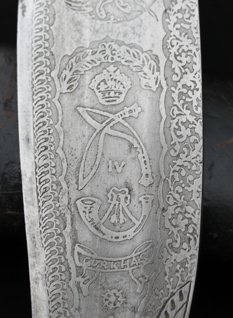

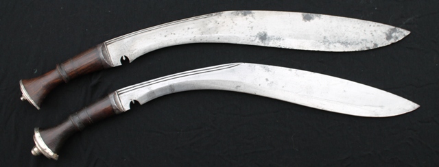

The next two examples are regimentally etched on the blades to the 4th Gurkha Rifles.
I have seen around eight of these over the years, some of which have officers names etched in presentation to the blade. They are all exceptionally well made, with horn handles and silver bands imitating traditional carved grip rings.
Some are found in elaborate silver mounted kothimora scabbards, others in plainer “field service” scabbards, with silver chapes. On one occasion the chape had been painted to “subdue” any reflection.
Again, like swords of the period, it is possible that these kukris were commissioned with both “dress” and field service scabbards. Both of my examples also come with silver mounted chakmak and karda.

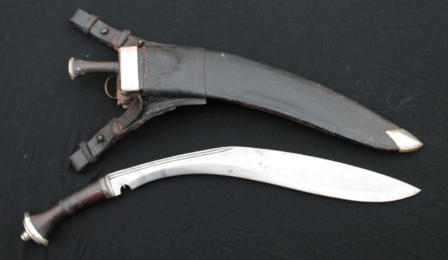

One last one for the moment.
This example may just be a one off presentation piece, with no sure attribution to an officer, but worth sharing here in this thread.

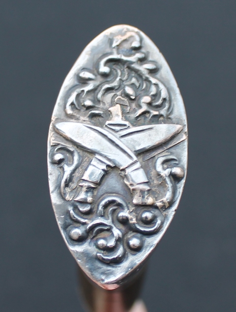

It has a horn grip, with a skilfully worked silver pommel cap displaying the badge of the 1st Gurkha Rifles, crossed kukri, with a numeral “1” below. Each side of the blade has also been etched with a kukri.
