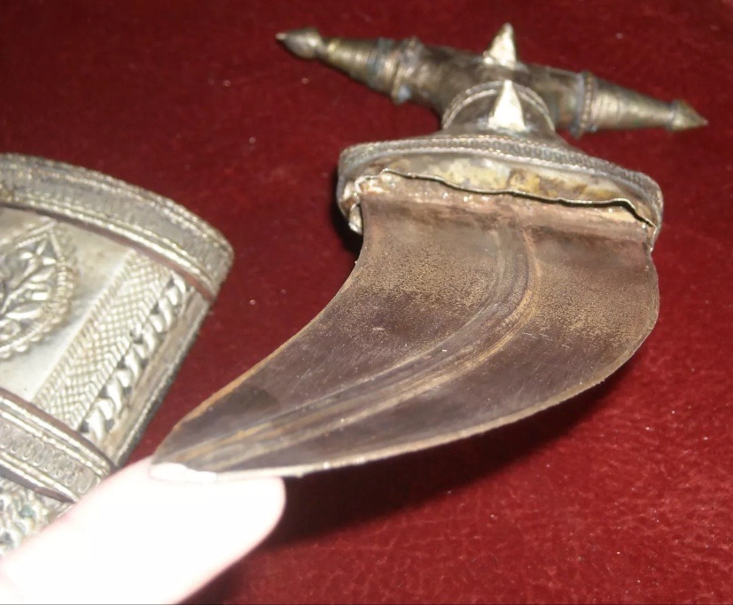

Default Jambiya blade mounted with pitch
Here is an example of what I am talking about. I find it diccifult to believe that the artist who made this knife, in all it's detail, would mount the blade like this. Personally, I think any Islamic weapon you find with a "pitch mount" is a weapon that has a replaced, or repaired, blade. I hope I am wrong about this.
Harry

Hi Harry,
Answer to #1 is yes and no. Most, if not all of my jambiya blades, including the very few late 19thc and early 20thc items I have, are mounted in this way, and "no" I do not believe it is a "shortcut".
Cannot help with #2.
#3....no of course it does not reduce the desirability or value of the piece. It is how it was made in the first place by the craftsman who did the job.
When you receive the book you have on order ("Jambiya from the Ancient Souls of Yemen") you will see on page 180 that the method of fixing blade to hilt is by "resin/wax mixture".....in other words pitch, or the local version of it.
Hope this helps
Stu

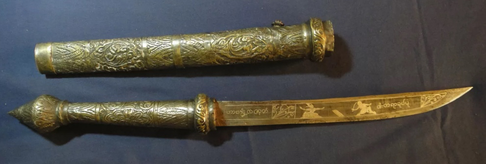

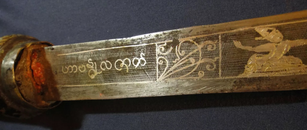

Hi kronckew,
Here is a Burmese Dha I have that may illustrate your point. Thanks for sharing this info. It helps!
Harry
