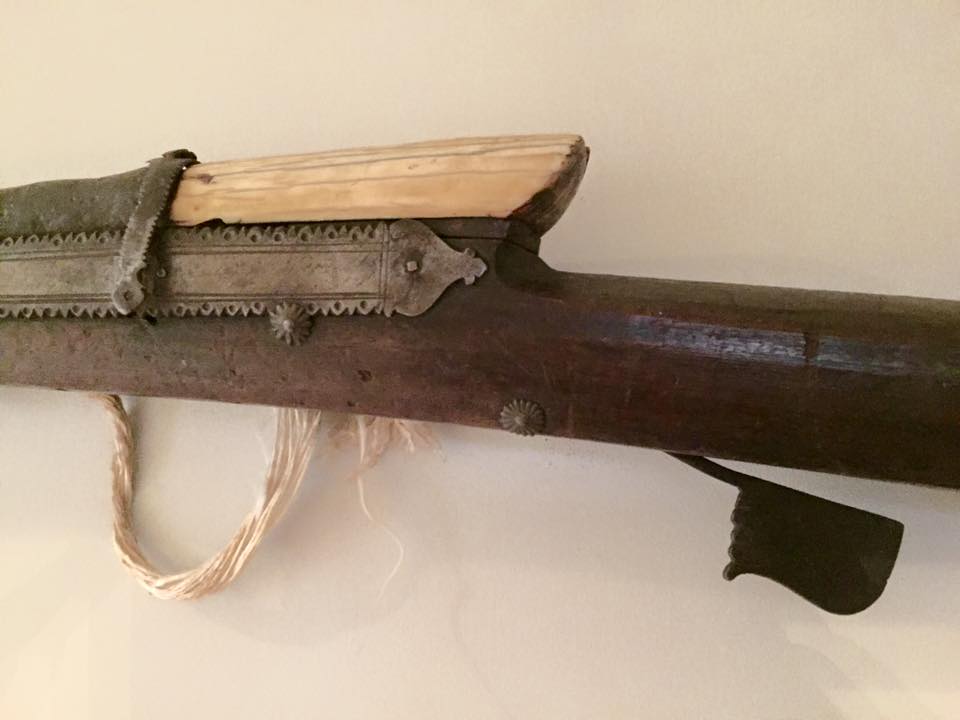

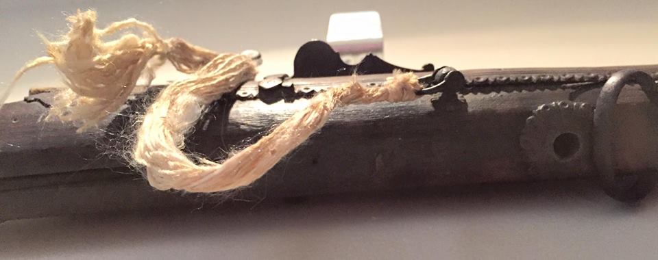

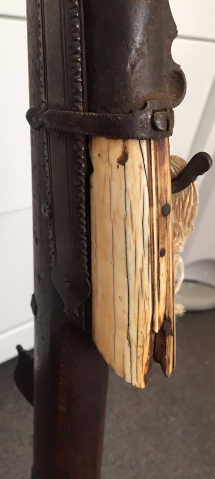

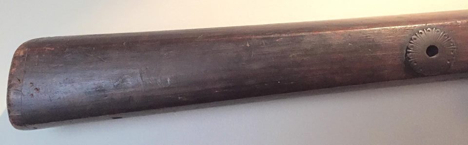

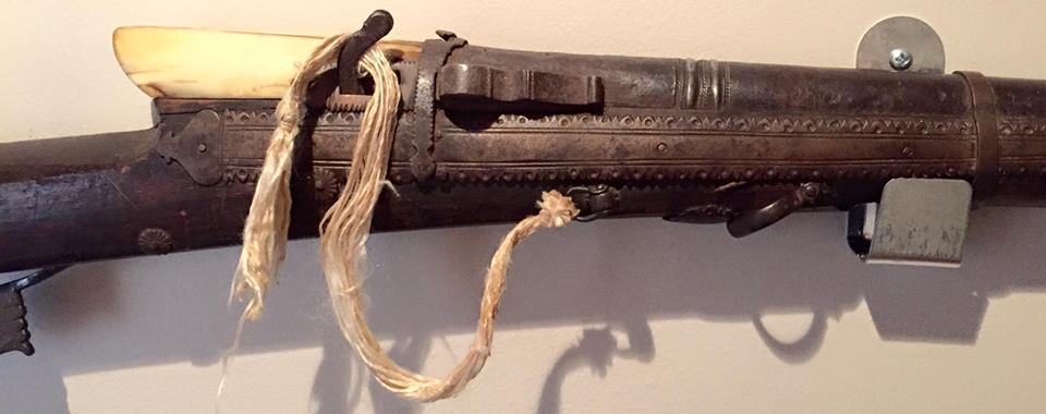

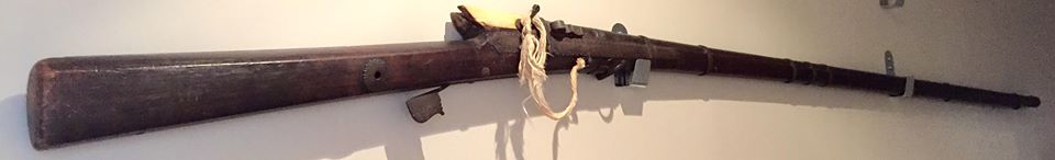

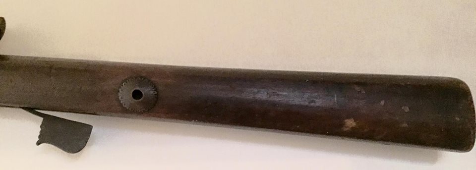

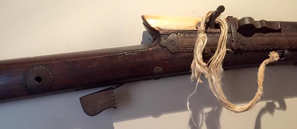

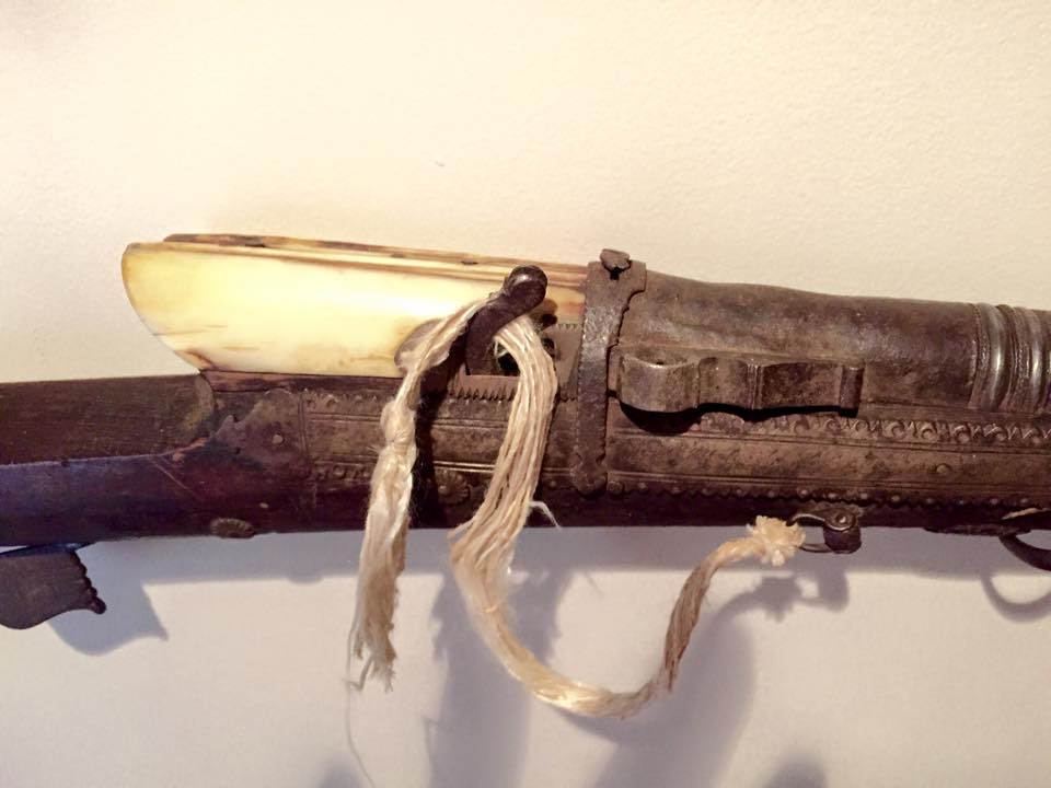

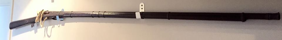

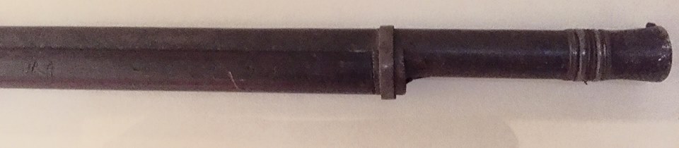

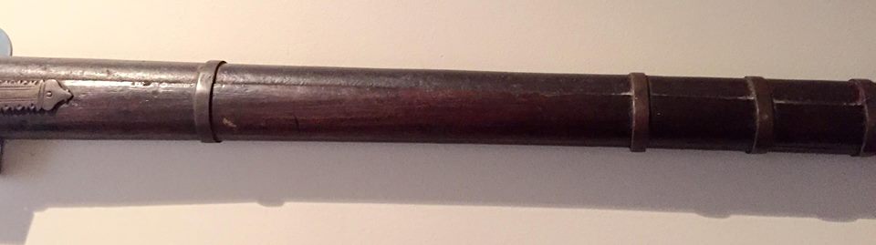

Indian matchlock musket or Torador
Early 19 th century,Rajasthan ,North west India.Ivory and silver inlays
190 cms long
Longest gun in my collection

NIIIICE!! Very nice piece Rajesh. Some cleaning needed but that is to be expected.

THANKS STU.,APPRECIATE YOUR COMMENTS,WISH I LIVED IN CHRISTCHURCH WOULD HAVE TAKEN SOME TIPS ON CLEANING,BIT SCARED SOMETIMES TO TOUCH OLD PARTS AS THEY CAN BE EASILY DAMAGED.ITS A VERY LARGE GUNA ND QUIET HEAVY NO WONDER THEY WERE CALLED ALSO AS FORT GUNS,REGARDS RAJESH

If you wish to email me with specific cleaning questions please do so.
I note that the trigger bar is obviously bent on your Torador. Needs to be straightened so that the trigger is inside the slot underneath, and more importantly so that it does not accidently get broken off.

HI STU,GOOD OBSERVATION,AM BIT SCEPTICAL ON ALTERING OR TOUCHING THINGS COZ A SACRED I MAY DAMAGE THE PARTS,BUT I GUESS I NEED TO START BEING MORE ADVENTURIOUS AND GET THEM RESTORED ,CHEERS

try to use Steel Wool from Grade 00 (fine) to 0000 (superfine) and german oil "Ballistol" (penetrating oil). Steel Wool is not expensive and causes no scratches.
Together with "Ballistol" (everytime after polishing with steel wool) and a lot of time, maybe you can see a damask pattern on the Barrel.

I agree. Do NOT use coarse abrasives. If you can get the barrel off then soak it in pineapple juice. That will also remove crud.

Hi Bandook. That is a really decorative looking Torador. And should clean up nice. My cleaning methods are similar to Stu's. Work's fine.

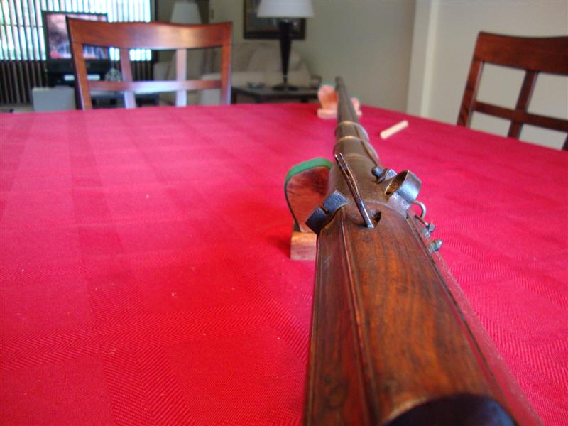

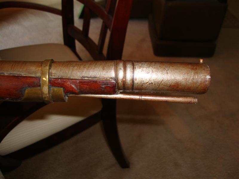

Hi Rajesh. Yes, I do have one Torador in my collection. It's in good condition as-is. But I've decided to make a shooter, so I will be taking the barrel off this weekend and sending it to my gunsmith. It will require the plugged end of the breech being drilled out, with the breech being threaded and a new threaded plug installed. Also, burnishing the bore clean and a new pan cover made. This will also allow the gunsmith and myself to see how the breech end of the barrel is designed. We will take pictures during the process, and I will post here as progress is made. Wish me luck!! LOL. The photos posted by Stu of his Torador was most helpful in this regard.

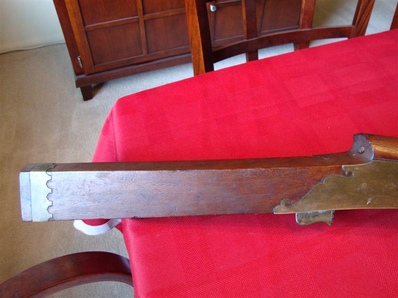

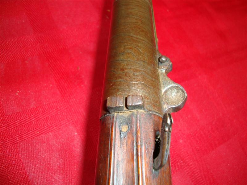

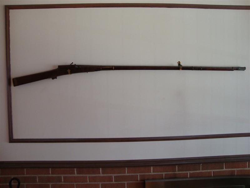

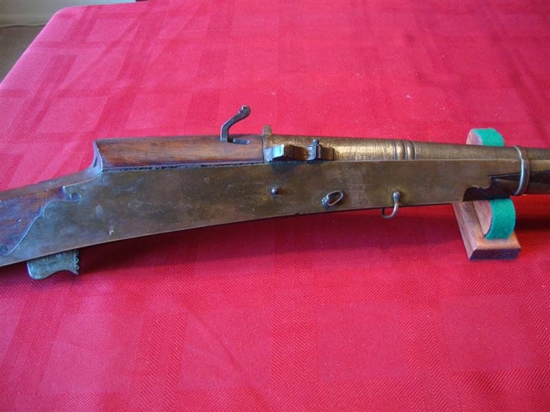

Here's a couple of pics of my Torador...

YES IT LOOKS IN GREAT NICK AND SHOOTING CONDITION,THOUGH I WOULD NEVER MESS WITH SUCH OLD GUNS,DONT LIKE TO RISK BLASTING THEM
