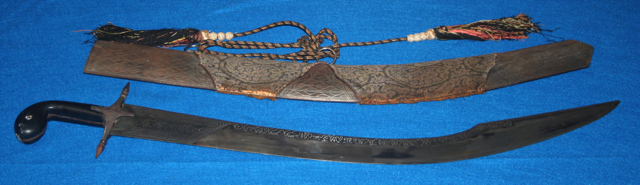

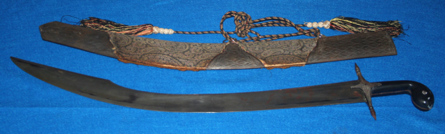

I recently purchased this Arab kilij. I am confident that it is authentic but don't have any idea how old it is. I know this type of sword was common during the Ottoman period, but that spans a pretty long time. Any ideas on how to narrow down the possible date range for this sword?

Hey Harry,
Sorry to say but what you have is a Syrian reproduction. Its new but once you receive it, take close ups of the blade and maybe there is a chance its a redressed old blade. But I dont bet on it :-)

Hey Harry,
I confirm, blade, guard, scabbard, grip, all recent. It's so hard to find these completly original... I almost fall in the trap twice this year...

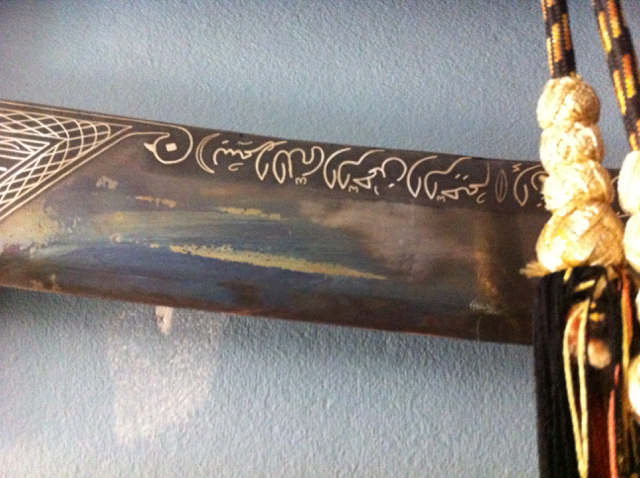

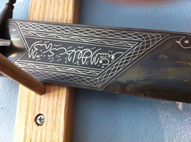

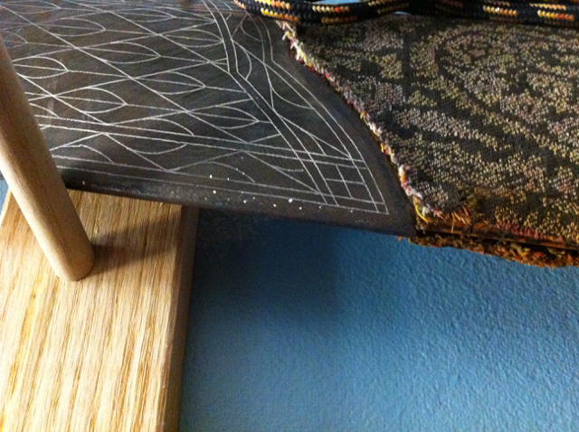

Thanks for the replies. I'm no expert so this could be a modern sword. If so, it is a good fake. The Damascene on the blade (photos attached) has been done the old fashioned way. What makes you think this was made recently?

Hi Harry,
Just write these key words on Google or this forum: kilij pala ottoman Turkish.
You will see the shape of the hilt, the style of the grips, the quillons of the guard and the blades. Very different. Nevertheless in a recent publication in Riyad, half of their swords were of your kind and they were presented as originals... But they were just recent copies. Everybody does mistakes. But the best is to research by yourself, never believe someone in this forum without your own research. I got some silly answers on some daggers and swords that I presented and some members were completely wrong. Its just opinions by passionate collectors. But unfortunately for your sword there is no doubt...

This time WITH the photos. I must be getting old. Thanks to all that have answered. I am still a little confused. I think this is a kalij from the early 20th century (last years of the Ottoman empire) and I think it was probably made in what was then called Syria or somewhere on the Arab peninsula. Am I wrong about this? Thanks again.

A.Alnakkas and Kubur are absolutely right. This sword was made in Syria in the late 20th, not early 20th century!. it is recent reproduction, not antique. the coftgari silver overlay technique has not changed since old times, and is being made right now using the same methods.
Thanks Alex, A. Alnakkas and Kubur. I am surprised. Someone really went to a lot of work to make this look old. I paid a nice price for it, although only a fraction of what I expect the real thing would cost.
