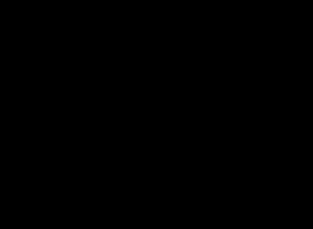

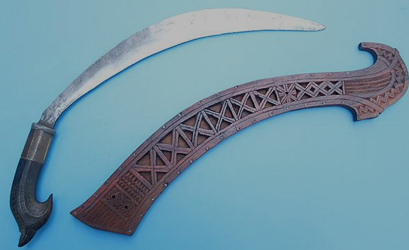

Just picked this up at an auction for little of nothing. A nice little Philippine utility knife with a 9 inch blade. This is the auction picture which is the only one that I have of it at the moment. Would like to know what the possible age on this might be. All comments are more than welcome.

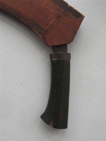

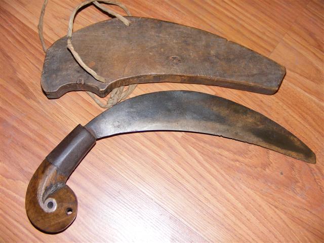

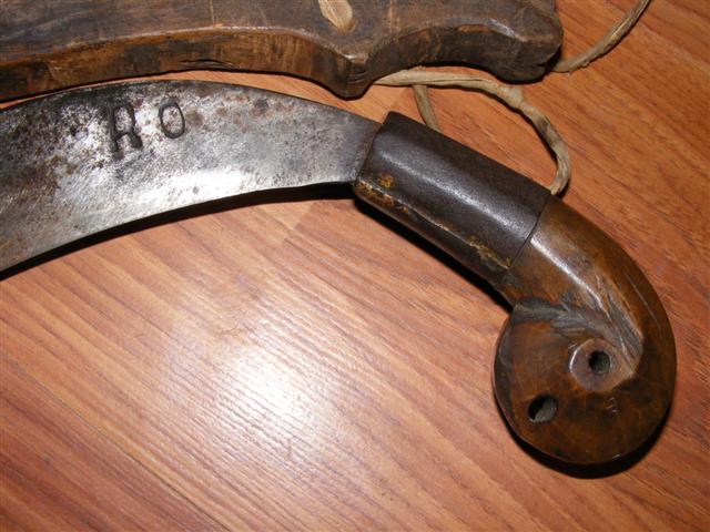

Forgot to post this picture, it shows the marking on the blade.

It is also popular in cutting the tender floral branch of the coconut tree to gather Tuba (local alcoholic beverage).
The sanggot is no more than 30 years old (I think), cast and dipped in used oil (subo)... see the black burnt oil trace on the initials and in the blunt part. The local term for the scabbard is called Tagub.
I have 2 of these in our home in Panay, I will ask who is on the initials when I get back home.

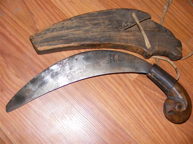

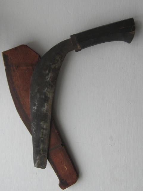

Though not as interesting to many as the more decorative items, I really like these and was fortunate enough to be able to add another of them to my collection. While posting I thought I would add a couple of pictures of the first one as well as the auction pictures of the new addition. Comments are always welcomed.

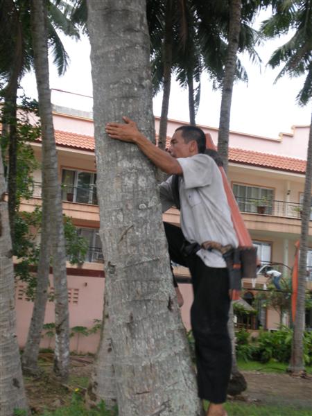

Here is a man climbing a coconut tree to collect tuba. Photo taken in 2010.

It is a tuba knife from Panay. This knife has changed little in the last 100 years, so the specific item we are discussing might be a lot older than 30 years. The newer ones (last 30 years) no longer have the characteristic rounded pommel.
The R.O. is most probably the owner's initials. I noticed that the scabbard (tagub) has "Ram..." incised on it. Probably for "Ramon". The "..on" portion appears to have broken off.
The tube gatherer is called a "manangguete" in Iloilo.

Nacho, Thank you very much for the information on this knife. What do you think on the age of the second one?

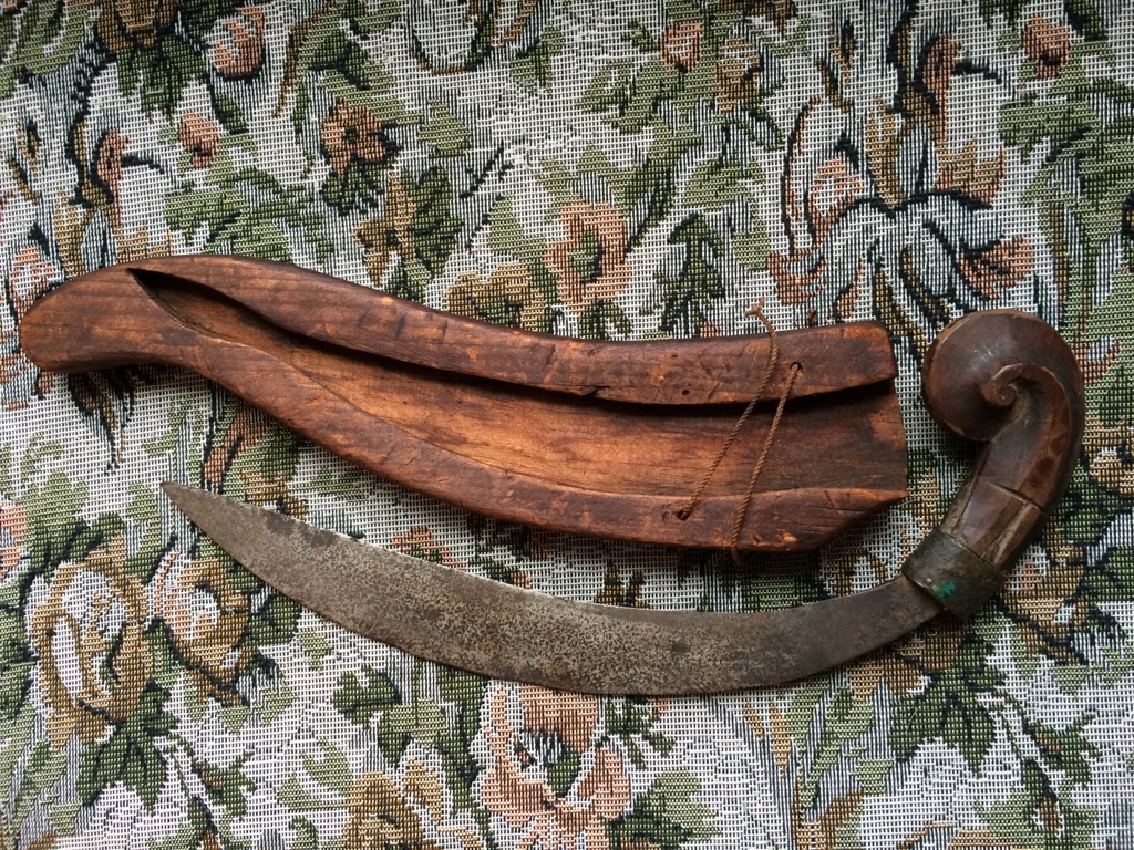

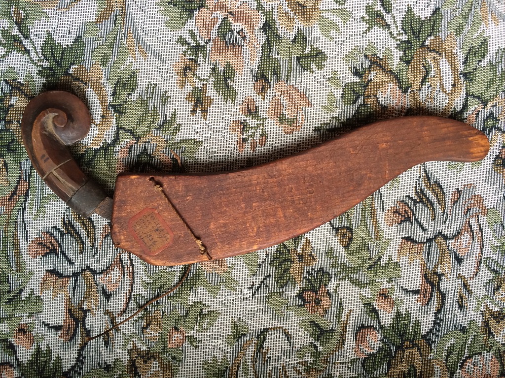

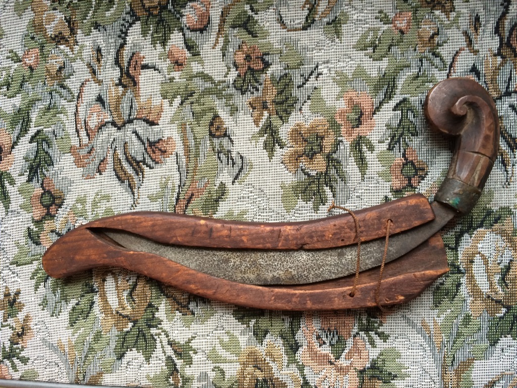

Please help me reconcile these (seemingly) competing identifications. Is my knife a Sanggot, a Tuba, or something else entirely?

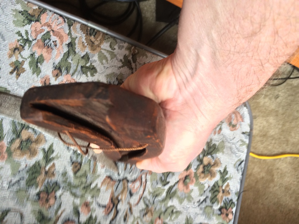

My knife is shown in the pictures. The hilt is 3 inches long carved in a floral motif that suggests the frond of a fiddle-head fern. The blade is 8 ¾ inches long, 1 inch wide in the middle, and just over ⅛ inch thick at the hilt with slightest taper towards the tip. The edge of the blade is straight, sharpened on one side only. The back side of the blade is convex continuing the curve originating in the hilt. The scabbard is very light wood yet remains in good condition. it is a single piece with an open area carved to accommodate the blade. The scabbard features a deep notch along the edge side of the blade, helping to secure it in the scabbard. A pair of very worn woven strings also spans the open side of the scabbard.

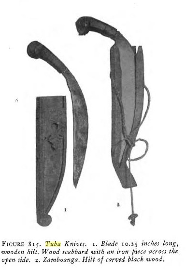

Stone p. 641 "A Glossary of the Construction, Decoration and Use of Arms and Armor" describes this knife as a "Moro Tuba" knife. Artzi at Oriental Arms also uses this term for a very similar knife (Item #11484).
However, the body of this thread refers to the knife variously as Sanggot or Sangot (meaning sickle). In the Philippines it is used to harvest the stalk of the coconut for use in making a local drink called — Tuba!

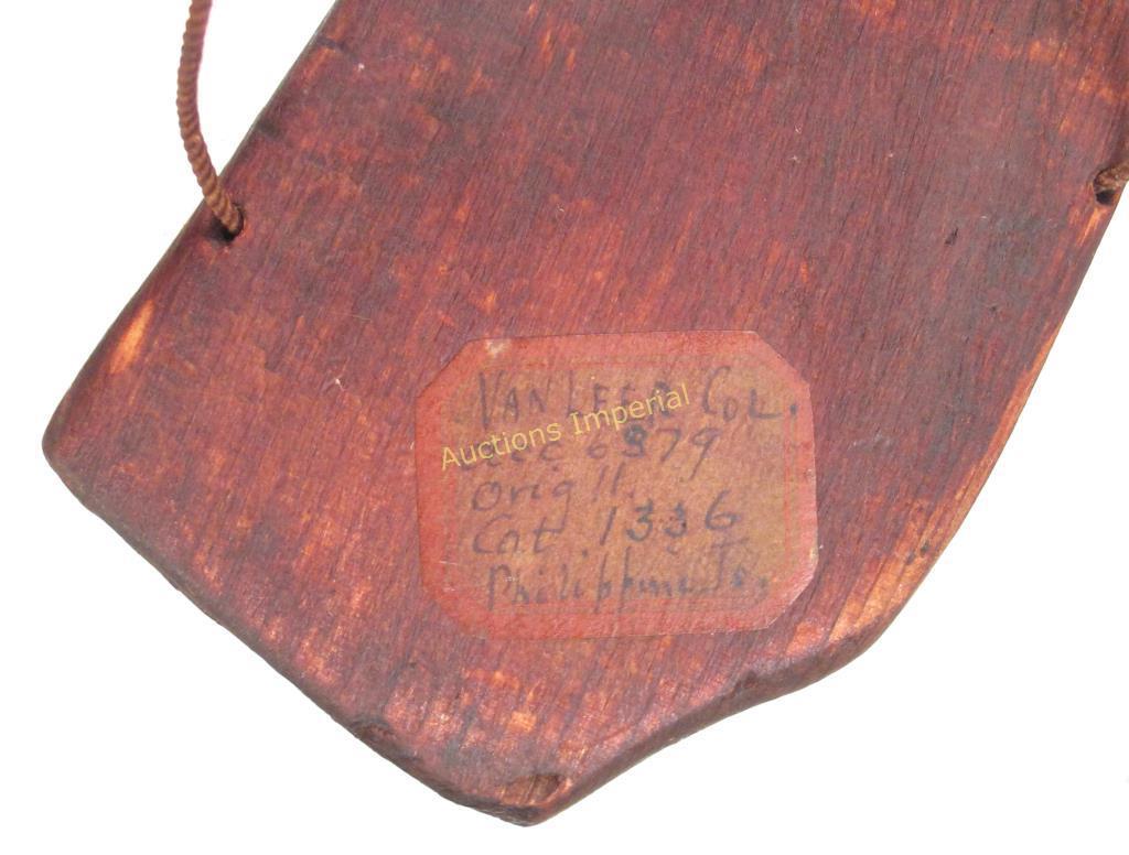

My knife has a very old collection tag on the back,
VAN LEER COL.
acc 6379
orig 11.
Cat. 1336
Philippine T??
"Van Leer" may refer to Captain Sam Van Leer, a volunteer officer serving in the Philippines during the "Philippine Insurrection" (Source: "Officers of Volunteers for Service in Philippines", Congressional Edition, Volume 5269, U.S. Government Printing Office, 1908 p.85). Other sources indicate Van Leer was on several islands, including Mindanao.
The principal morphological difference I can see between "Sanngot" and "Tuba" knife (in photos and as described) is that the Tuba has a straight blade edge that is perpendicular (more or less) to the hilt. Those labeled "Sanngot" are most often depicted with a concave blade edge. In both cases, the back of the blade is convex.
Although they may be used for the same purpose, I don't think these are the same knife. Could it be that only the Mindanao version has the straight edge?

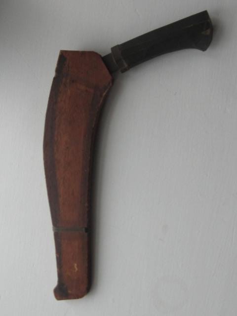

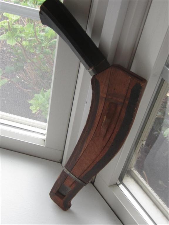

The term sanggot is Cebuano. I do not know the ethnic origin of tuba, but it is likely different. This is common in the Philippines where the same knife has a number of different names, even within the same dialect.
Incidentally, the last part of the tag on your knife reads "Philippine Is." standing for Philippinne Islands, which was their name during the US colonial period in the first half of the 20th C.
I have another example of this knife that has a talibon style hilt indicating an eastern Visayan origin. I have no idea what it might be called in Warai. Will post pictures shortly.
Ian.
