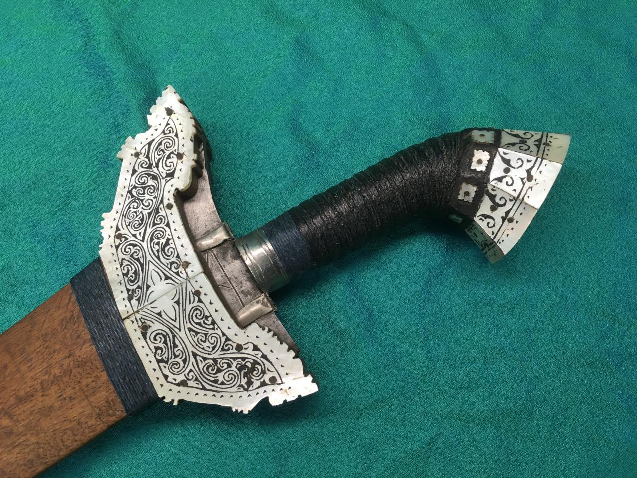

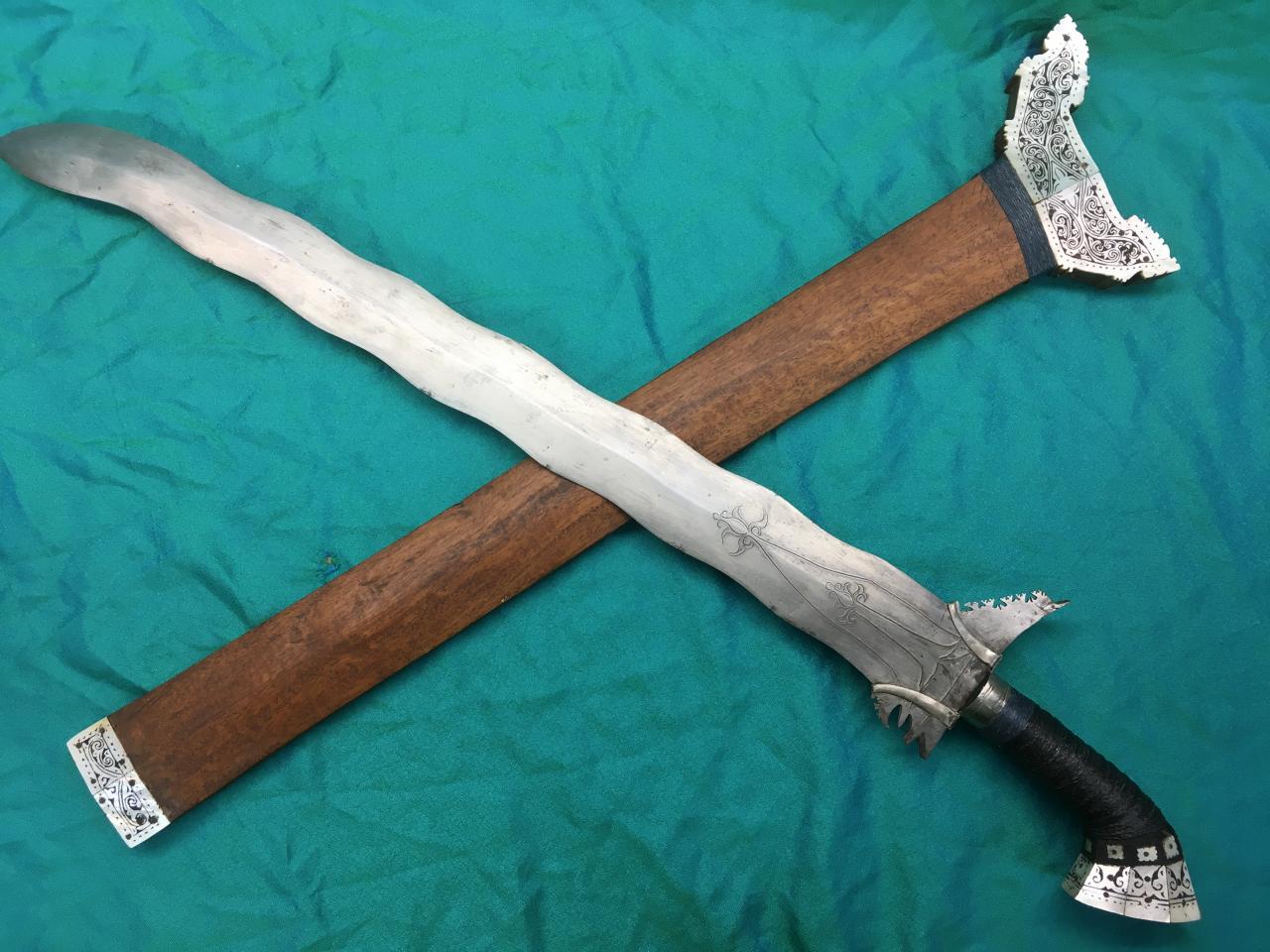

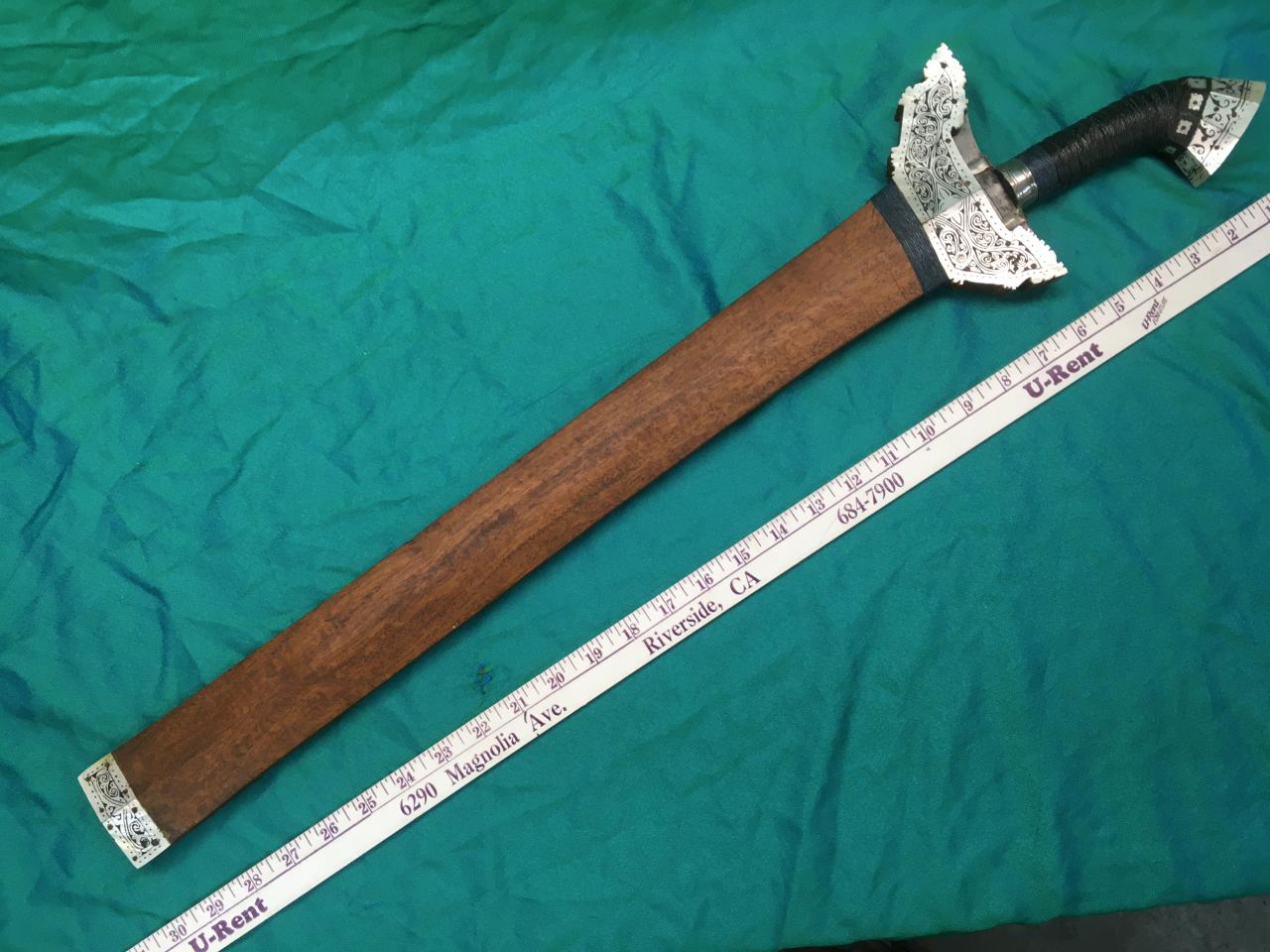

I have this large, long, heavy Kris. Based on my limited knowledge it appears to be post WW2. The blade is solid and very sharp. It does not appear to be laminated, but I haven’t tried etching it. Does this appear to be an actual ‘user’ or a tourist item? Again, thanks for any help.

I agree that this is a mid- to late-20th C kris, probably from the Sulu Archipelago. Even though relatively modern in manufacture, most of these were functional swords capable of inflicting harm. They represent a style of that time. The quality of the blades and the skilled crafting of the MOP decorations on hilt and scabbard make them fairly high end items for a tourist. They are neither cheap nor shoddy in my experience. That said, they are more "decorative" than I prefer, but that's just my preference and others may well see them differently.

Hi Protector,
I agree with Ian on most points. I own a similar kris, see here: http://www.vikingsword.com/vb/showth...highlight=kris
My one has a very massive blade which is clearly laminated and which is usable and I am sure that many in this style were in use but others were sold to tourists/collectors.
