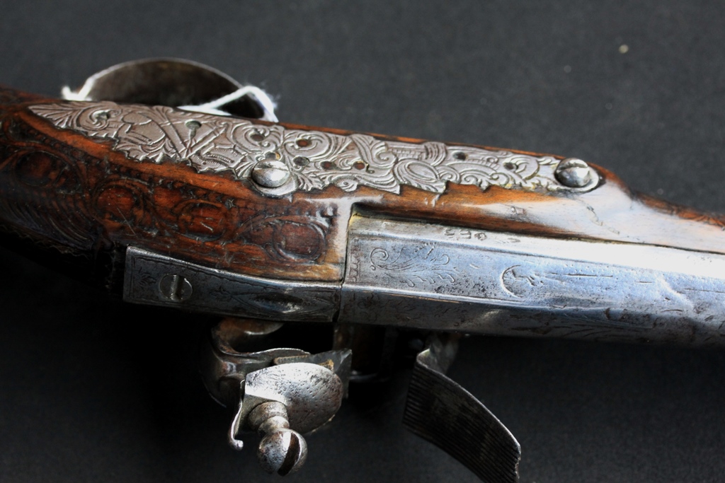

Default Turkish flintlock pistol nicely decorated

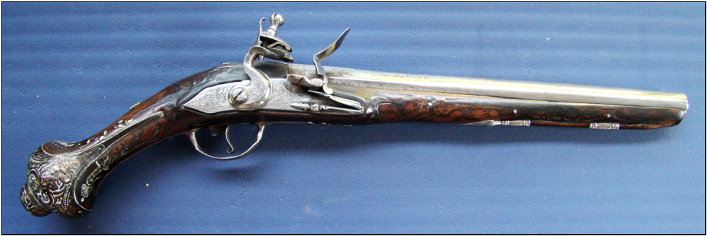

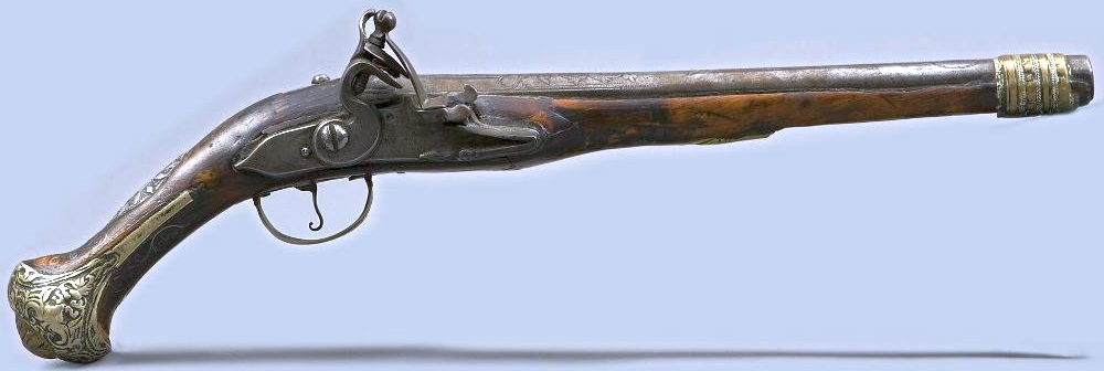

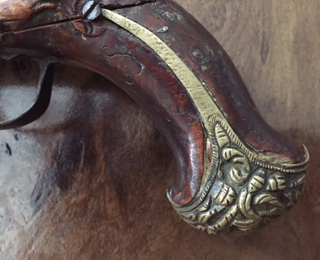

The pistol measure 20” overall
French style lock plate with some engraving, The wooden stock is carved and We can see a saber motif, the butt –piece is made from silver.Also it has ramrod- pipes with a false wooden ramrod
It is always difficult to estimate the age for those pistols my guess is that it should be from the middle of the 19TH century .
Any comment on it will be welcome.
BEST
Cerjak

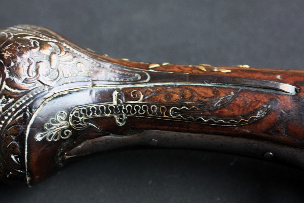

Posts: 1,065
Default more pics
more pics

Nice Ottoman pistol from the Balkans!
With a classical Zulfikar pattern

The way that the stock is carved , and the false wooden ramrod and also the barrel is typical for Balkan pistol ,see the pictures from a second pistol from my collection.
Best
CERJAK

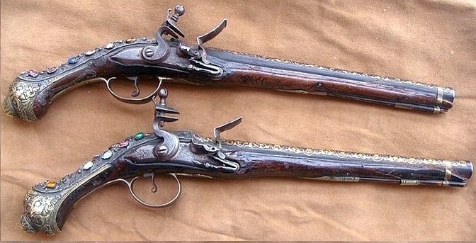

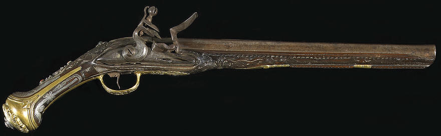

Cerjak, how do your pistols differ from typical non-Balkan Ottoman pistols? From what I have seen Ottoman and Balkan pistols generally have a false ramrod, is there some sort of noticable difference in that aspect. Is there anything else that would be noticeably different between the two types that you can point out.
Here are two pistols which I can easily associate with the Balkans.

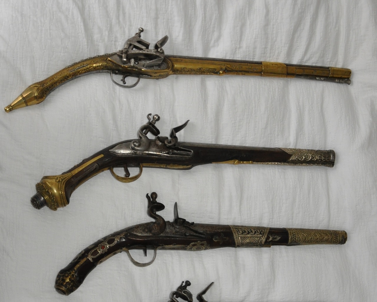

Old 2nd February 2015, 12:19 PM   #7
estcrh
estcrh's Avatar
Join Date: Jun 2012
Location: USA
Posts: 1,492

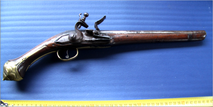

Cerjak, here are a pair of pistols which I have been told are Ottoman, with your two pistols on underneath for a comparison. Are there elements on mine which would identify them as being Balkan or non-Balkan?
The second one is Greek.
If I may I suggest two books
Elgood, Firearms of the Islamic world
Elgood, The Arms of Greece and Her Balkan Neighbors in the Ottoman Period
Our French friend is right, most these pistols are from the Balkans.
But you are right also, the limit is very thin, it's like some daggers or swords...
Anyway these weapons were produced for the Ottoman market!

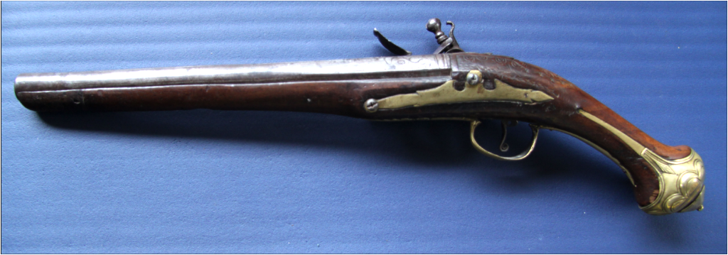

Default ONE MORE OTTOMAN PISTOL
MORE PIC

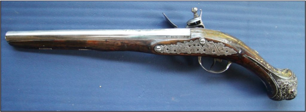

Posts: 1,492
Kuber, you may be right, but the owner (Met Museum) describes it thus>
Flintlock Pistol
Date: 18th century
Culture: Balkan, lock and barrel European (probably French)
Medium: Steel, silver, gold
Dimensions: L. 20 1/2 in. (57.1 cm); L. of barrel 13 1/2 in. (34.3 cm); L. of lock 4 5/8 in. (11.8 cm); Cal. .65 in. (16.5 mm); Wt. 2 lbs 12 oz. (1304.1 g)
Classification: Firearms-Pistols-Flintlock
Credit Line: Rogers Fund, 1958
Accession Number: 58.56
but they have been wrong before or maybe they just lump all nearby countries together as "Balkan".

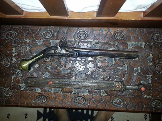

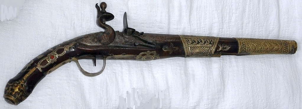

Default MY OTTOMON PISTOL
HERE IS MY TURKISH OTTOMON PISTOL AND A ALBANIAN MISQUELET RAT TAILED PISTOL,DURING OTTOMON RULE IN ALBANIA
REGARDS RAJESH

could someone roughly date my pistols which I posted,kubur could help,cheers
Old 5th February 2015, 11:56 AM   #26
Kubur
Kubur's Avatar
Posts: 2,145
Of course, they are almost like mine.
I would say 1800 - 1840 AD. (for both).
Then these guns were used up to the end of the 19th c.
Kubur

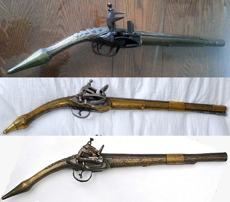

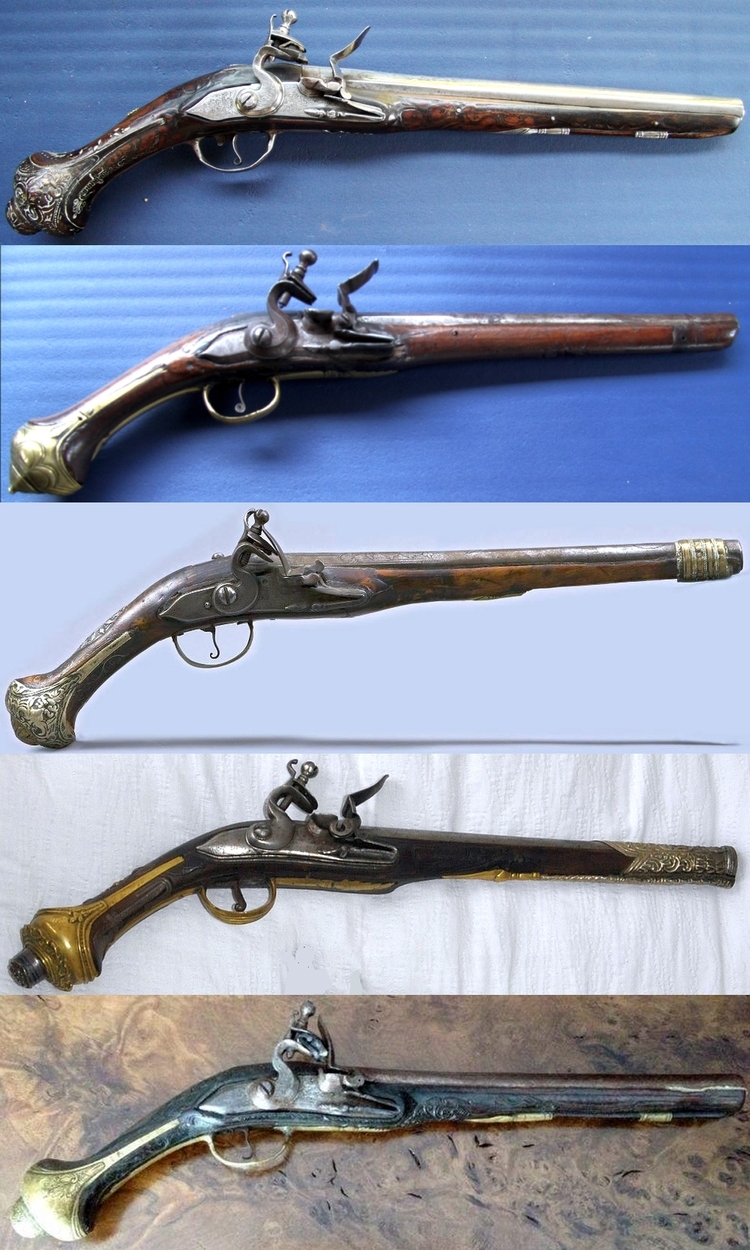

Here is a comparison of forum members Ottoman pistols, three of Cerjaks, Kubers, Bandooks and my pair. All very similar with Kubers showing the most difference in my opinion with the front of the barrel being encased in metal.

The obviously different forum members pistols, three Albanian rat tail pistols, Bandooks, Kubers and mine, and Bandooks Algerian pistol.

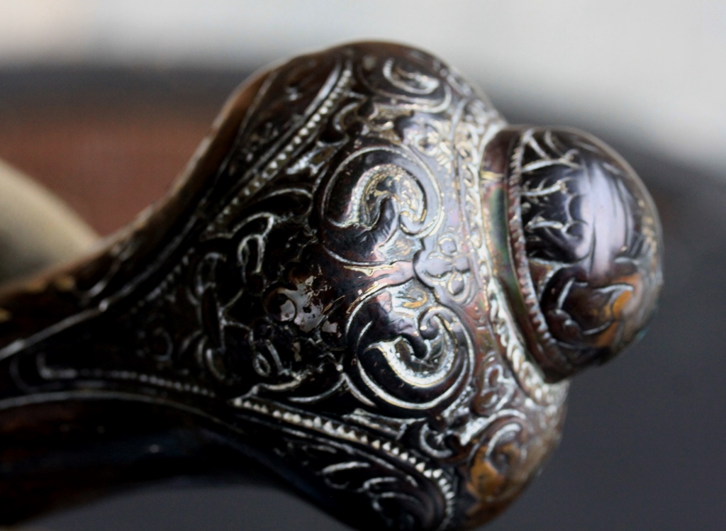

Old 19th May 2015, 01:47 AM   #30
BANDOOK
Posts: 632
Default OTTOMON\BALKAN OR GREEK
JUST GOT THIS ONE RECENTLY AND WOULD LIKE TO SHARE IT HERE,BEATIFUL DECORATIONS ON THE METAL AND WOOD,CHEERS
