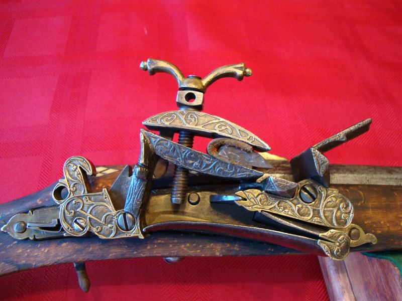

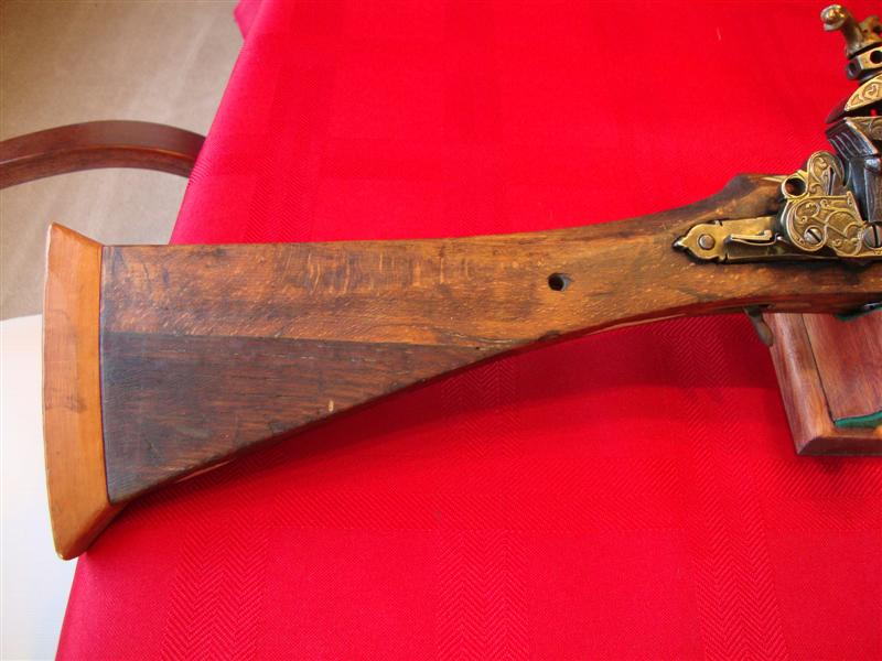

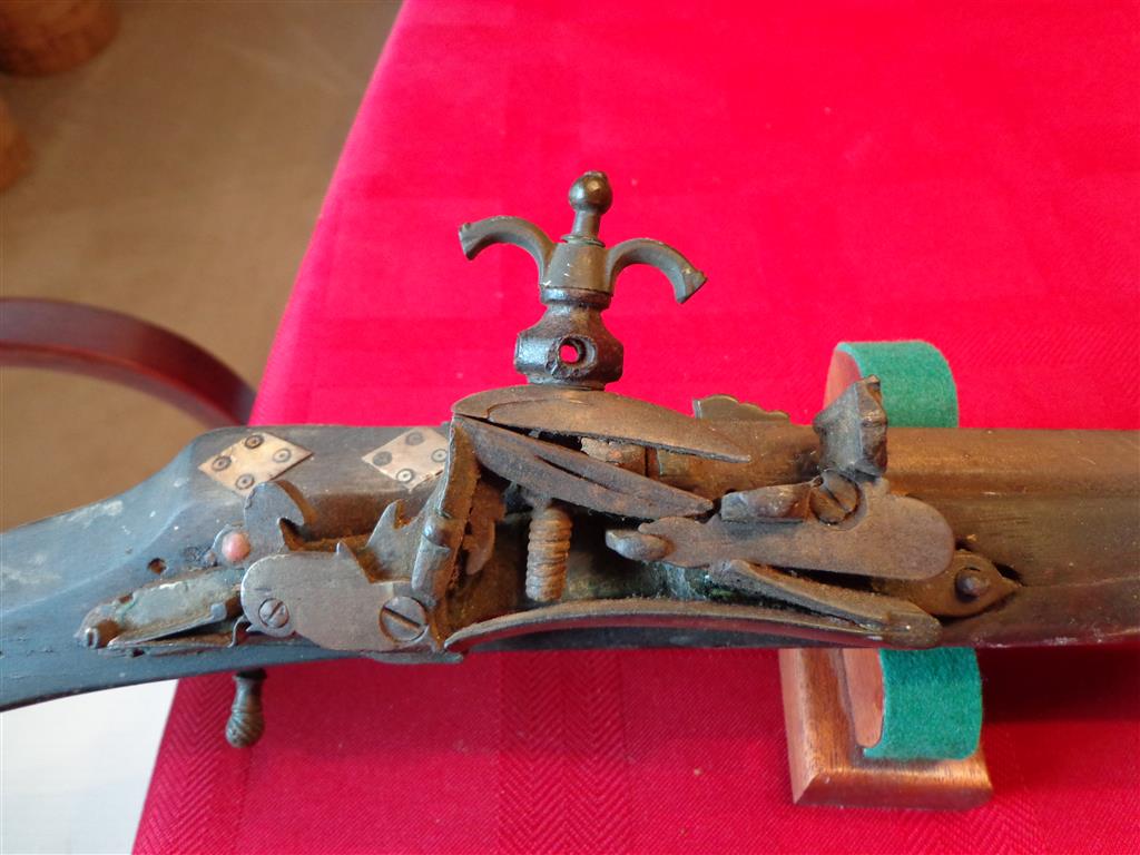

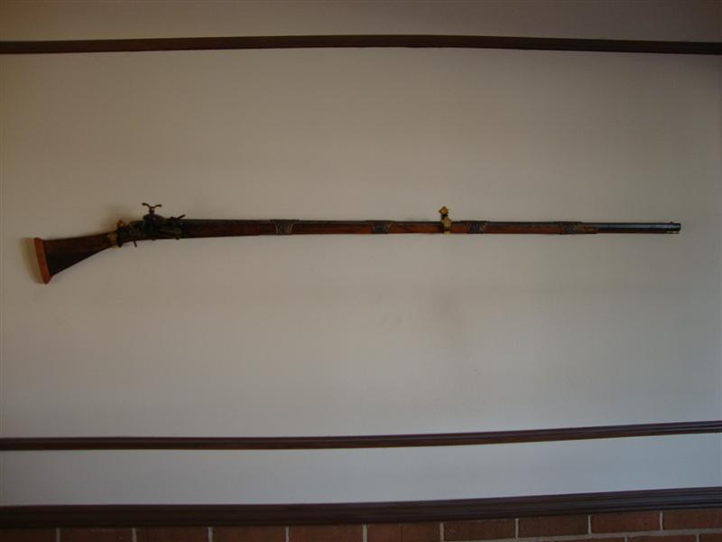

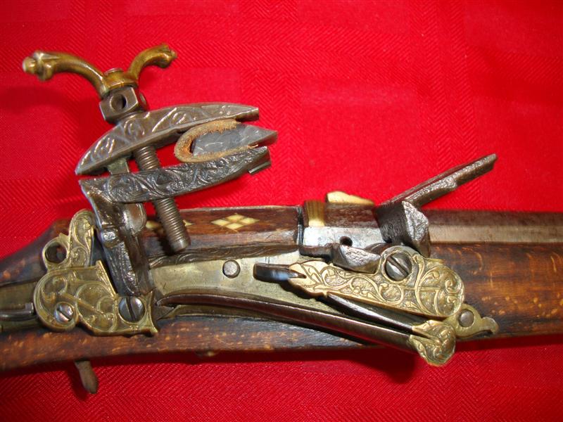

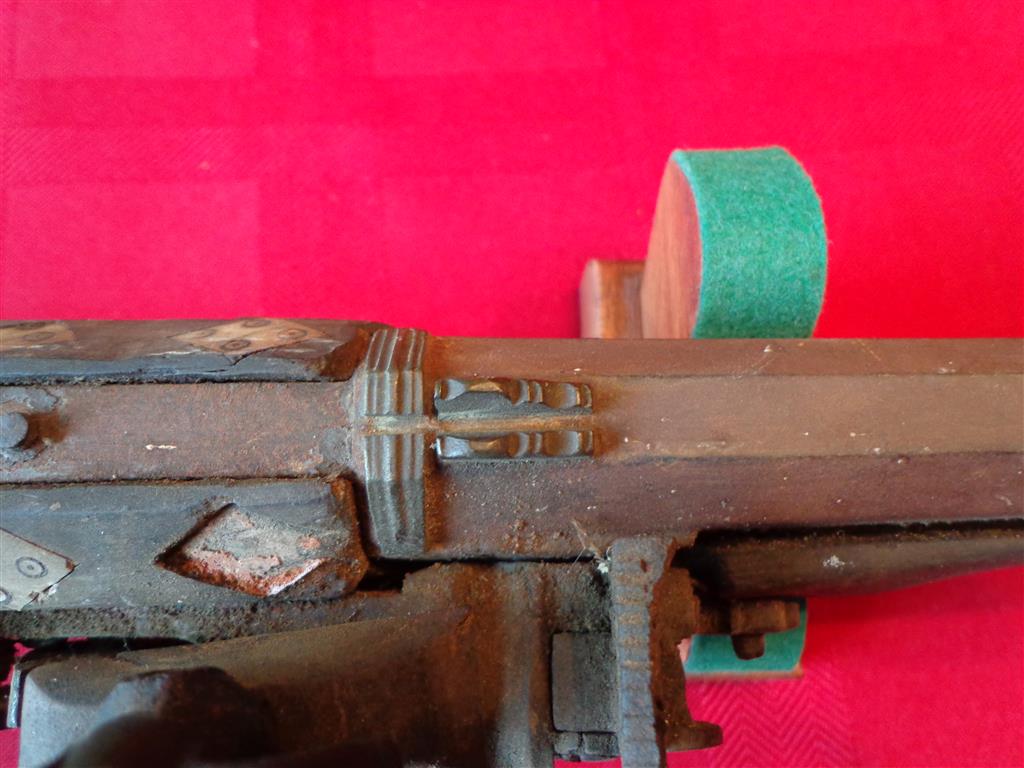

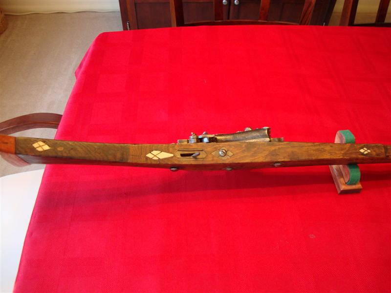

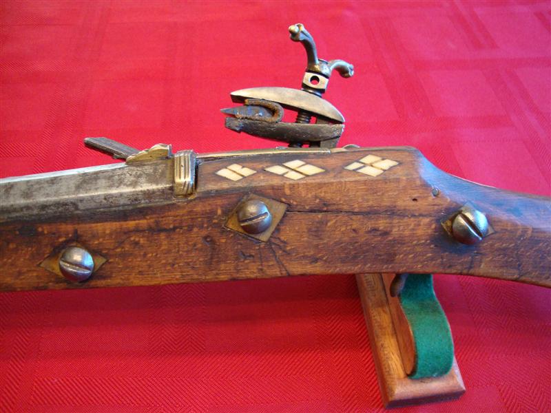

Hello again. Here is another gun some of you might find interesting.
This is a typical Algerian Kabyle long gun, with the typical large miquelet flintlock. This was a fairly plain gun that did not take a lot of work to restore to safe firing condition. Here is what was done:

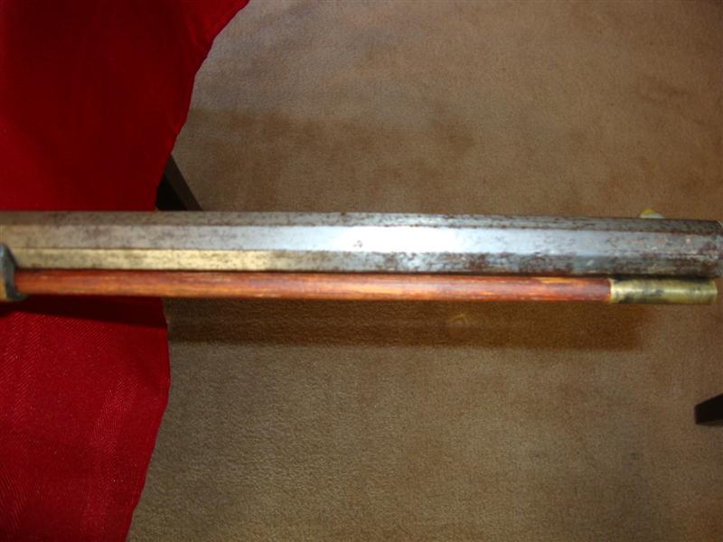

1) The lock just needed cleaned and the trigger bar bent a little to better align with the trigger pull. The lock sparks really good now.
2) The stock was in the shape shown here and really did not need any attention. I didn't even re-finish the stock. Left it as is.
3) The outside of the barrel was already in the condition as shown, with the front and rear sights intact. So the breech plug was removed and inspected along with thread condition. All seemed good. So a new steel .55 caliber barrel liner was installed.

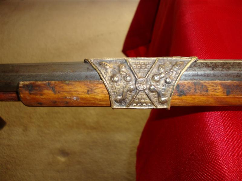

4) There was only two original barrel bands that came with the gun. And they were really beat up. So, had Armourer John Katz make 4 new ones that closely resembled the originals.
5) Original ramrod was missing. But easy to make a new one with brass tip threaded for cleaning accessories.
Gun works and shoots fine now. Hope you enjoy the pics. Rick.

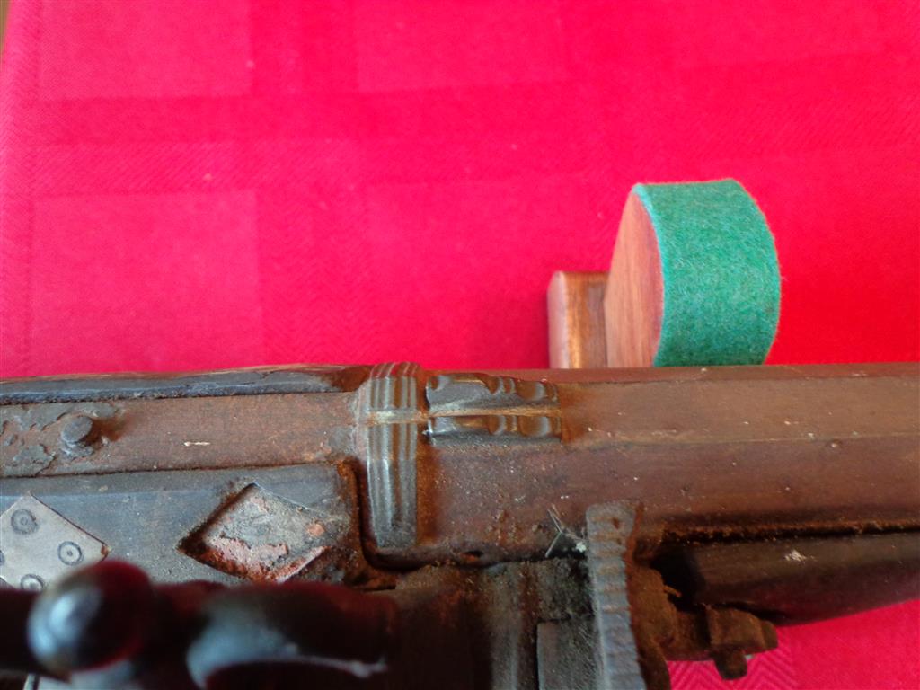

Some more pics....

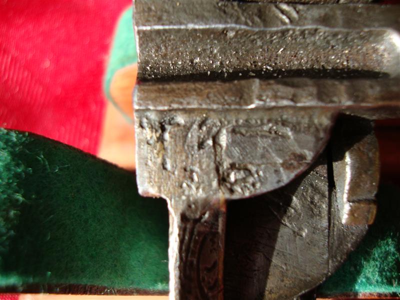

And the last.....I think.

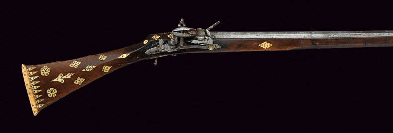

Posts: 2,145
Another picture

Thanks so much for the pic!!!! Have not seen this one before. Not only is the long gun displayed, but also the Algerian style pistol and Flyssa sword and knife. Very cool. Thanks. Rick.

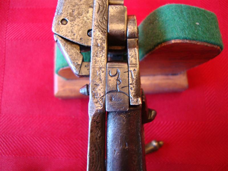

At your last but one picture...

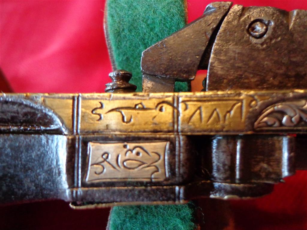

Salaams rickystl How interesting is that!! The Algerian gun mark also seen as I see it on some swords at the top of the Red Sea region... I will dig out the references in Library later... This looks like the shortened version of "God is Great" The famous Islamic mark....and of Algerian swords and guns. Searching...
Got it...
Please see http://www.vikingsword.com/vb/showth...ttara+comments
This is a clear Algerian mark (identical to the Gun Mark ) on a blade posted by Michael Blalock . I suspect that it appears on other blades as a simple cross format also on the same post above and that this marks Algerian blades and are common in Red Sea regions. This may well be one of the confusing factors linked to the conundrum of Omani Blades particularly when rehilting has occurred.
Ibrahiim al Balooshi.

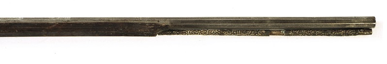

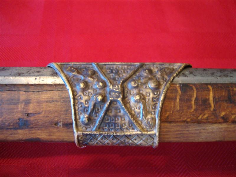

Here the barrel bands. I gave them a patina just by putting them in a plastic bag with rotten eggs. Stinky and dirty but works well...

It has always amazed me that with these wonderfully historic arms, all attention is focused on appearance, value, condition but the mere mention of markings is typically ignored. In my view, all aspects of a weapon should be equally attended.
It was interesting that your observations on that Algerian gun mark revealed striking similarities to those curious marks found on some of the blades on Red Sea swords.
Without directing too much attention to these markings on the blades, it would be interesting to know if anyone has more on those seen on this musket.
This one on the musket seems more pronounced and definable, while some of those others including the one shown by Mr. Blalock seem highly stylized, almost reminiscent of the 'twig' or similar marks from various trade blades.
Got it...
Salaams Ibrahiim.
Thank you so much for identifying this mark. I am very much a novice with markings. Yes, the mark on the blade looks the same as on the gun lock. Hmmm...Red Sea region. How interesting. I'll be able to add this information to my library page for this gun. Again, THANK YOU!!!
Rick.

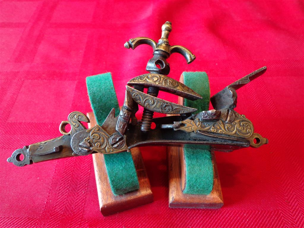

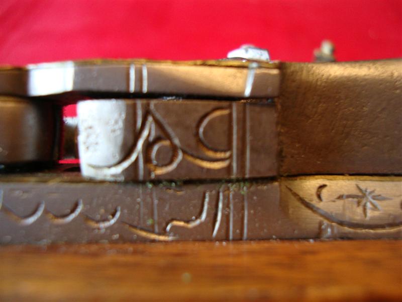

Meantime, here is a lock marking from another Algerian musket in my collection. It is a different mark, but in the same location as the first. Maybe someone can identify this one?
Thanks again for any assistance.

Well, you might be in luck. Here is an Algerian "parts" gun I have. The barrel still has both pieces of the rear sight, and the top screw still has it's "wing". I can send you both sight pieces and the complete hammer screw if you like? I'll clean them up a bit before mailing. Just let me know if you're interested.
HAMMER SCREW: I've found that these screws are interchangeable with other Algerian locks. That way you can just trade screws. If the threads don't match, you can detach the wing and tiny post and add it to your hammer screw.

Hi Kubur.
Are those barrel bands original to your gun? Or did you make/have those made for you ??
Rick.

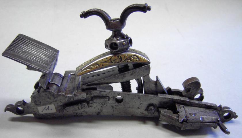

I want to add another very well and artisticly made Algerian lock of my collection which has no single mark on it.
corrado26

Hi Corrado.
That is a VERY nice Algerian lock. Very artistic and well executed. Notice the decorative file and chisel work on the mainspring. Not usually seen on these locks. Very neat. I've noticed that all these locks are built almost identical. The only differences in the amount of decoration. Thanks for posting.
I've looked at three other Algerian locks in my collection. All have a mark. But all different. I'll take photos and Post here.
Rick.

Hi Rick,
I had only one band and I asked to a guy to make four more for me.
The original is silver, the new ones are tin-plate but with the "artificial patina", i's alomost impossible to see the difference...
Kubur

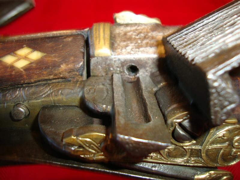

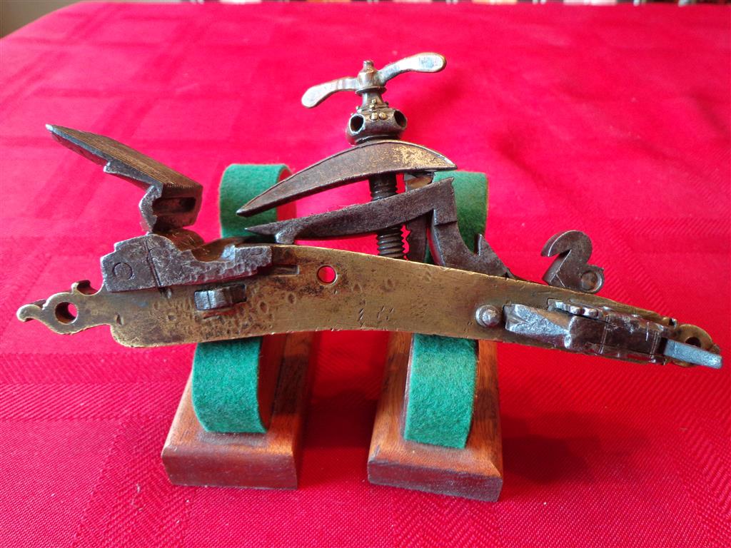

Well, I have three more locks to post here. Since I posted two above, we'll call these locks 3,4, and 5. I'll post #5 separately, since it is the most interesting.
#3 here is another "parts" lock with it's mark on the bottom.
#4 lock is complete and in good condition, but needs additional cleaning. With it's mark.

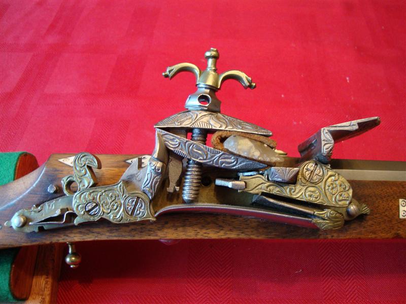

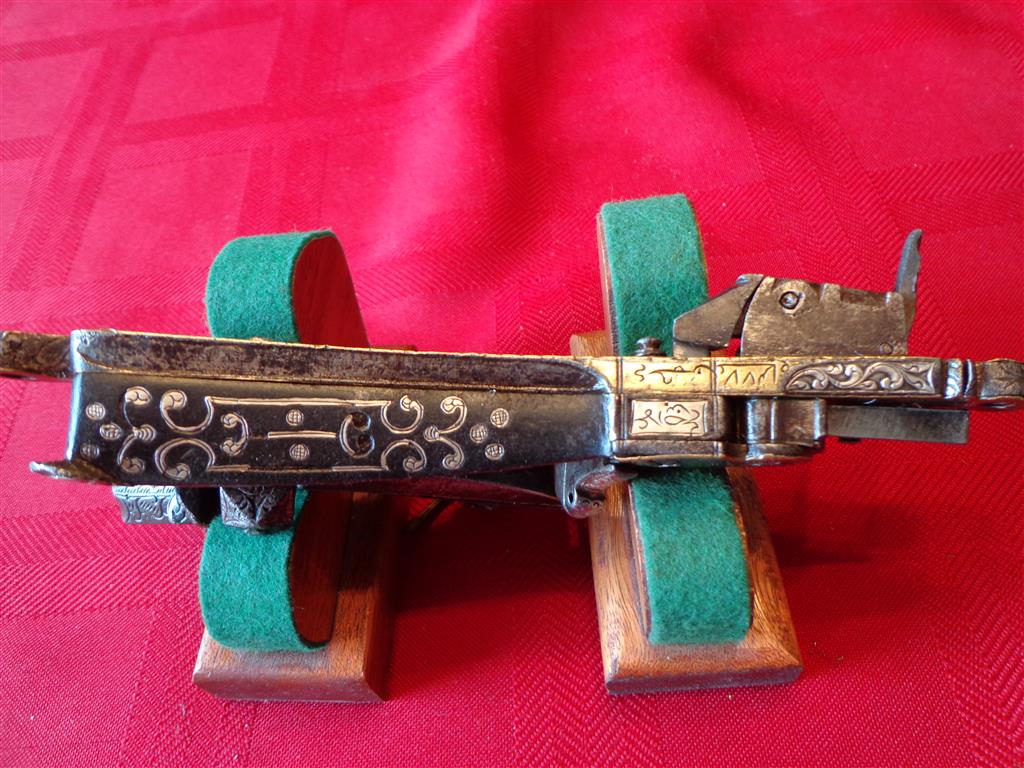

Here is lock #5. At one time this had to be a beautiful lock. It is a bit larger than others that I've seen. It's complete,with the exception of the crude copper replacement wing. The lock plate has brass overlay on BOTH sides of the plate. It has some brass, but mostly silver inlay/overlay throughout. Even the bottom of the mainspring has genuine silver inlay, most of which is still present. The dog safety catch at the rear has what's left of a "pink" stone, so famous with Algerian guns.
There are three marks on the bottom of the lock. Two engraved in brass plates, the other in a silver plate. Only lock I've ever seen marked this way. Maybe someone can translate? Thanks for looking. Rick.

And the rest for lock #5. Very cool markings!!!

Hi Rick, thanks a lot for posting these interesting fotos, especially the underside of the mainspring with its silver inlay and the brass cover at the inside is most remarkable. This shows the pleasure of the gunsmith while making this lock and demonstrating his skillfullness. Very impressive. I like these locks very much, much more than the long guns they are belonging to
corrado26

Hi Corado.
Yes, notice the silver is genuine inlay, not just painted on. Only one I've ever seen with the mainspring like this. And the marks/signatures (3) on the bottom are especially interesting being done with inlays. Hope someone can translate them? Just wish this lock was in the condition of yours. LOL.
Thanks again for your comments. And, again, your lock is the only one I've seen with the fancy chisel and file work on the mainspring.
