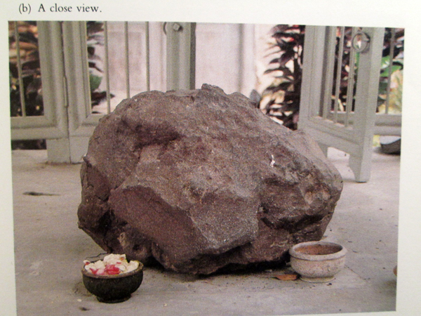

Seerp, there are 2 photographs of the meteorite in Edward Frey's book (The Kris, Third Edition), one showing the entire shrine and another more close up. Just after page 54. I can't be sure from the photo, but i would estimate that the remaining piece is perhaps nearly 2 ft. high by nearly 3 ft. across.
This book was first published in the mid-1980s, but i am not aware that pieces of this meteorite were still being used so i would imaging that the size of the piece hasn't changed much since this photo was taken.

Seerp, there are 2 photographs of the meteorite in Edward Frey's book (The Kris, Third Edition), one showing the entire shrine and another more close up..
These pictures are from Edward Frey's book The Kris, second Edition,
(which are the same, I guess?)

Yes Sirek, those are the same photos as in the 3rd edition.

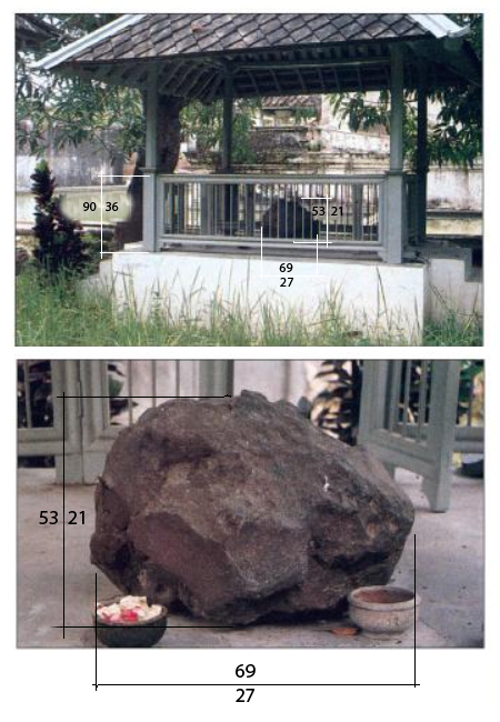

Sirek, thanks for the photographs.
I have put some (estimated) dimensions on them.
Left from the lines the dimensions in cm. At the right side inches.
A rough calculation, from this dimensions, estimates the weight of the meteorite remnant to be approx. 1000 kgs.
I am very interested in the true dimensions as well as the surface where parts were chiseled off?. Probably the backside of the meteorite.
When anybody visits the keraton........
