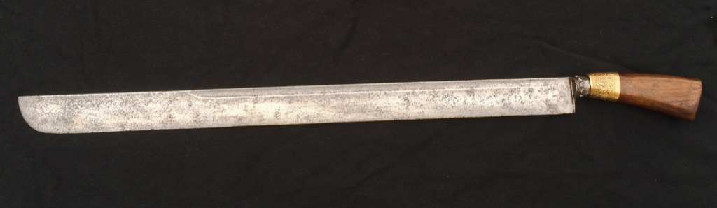

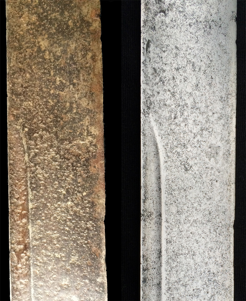

After many days of work, I'd like to share the results of removing the rust from a Sikin that I acquired some time ago. I am attaching two pictures. One of the sword as it is today. The other is a "before" and "after" composite picture that shows a portion of the middle of the blade and fuller. I tried to line up the features and size in each of the pictures. Both are in color with outdoor diffuse light.
l'll admit that my treatment of the blade was aggressive and some material was lost. However, the condition of the blade was so bad that I could hardly look at it.
I used chemicals (dilute phosphoric acid), mechanical methods including a Dremel tool with a variety of 400 grit diamond tool ends and abrasive finishing attachments, and hand sanding with 320 grit and 400 grit paper, finishing with 5 micron down to 2 micron paper. A little light oil and that's it.
Dave A.

In fact, it was this sword that inspired me to post that list.
- slight stains on blade
- light rust spots
- some minor pitting
This was more or less the description provided ... And no close-up photos. As you can see from the before photo, this blade had active and deep rust as well as hard, carbonized rust deposits. This blade might have become a pile of rust dust in a year or two.I didn't really know if it was salvageable in some form. However, it represented was a good chance to practice various techniques and procedures. Finesse, and knowing when to stop are key.
