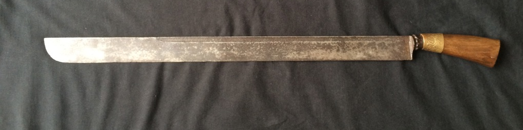

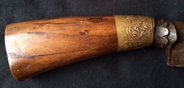

I recently acquired a sword whose blade is consistent with a sikin identification. However, the hilt does not match the strong implication in VZ's book that a sikin hilt is invariably forked. Nor does this hilt match what I know of the "horse-hoof" type hilts that are sometimes found on other swords from Sumatra, but I readily admit my limited expertise on that subject and this leads me to the query in this post.
See photo attached. The hilt is 4 1/2 inches long and about 1 1/2 inches high with an oval cross section, slightly flattened on the sides and increasing in size towards the down turned pommel as you can see in the photo. The pommel itself is nearly flat, with no decoration.
Any ideas what kind of hilt this is? Is it reasonable to think it could be found on a sikin?
I promise to post pictures of the whole sword once I remove a bit more rust and get it cleaned up.
Best Regards,
Dave A.

One potential explanation for the discrepancy is that the handle is a later replacement.
Old 29th March 2015, 12:49 PM   #3
CharlesS
CharlesS's Avatar
Location: Greenville, NC
Posts: 1,854
I agree with Ariel. The whole thing is much later to the blade, including the bolster, or ferrule.

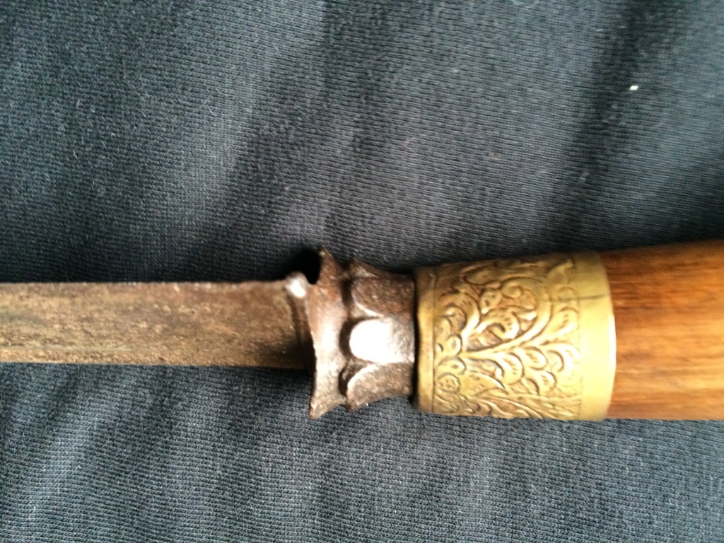

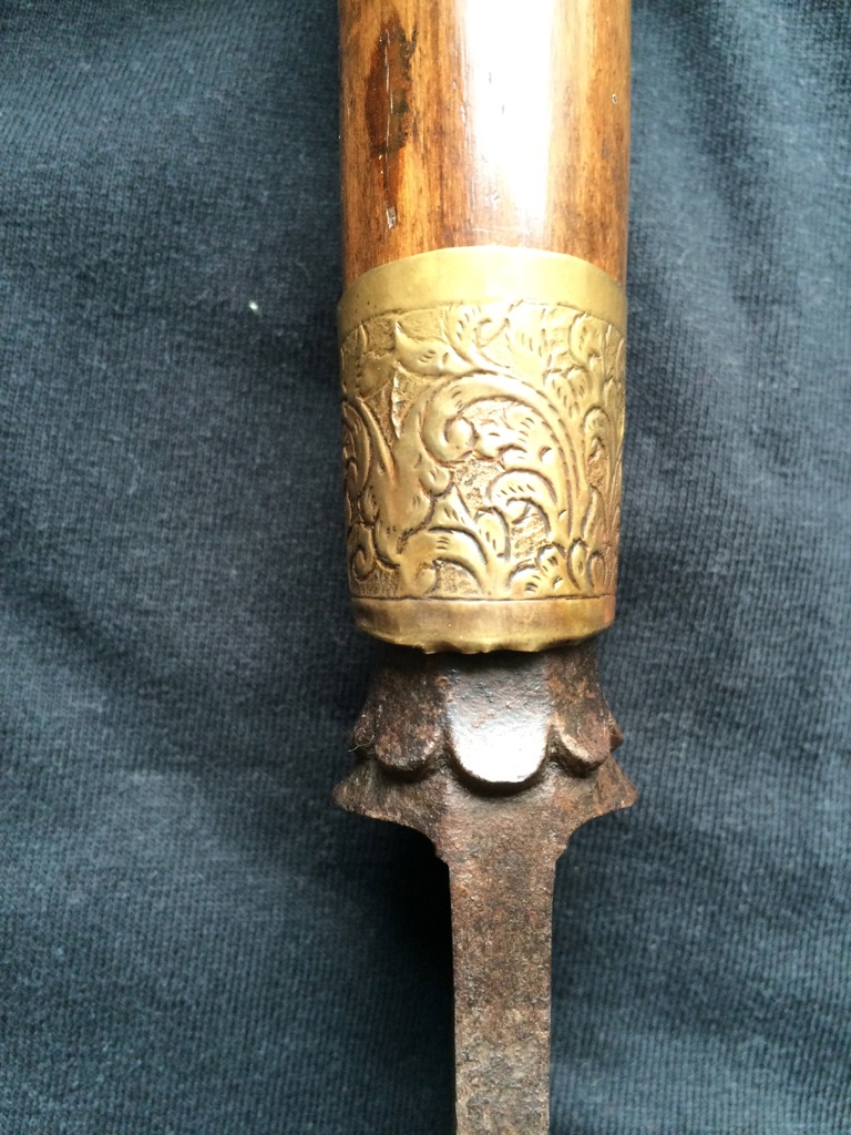

Posts: 2,238
Yes, a later replacement.
The floral decoration on the ferrule is not Atjeh, nor is the hilt.
It looks also oversized. a picture of the complete weapon will give a better view on the size.
Willem
Old 29th March 2015, 09:07 PM   #5
Agree with the others, it's a replacement hilt. When the blade is good I would look for a matching hilt.

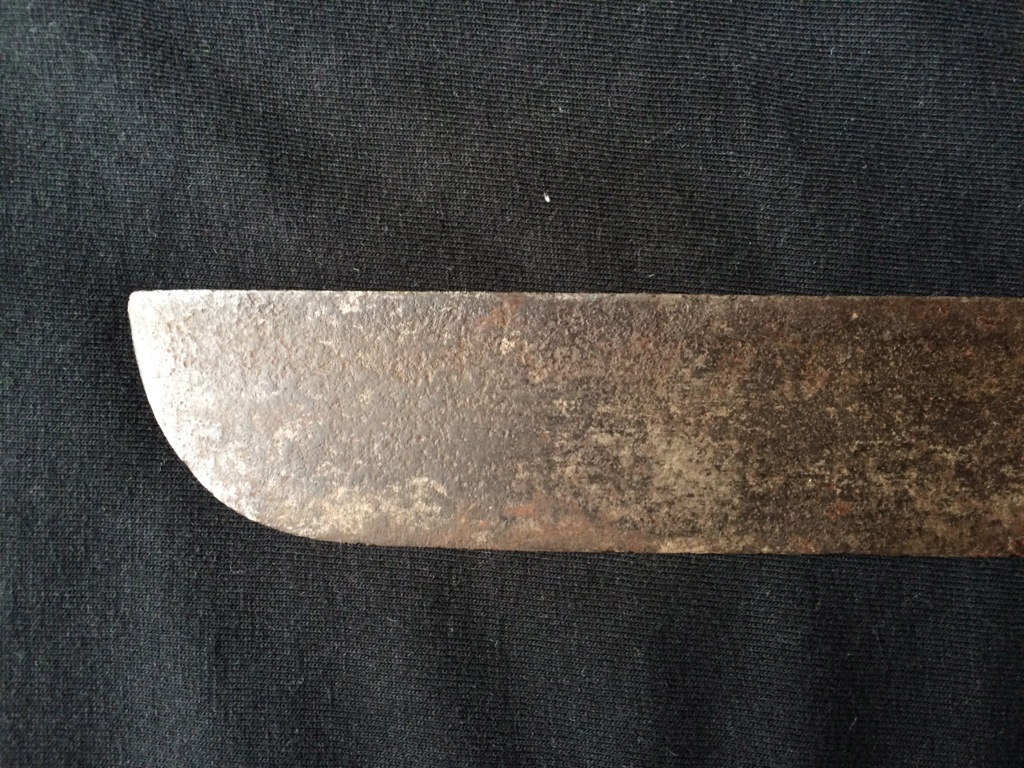

Thank you all for your comments.
Here are a few more pictures. This is the weapon as received, before cleaning.
The overall length is 27 inches. The blade is 22 inches long measured along the spine. The blade width is 1 ½ inches. In the final 1 ¼ inch of the blade, the edge curves up in a quarter circle radius to the tip. The blade features a single wide fuller on both sides in the first 15 inches from the forte along the top edge. The blade is ⅜ inch thick at forte, tapering distally to point. The hilt is 4 ½ inches long and made of hardwood. Hilt is oval cross-section, increasing in size and turning slowly downward to pommel. It somewhat resembles the kind of hilt you might find on a sewar, but not a sikin.

In my opinion definitely recent replacements.
