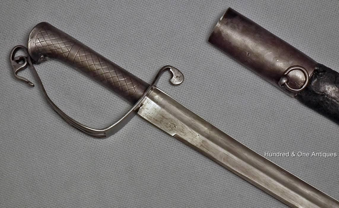

Default UNIDENTIFIED INDO PERSIAN OR ARAB SWORD FOR COMMENT
Measures: 99 cm long (out of sheath).
NOT SURE IFS ITS MIDDLE EASTERN OR INDO PERSIAN SWORD,PLS CHECK THE MARKINGS ON THE SWORD
REGARDS RAJESH
Old 14th April 2015, 02:29 PM   #2
Kubur
Kubur's Avatar
Posts: 2,145
Hi Rajesh,

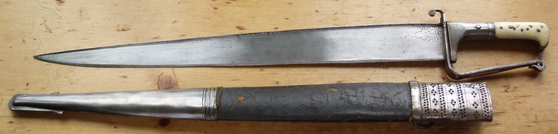

Your guard is very similar to some military khyber knifes.
Look this old thread
http://www.vikingsword.com/ubb/Forum1/HTML/001976.html
The blade looks also very Indian.
So for me, your sword is Afghan / Pakistani.
All the best,
Kubur
Old 14th April 2015, 02:37 PM   #3
Definitely not Pakistani: only after August 14, 1948:-)
One of the late 19-20 century Afghani military sabers, with British influence.
Also: please note the handle that is definitely not of a usual "khyber" form, but rather an imitation of the Russian regulation shashka pattern 1881.
Conceptually a schizophrenic "dog's breakfast" example, but unquestionably 100% genuine.
The ultimate reflection of the Great Game.

THANKS KUBUR AND THANKS ARIEL,GOOD INPUTS

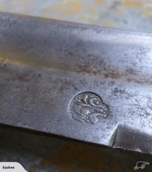

Salaams, The stamp looks Turkish? ....Ottoman.
Ibrahiim al Balooshi
Bandook you have PM...

THANKS IBRAHIIM,CHEERS

The Afghan army imported massive amounts of Turkish weaponry many decades ago. That's why there so many Afghan marked WW1 German bayonets etc.turn up there.
But without a translation of the stamp, its hard to say which language using Arabic script is stamped on that blade.

An Afghani military sword with whole metal hilt and a Khyber blade - one may find weirdest combinations in this part of the world!

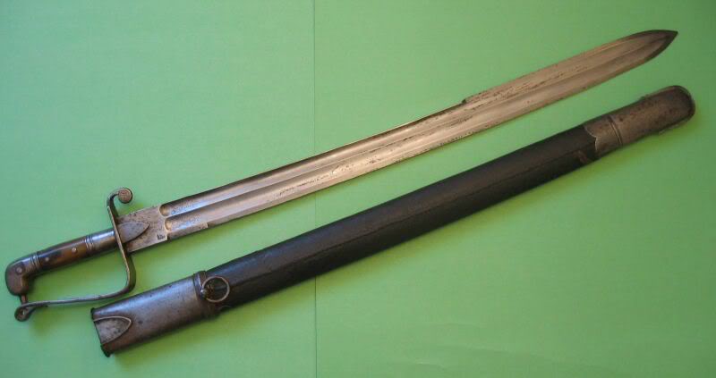

Yup, my example.

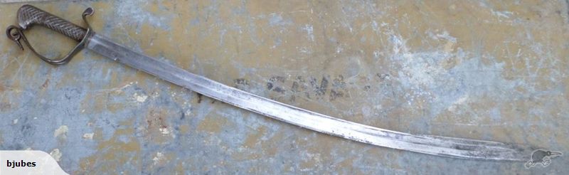

This is a most interesting example of variations of 'Anglo-Afghan' type arms which evolved in Afghan armies after the 2nd Anglo-Afghan war (Treaty of Gandamak, 30 May, 1879). While the Afghans had been developing a degree of 'westernization' in their armies with British subsidy much earlier, the Russians in the beginnings of the 'Great Game' were also trying to effect diplomatic relations there.
With this confluence, numbers of arms from these countries began coming in, and this influx of course continued well into the 20th century (obviously these conditions prevail into present times).
Amir Abdur Rahman Khan after the 1879 treaty became the de facto ruler under British suzerains, and with their subsidies continued industrial advance, in 1887 establishing the Mashin Khana arsenal in Kabul. Under British advisors the production of arms took place here, mostly with firearms but certainly including edged weapons in degree.
Most commonly seen are the Afghan swords sometimes termed 'regulation' types for the Afghan army, most of which seem to have been produced in the 1890s. These have characteristic pierced sheet steel knuckleguards with parallel openings (resembling typical guards on a number of European forms and British). At the top are also the complex 'swans neck' terminals next to the pommel. (see attached)
In the case of the posted example here, the pommel has an interesting cleft feature, which I would attribute to the forementioned Russian influences. It is worthy of note that a number of shashka like swords are present in Afghan context.
This blade is of a form known as 'quill point' well established in Germany early 19th c and often present on British cavalry sabres. It continued in German use well through the 19th c.
In 1893, Germany covertly sent representatives into Afghanistan to expand the arms factories. As the multi channeled heavy blades on the Afghan 'regulation' type swords seem quite German in quality, it begs the question , perhaps these quill point blades were produced for Afghan use as well?
I would say this is an Afghan military sabre of latter 19th century . It does not seem to have been produced in Mashin Khana as the notable mark is not present.

Years ago when I had a couple of these to hand, I discussed them with Robert Wilkinson -Latham because the steel & grinding was unlike anything Ive seen on any other Afghan weapon.
He & the German experts he then consulted were of the opinion they were clearly Solingen made.
The Afghan temple marks on some blades are just ownership or inspection marks As there are also many English made Lee Enfield bayonets that carry the same hot stamp...{As well as the Afghan made ones..}
These marks were used by the regime, and primarily applied at the Mashin Khana, as described in the article on this establishment in Man at Arms (2009). This factory was in operation producing many of the Enfield rifles and accompanying bayonets in the 1880s in their assembly, with some components brought in under British supervision Mr. Wikinson-Latham would of course be well versed in these circumstances, and it seems he indicated to me at one point that many of the bayonets had been produced en masse in Solingen for makers in England to meet voluminous quotas.
